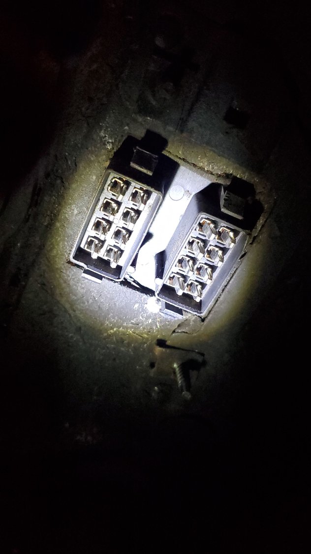

Replaced all the wiring harnesses several years ago. Never had any issues. Bulkhead connectors look clean per photos. Out of frustration I turn the key on and off several times in an attempt to hear any clicking noises. That when I observed some smoke coming from the horn relay and under the ignition shielding. Will be taking off the ignition shielding next.

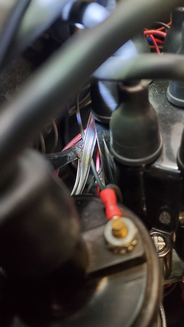

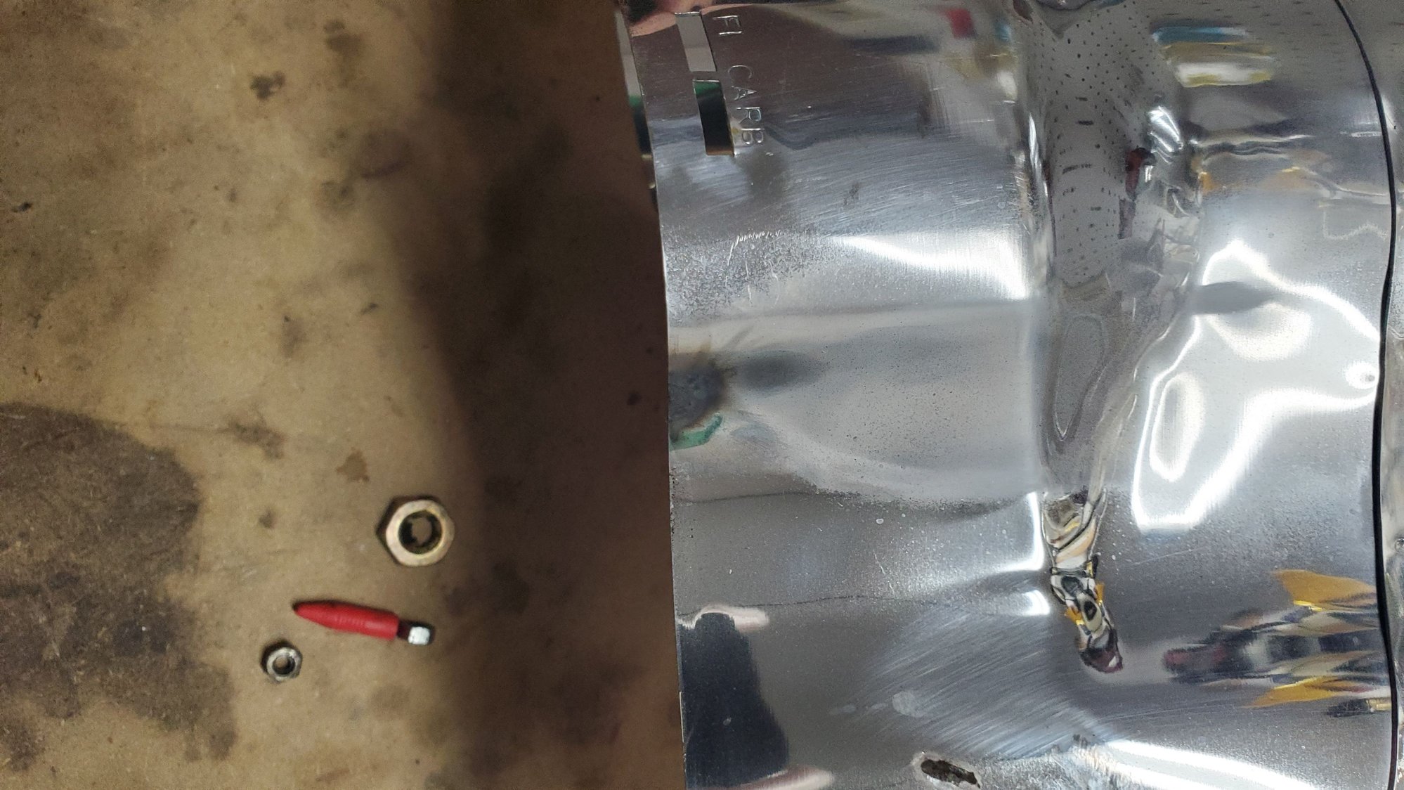

Burnt mark on back of shielding
As you can see from the pictures, the back of the distributor/coil shielding has a burn mark. The sharp edge of the shielding cut the wiring harness. You can see the plastic edge guard I used to try and prevent this from happening. What I didn't do was glue it onto the shielding.
It was such a tight fit, I thought it would not come off. Obviously I was wrong. Appreciate all of the responses

That's not good. Hope the ignition coil didn't short out on the shielding. The + and - poles should be positioned parallel to the firewall. My distributor ignition shield is stored safely away in a cabinet for just this reason. Check the pink wires at the coil to be sure they're not damaged. Fingers crossed
