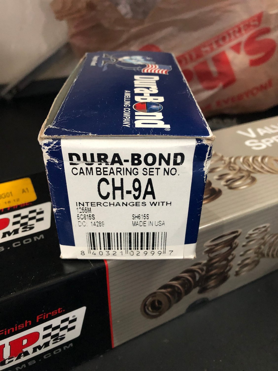

And don't forget the cam bearing set that has that special rear bearing.
Here's a pic of the Durabond CH-9A set I'll be using.
And, as you already heard...you do need to find another machine shop.
Mike T - Prescott AZ

Thanks Mike for the bearing info. I have used this shopped and many of my friends to build other engines for us
and never an issue. He builds many race motors and he just shrugs his shoulders when I talk original stuff, says he doesn't use stock stuff to build race motors.
Ric

Race motor or not all 66-66 BB need the grove and special bearing. Or it will need rebuilt again

...and make danged sure the machine shop puts that rear cam bearing in right. It only goes in one way, correctly. There are 3 oil holes and they're spaced at 135 degrees from the bottom hole to one of the upper holes, then 90 degrees to the other upper hole and then 135 degrees again back to the bottom. My machine shop managed to mess that up about 20 years ago. Roasted a whole bank of rocker arms and pushrods. That was an expensive warranty job for them.
