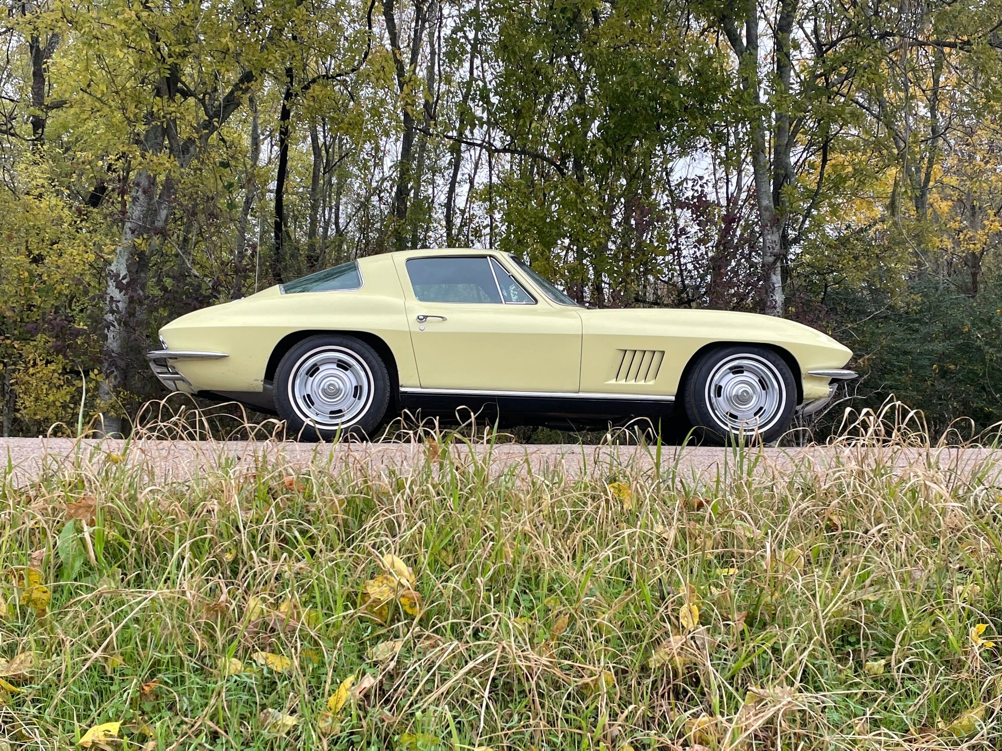

I just recently purchased this 1967 Corvette project. Can someone assist with the Protecto Plate Decoding? I appreciate any help!

T0327JEH is Tonawanda March 27 427/435 with a Holley carb
P7D07 is a Muncie 67 March 7th
194377S116998 is a Approximate birthday April 25, 1967
FA0413W is a 427 rear with a 3:70 posi assembled on April 13
so you hit the jackpot

do you have any more pictures of it?

Awesome looking car. Does it still have the 427/435 under the hood.
