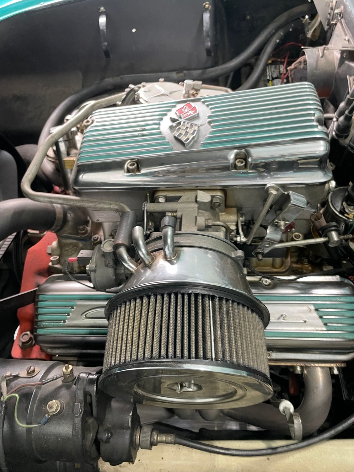

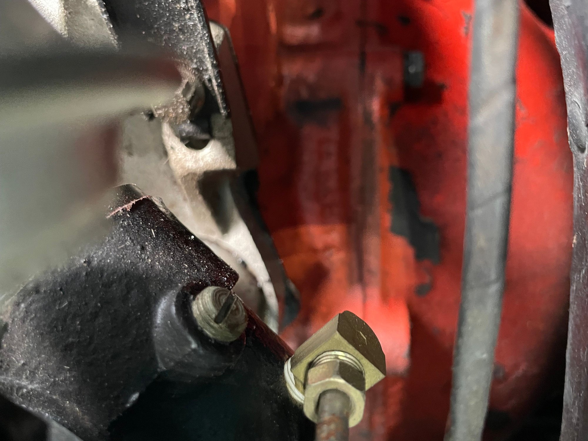

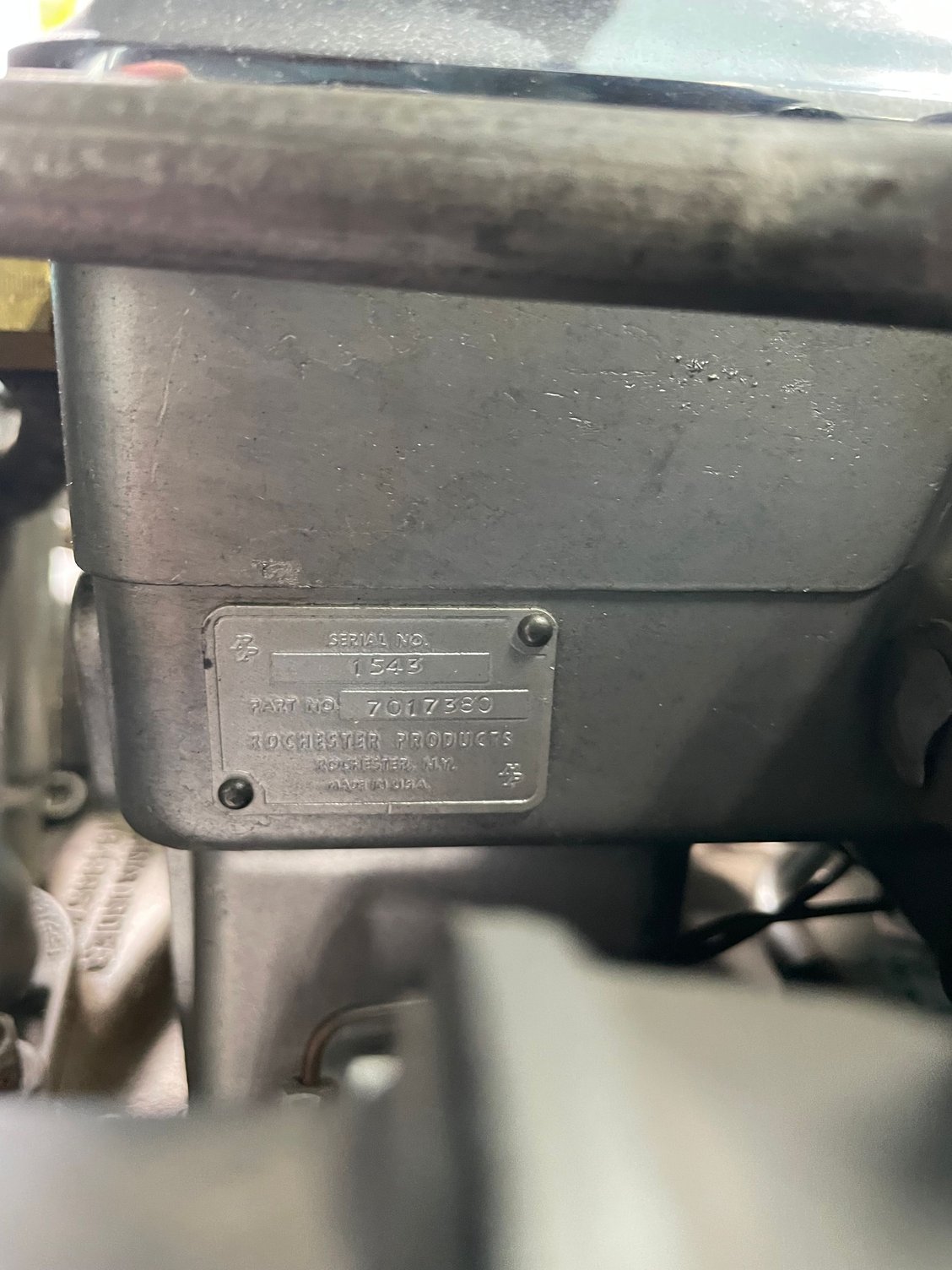

Here are some pics and what I think is the engine stamp tho really hard to read.

Everything checks out. You've got a 7380 unit, correct for most of '64 and all of '65.

All you know for sure is that you have a 7380 FI unit. Having it sez nothing about the engine under it. It could be anything.

Have you checked to see if there is a VIN stamped on the plenum? It would be on the passenger side under the vacuum port OR it COULD be stamped into the front of the plenum. That's an early unit so it may have not been stamped.

Definitely an interesting set up... 64/65 380 FI, but electric choke, and I don't recognize the air meter adaptor? 61-62?

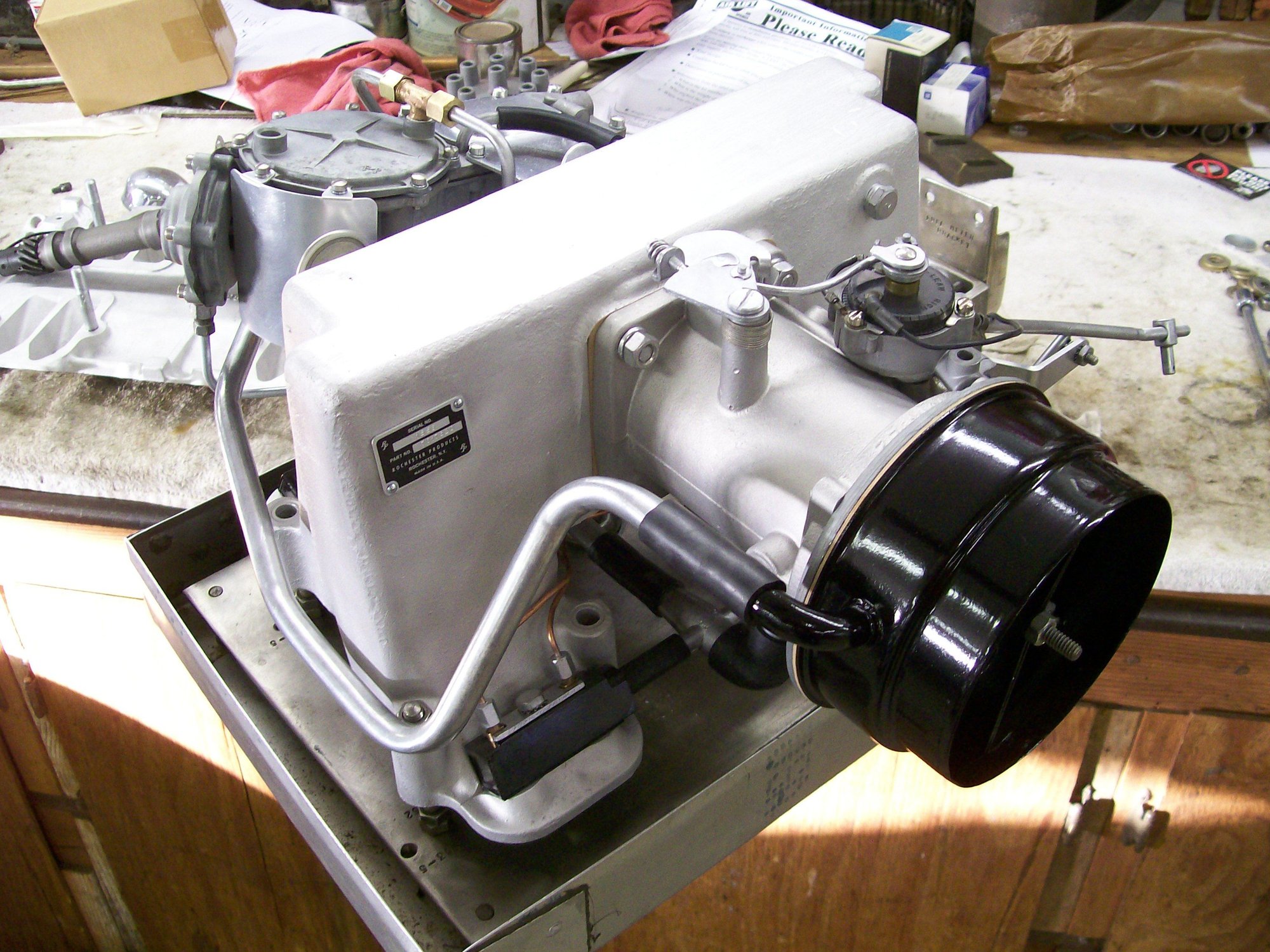

The air meter adapter (actually, the whole air cleaner) is 57 FI only.
This is what 58-62 air meter adapters look like.
