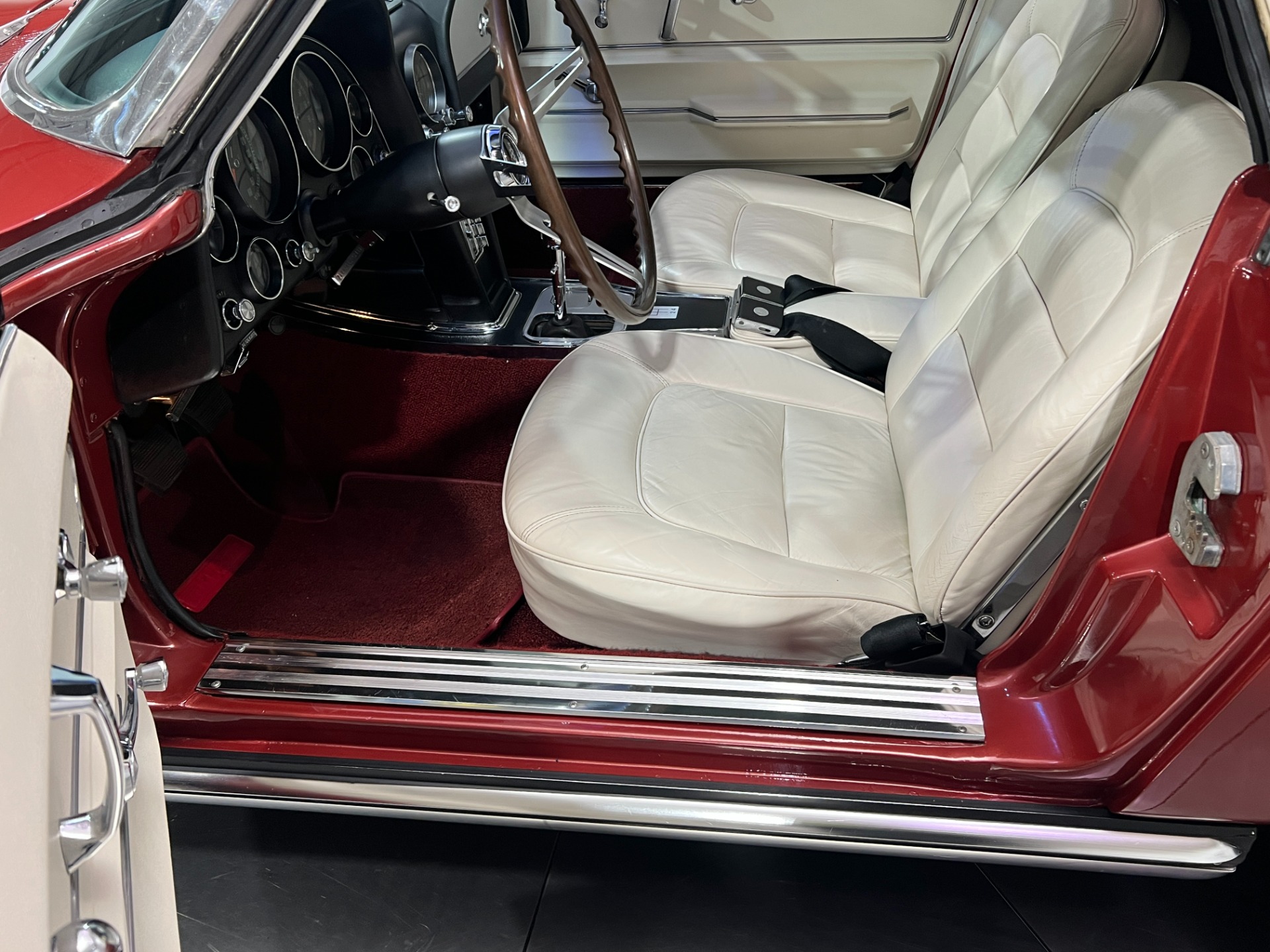

with that picture Leif the center arm rest is white along with the trim behind the door

On my 65 convertible, it was Nassau blue with white interior. As mentioned, the seat covers, door panels, console and seat backs were all white, as well as the sun visors. My top did have blue headliner, however.

your headliner and all of your trim should also be white. The consul would not be painted white. The armrest between the seats would be white. The console would be blue along with your carpets and your dash pads.

My error - console was not white, only armrest. Headliner was indeed blue, but I had no history of previous ownership, so it very well might have been a replacement.
