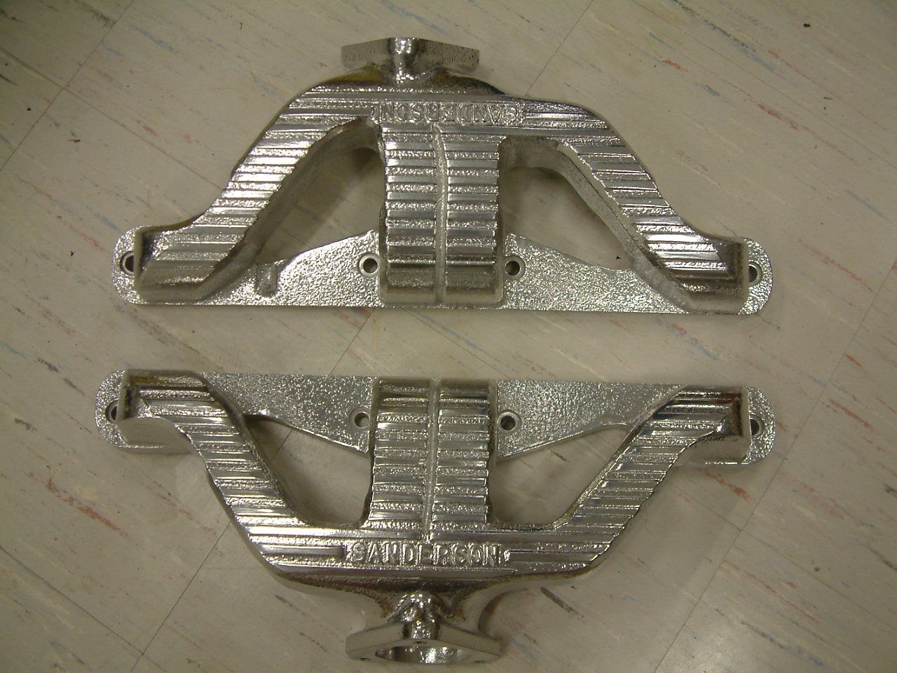

I have a set of repop rams horns ordered to see how they fit and flow .
Old Jan 25, 2024 | 05:24 PM
Skip Fix's Avatar
Skip Fix
Joined: Dec 2023
Posts: 648
Likes: 195
From: Katy,TX

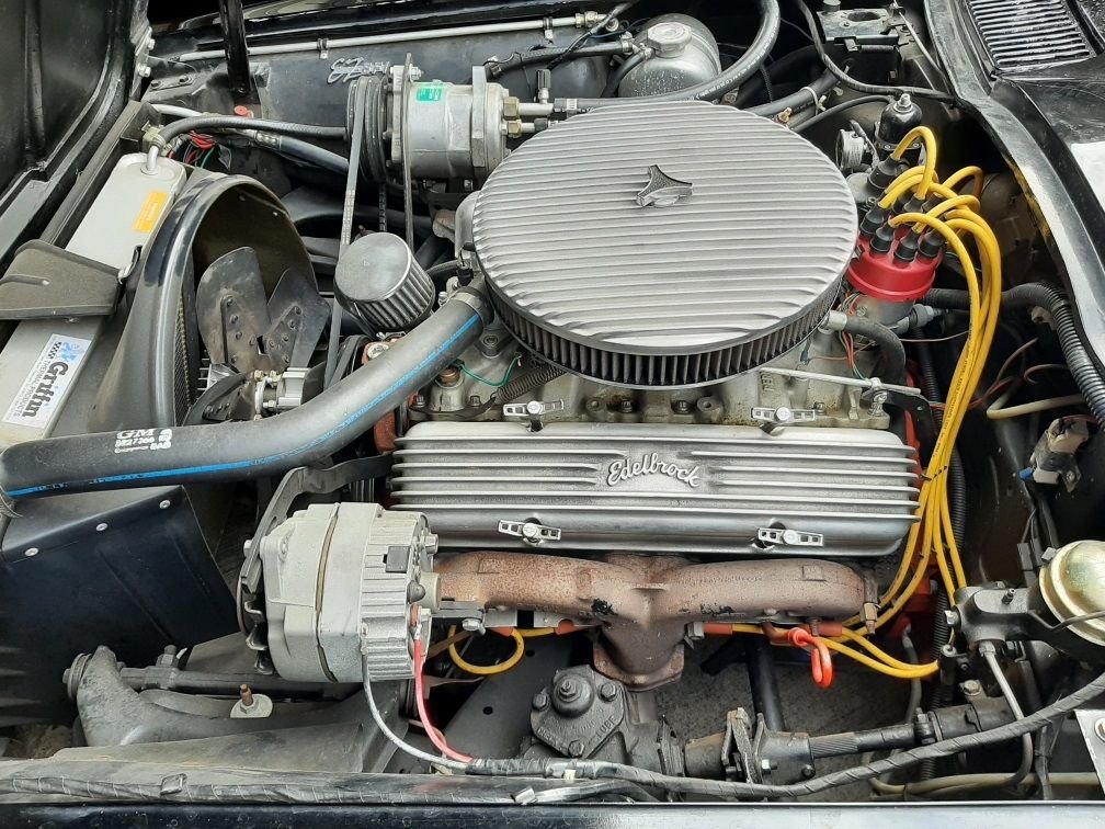

Repops came and look awfully restrictive. Might not be any worse than factory ones. For a 383 might have to hunt up some header brackets for them.
Here is what it currently looks like.
