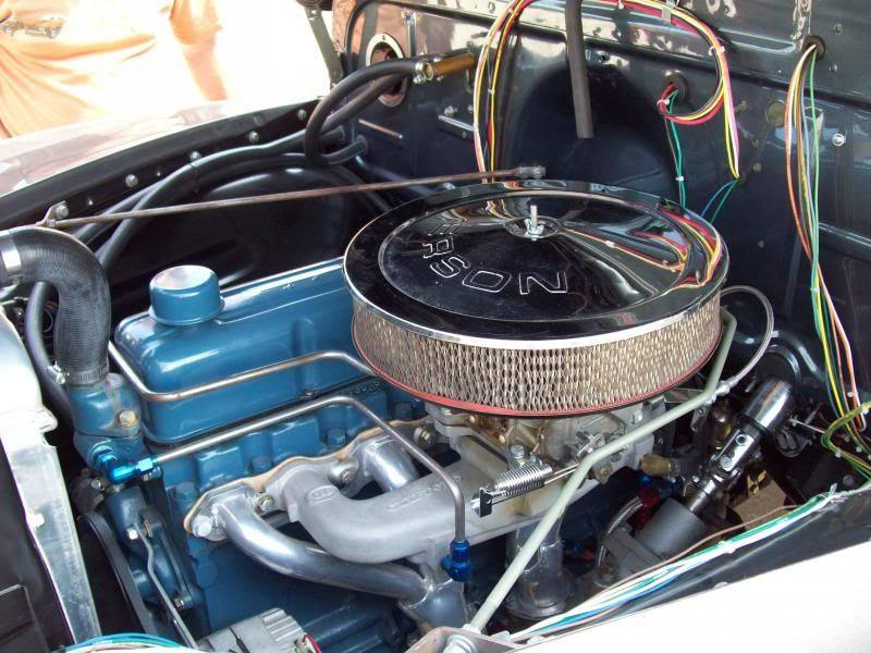

SOOOOOOOOOO, if it were my car------------AND IT IS NOT---------------I would round up a rebuildable 261 truck engine (55-62), which is the same block/head design, bore and stroke it to 283 and find an OLD transmission shop with an old timer that is familiar with rebuilding and upgrading the early cast iron Powerglide transmissions.
With all the 6cyl hardware, a 261 can be assembled to look exactly like a Corvette 235 with 3 carbs and dual exhaust.

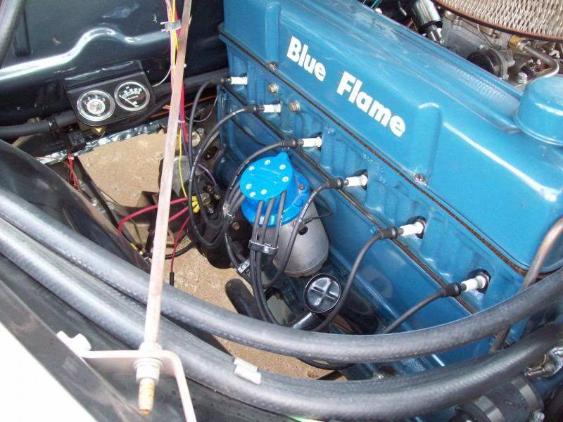

These are the only pictures I have of a 54 Corvette engine. A 261 can look just like this.

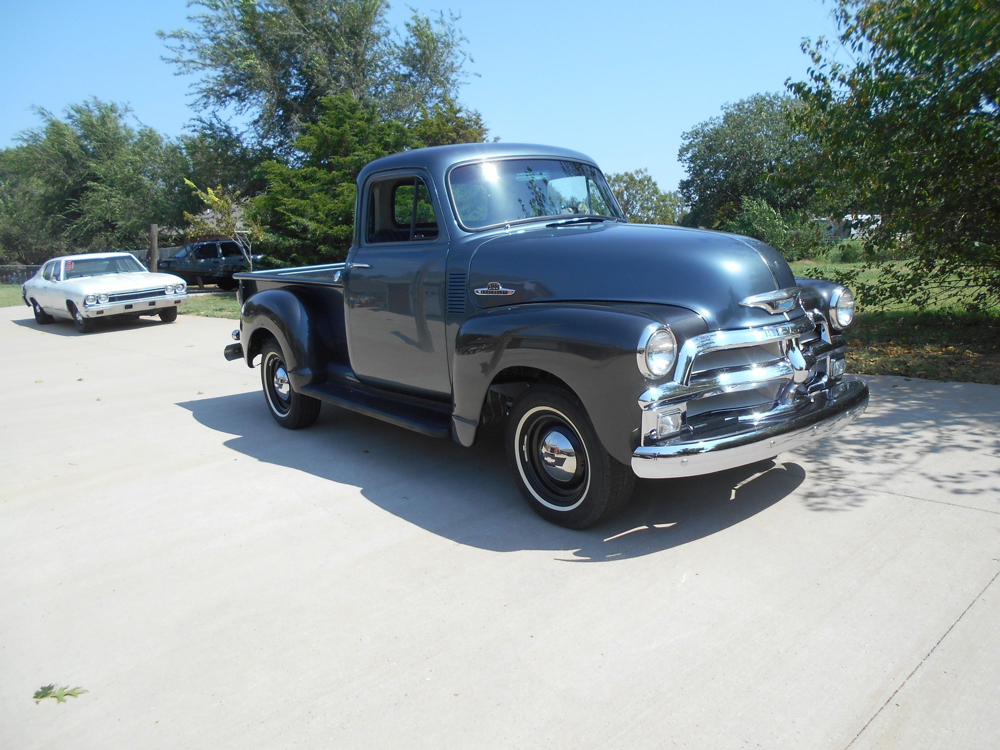

I have a very close cousin that has a First series 55 pickup with a 283 bored/stroked 261. Other than the 4bl and Fenton dual exhaust, it looks right at home. The bell housing is a truck housing with a bolt pattern for a later 3-4sp tranny. The transmission is a Saginaw 4sp and the rear is a 64 Chevy 3.08 posi.
The appearance of a stock 55 was retained, but it drives great in town and on the Interstate.

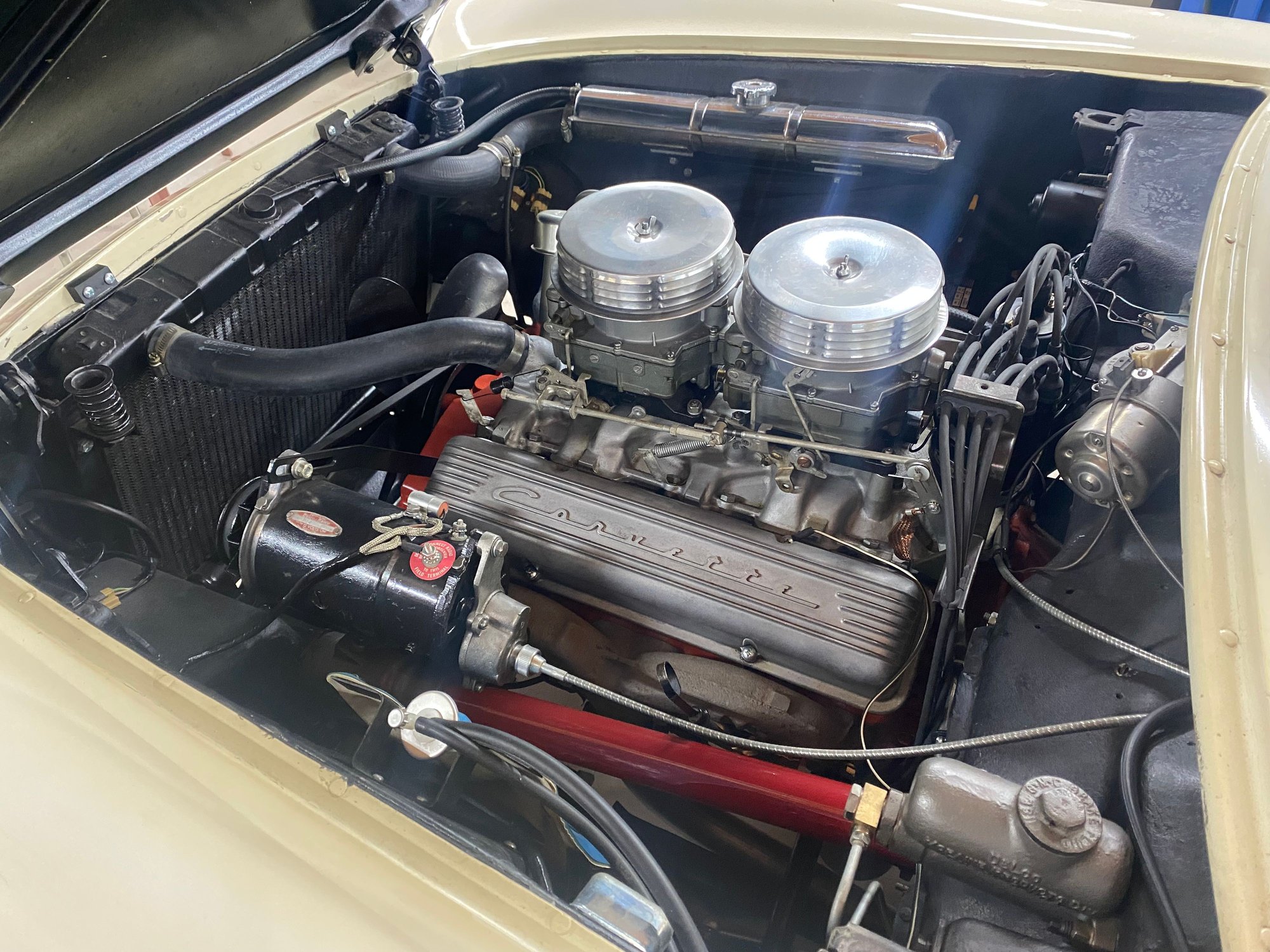

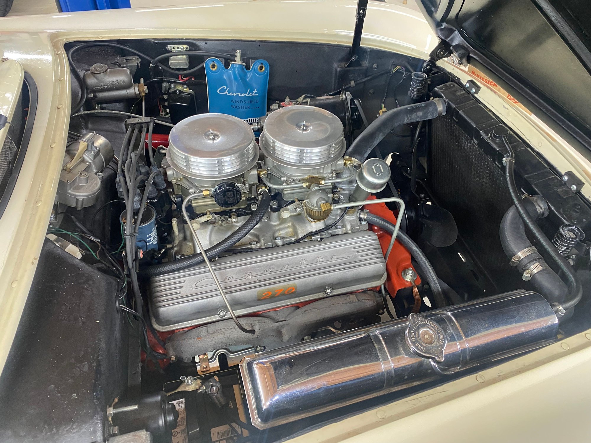

I’ll add my 2 cents.
Im running a 283, 097 solid cam and dual Carter carbs. I also have M-20 4sp with a posi rear from a 62 Corvette with the strut rods, 3:55 gears, and turbo mufflers . It’s my period correct Hot Rod and I love it. With the hood closed, you’d never know it had a V-8.
DAN

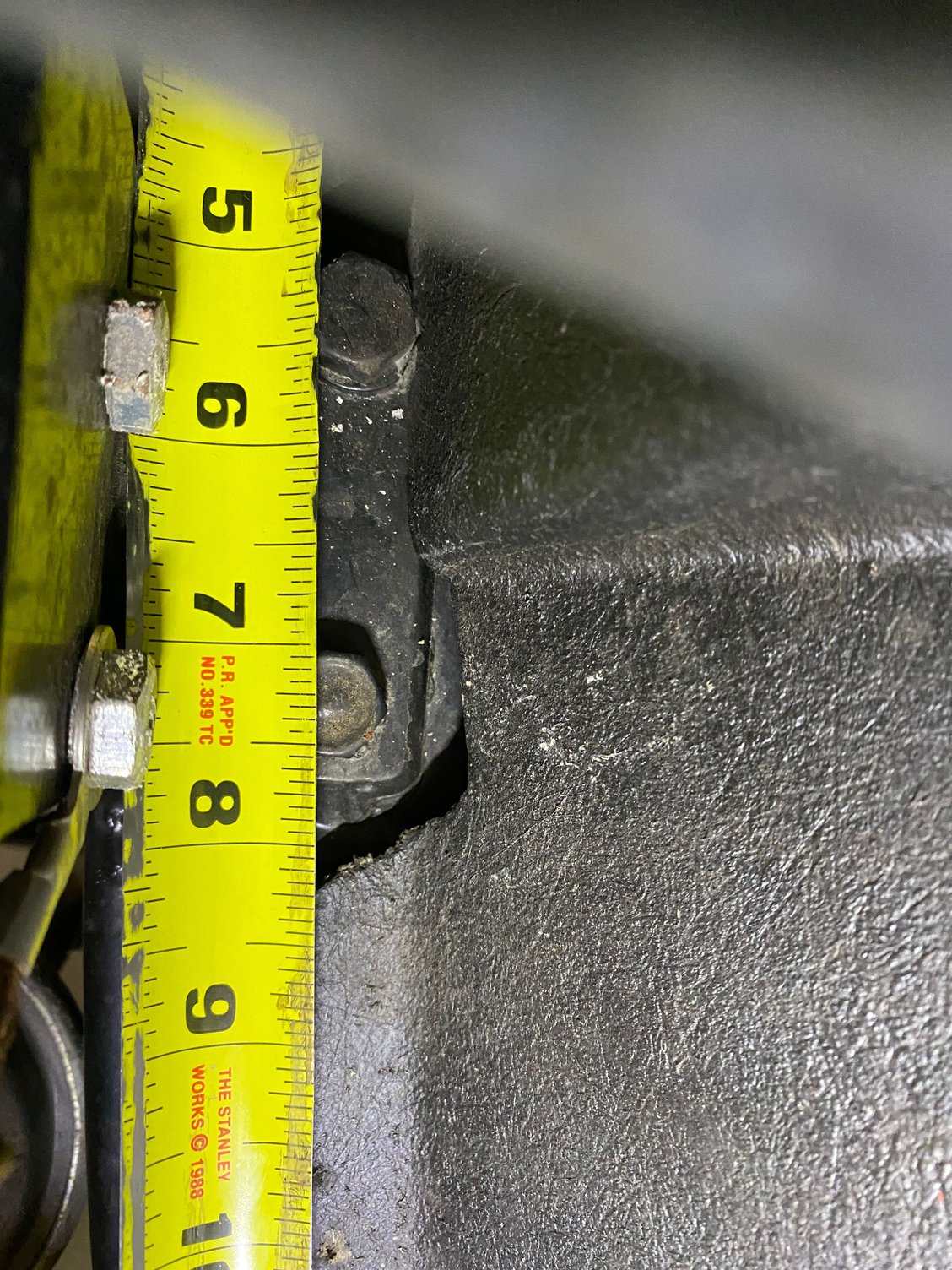

Originally Posted by JulianReid

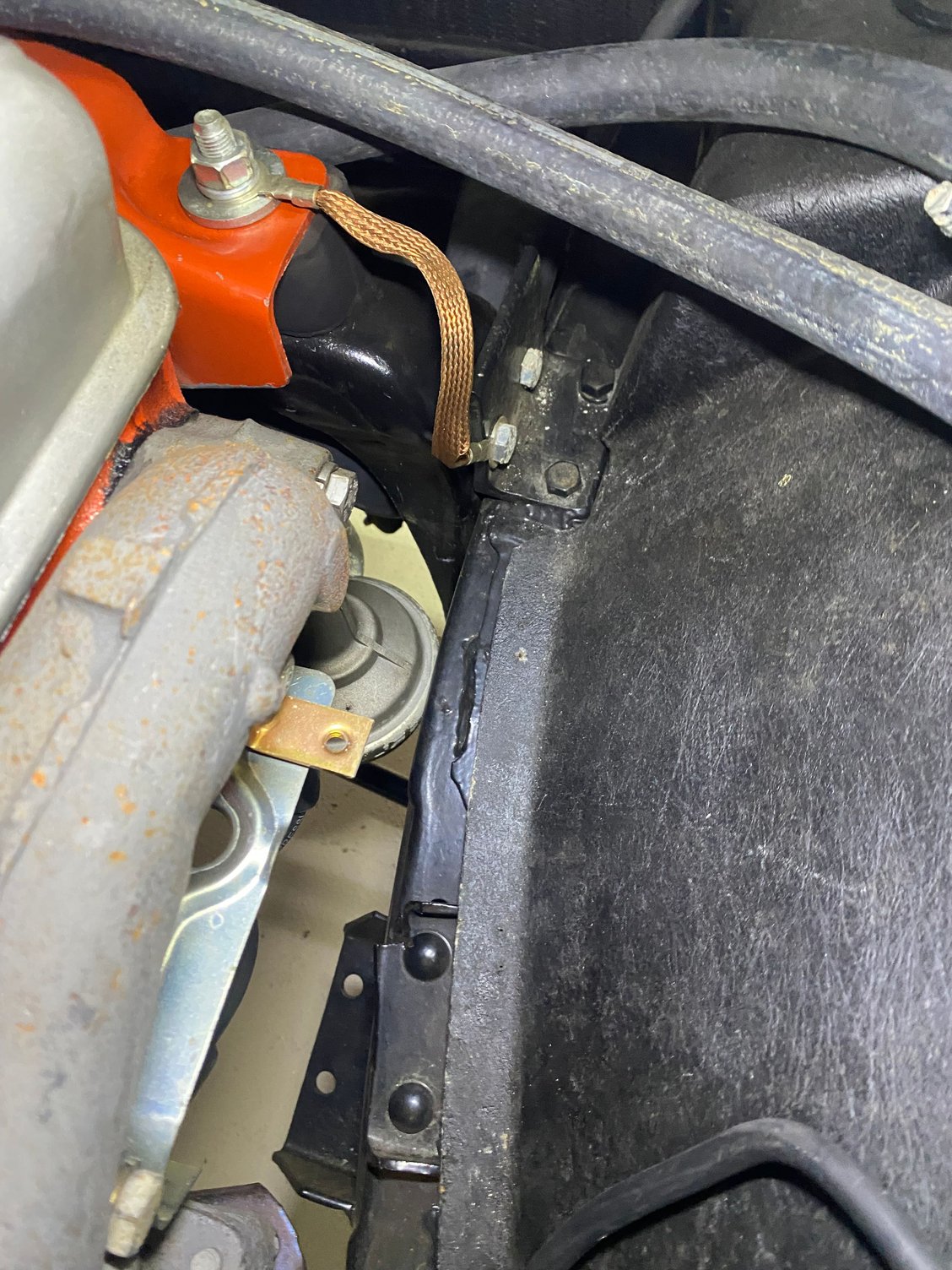

would anyone have the measurements on exactly where to put the motor mounts? Thanks in advance. Julian
This is the best I can do, not much to measure off of.
This is passenger side taken off the sway bar.
It looks to be the same on driver side, the generator is in the way of a photo.
This pic is looking straight down.Motor mount is on left.
DAN
