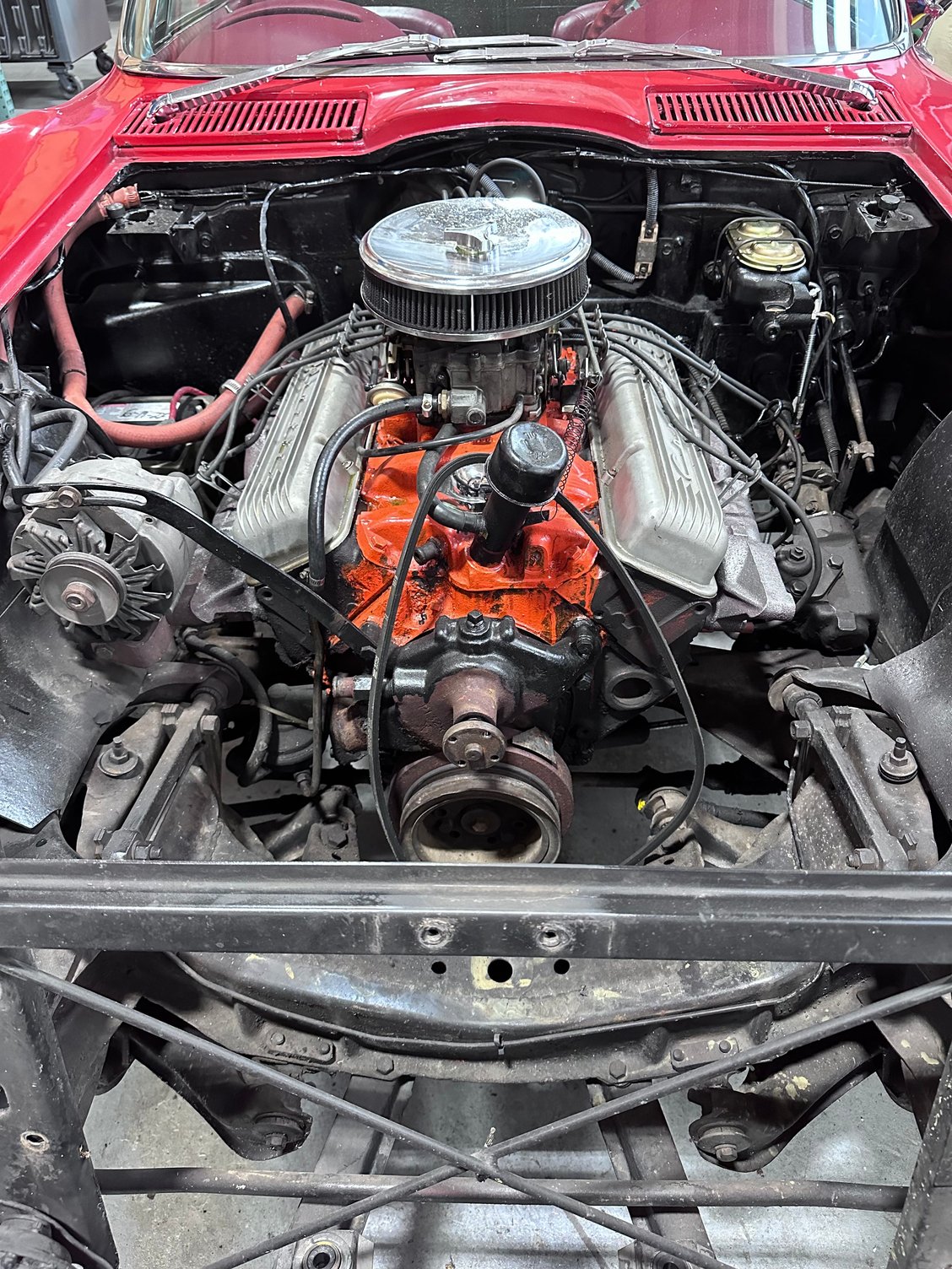

Current 350

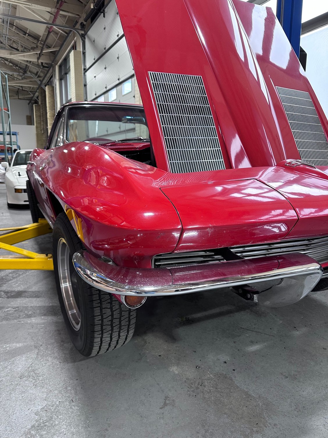

Happy to help. Will get info. on Wilwood when done here. Current status (if anyone is interested):
