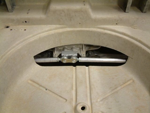

If you can work with fiberglass, here is how I built the cover for the cutout on my '59.
Here is the cutout around the C4 differential.

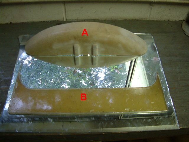

The piece marked 'A' is the piece that was removed. I made the piece marked 'B' from fiberglass
Here are the two pieces in place over the cutout.
