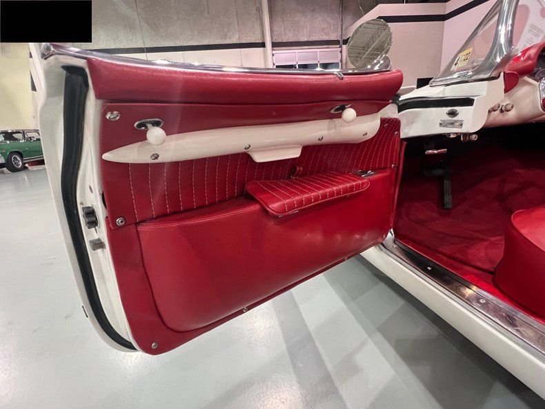

I’ll take one when I get home, the door panel has two pulls on the inside, open and lock

here ya go

The rear pull isn't a door lock. It releases the side curtain pin when you want to "roll the window down", as it were.

You Sir would win bigly on corvette jeopardy

The rear level / **** is the release for the side curtains
When the side curtain is installed - it ratchets down into a hole in the chrome and a hole in the door
To release - pull the **** and the curtain releases....

also the rear **** should be smaller than the front ****
