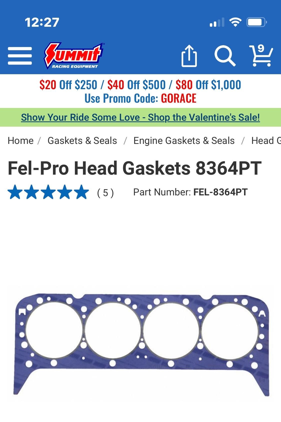

I ordered for 327. Don’t remember part number.they sent me part number fel-pro 8364pt.I don’t know if they will work but they are staying on.I am not going to take it all a part.wish me luck.

Well it looks like that gasket is specifically for a 400 and has steam holes. I don't think steam holes will be a problem but as someone already said the bore diameter is larger than stock reducing compression some degree. If it runs ok I wouldn't mess with it unless it becomes a problem. JMO.

The Fel Pro 7733PT2 has a bore size of 4.125, the Fel Pro 8364PT has a bore size of 4.190
So the 400 gasket in this case is .065 larger bore than a 327 gasket. Both are nominally .039 thick. The use of the 400 gasket is not fatal, it will work, you are just leaving some performance on the table.
If you don't run for maximum power you might never notice the gasket change. I doubt the change would net more than 15 HP if corrected.

The head gasket must fit the combustion chamber as well. (Either the bore or chamber, whichever is larger.) Without mention of the head used, you need to look close there. No portion of the gasket can extend into the chamber or bore and survive or create detonation issues. This is why you see non-round head gaskets. Typical SBC in stock trims will be about 4.100-4.125". The steam holes only matter if the block and heads are drilled for them.

The engine is 30 over.so I been thinking it’s probably not as bad as I thought.
