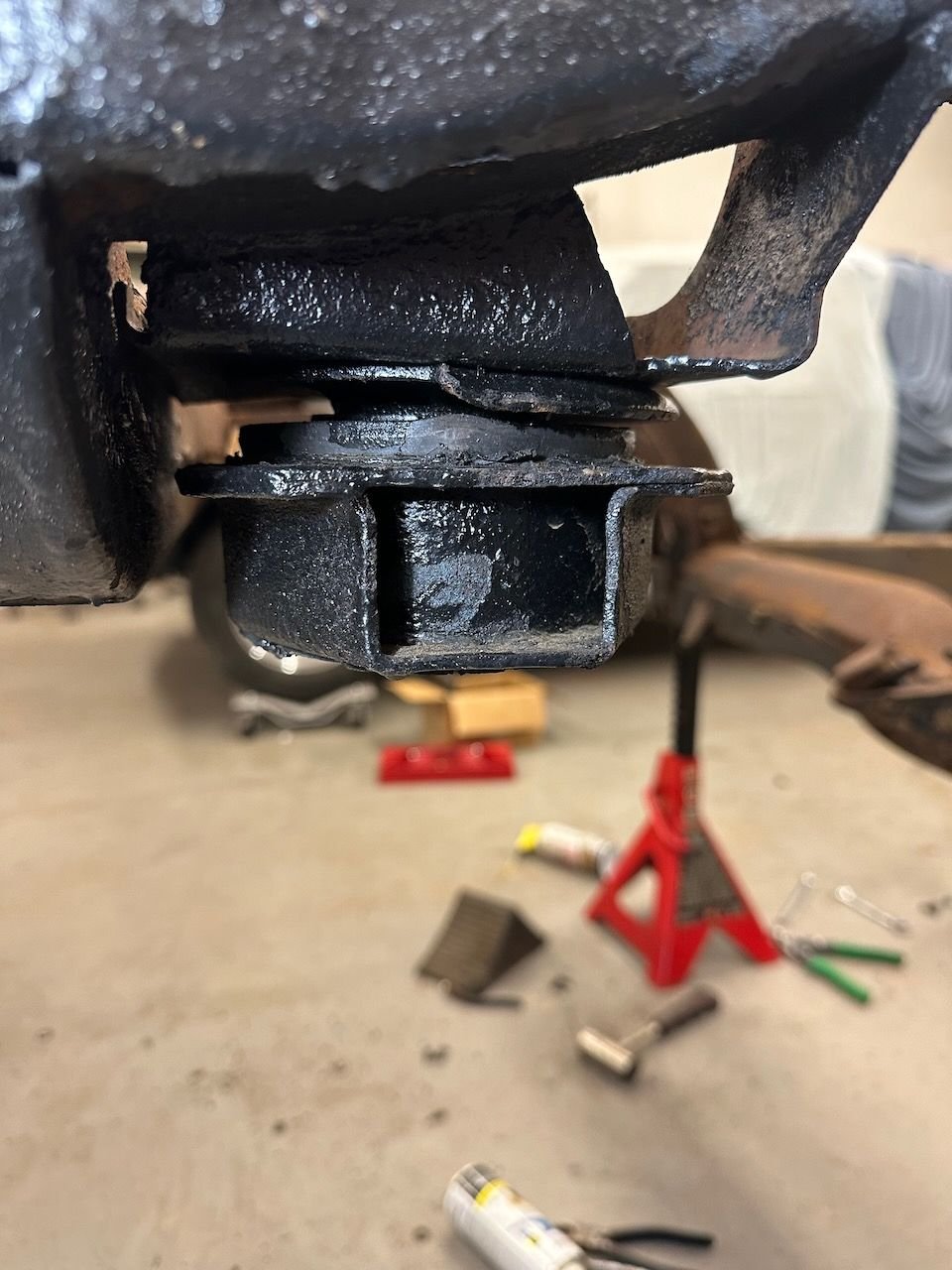

Just about ready to get frame to be media blasted, but I need advice on how to drop the transverse differential mount. Removed the bolts from underneath pried and dead blow hammer and it dropped a bit, but that's it. doesn't respond to a little more encouragement. Am I missing something?.........Parts everywhere, organize tomorrow and label!!

Did you remove the bolts in the bushings?

Remove the ones on the bottom of the cross member;
I removed one bolt from the bottom on each side. Are there others??
if you removed the bottom ones then the only thing holding in place is rust

We had success by driving wood shims between the frame and cross-member. Very loud pop when it came loose.
LOL...........figures!!!

Heat and aggression

Originally Posted by reno stallion
Heat and aggression
a six foot old fashion steel digging bar makes a great leverage tool

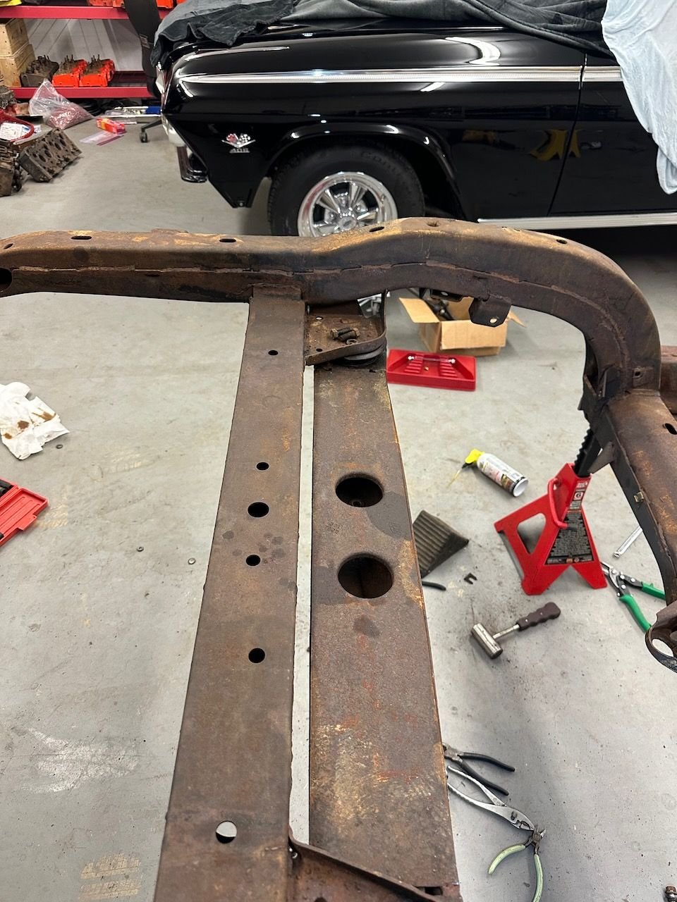

I agree with Keith.
A six foot long pry bar seems to work well on those connections that are fighting you. Here is a picture of what it should look like after the removal of the cross member just to give you some perspective. Picture from a 64'. Good Luck with it. C.J.
