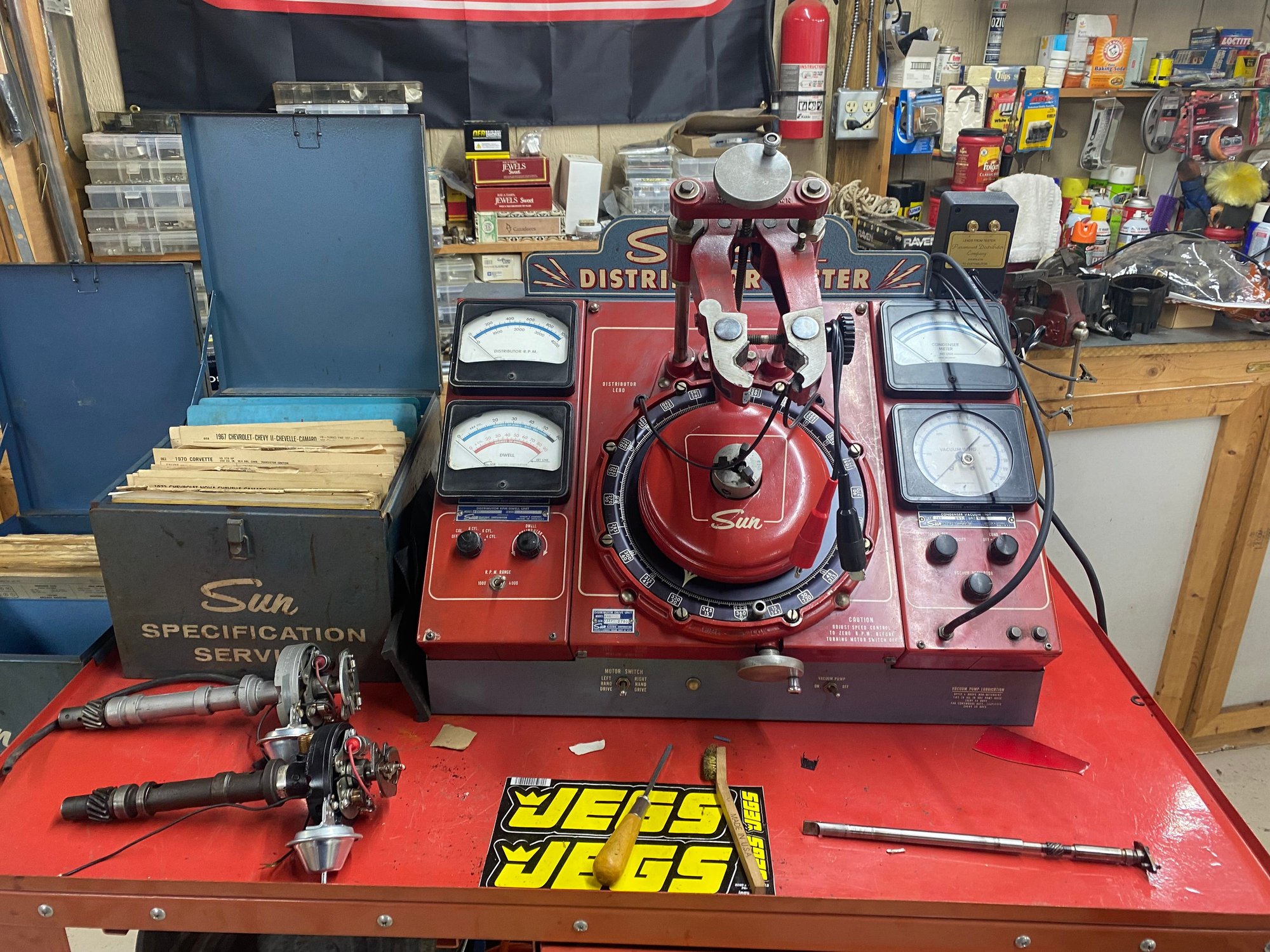

This is a points tension gauge. They’re used with SUN Distributor Machines.
