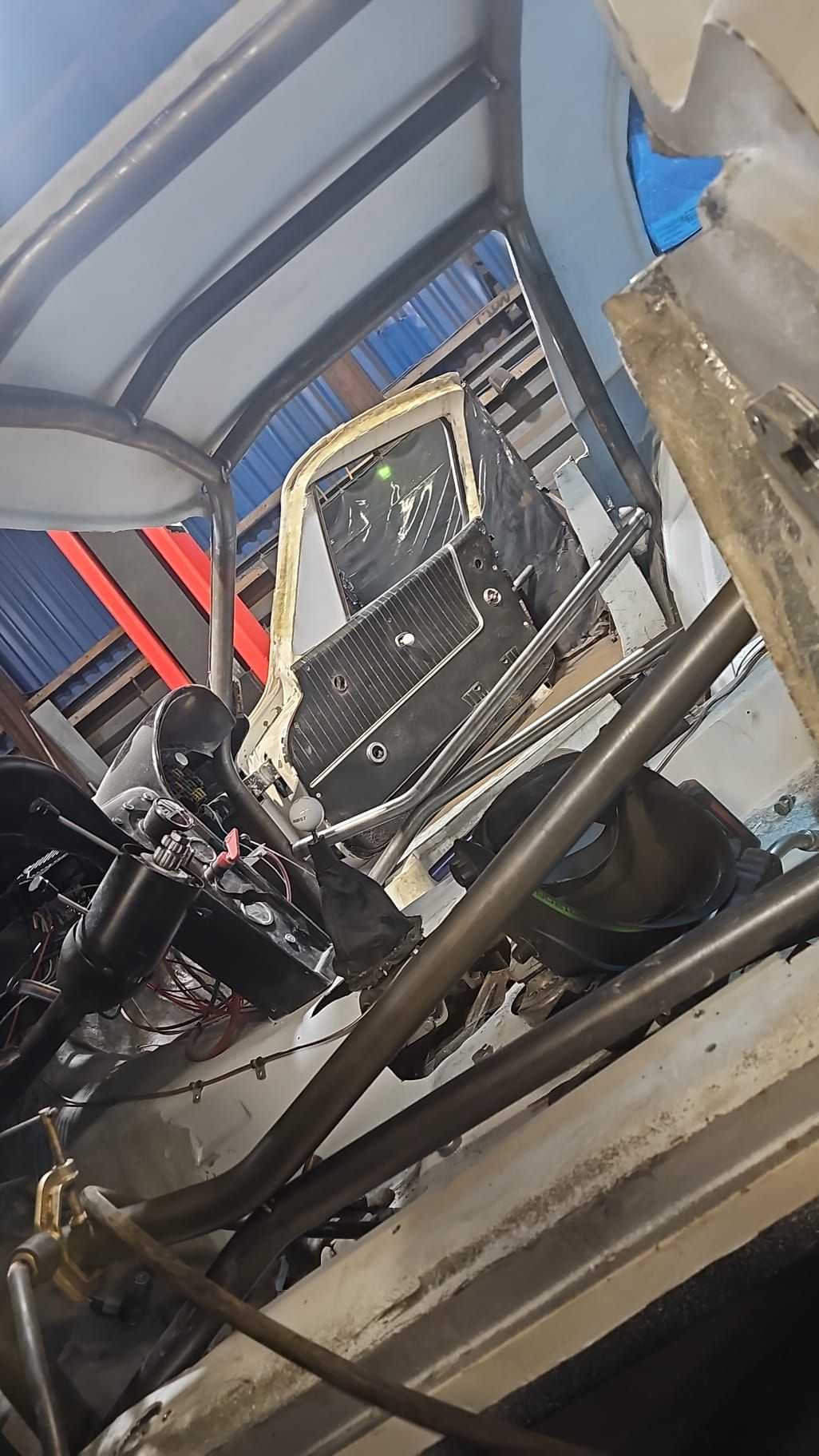

Just having my cage installed ready for this years racing , must admit very pleased

Looks good . Drag race or vintage?

Nicely done.

Very nice. Hand made or purchased from a vendor? If vendor, who? Thx

Very nice and tight!

circuit racing

company in the Uk called JP Cages

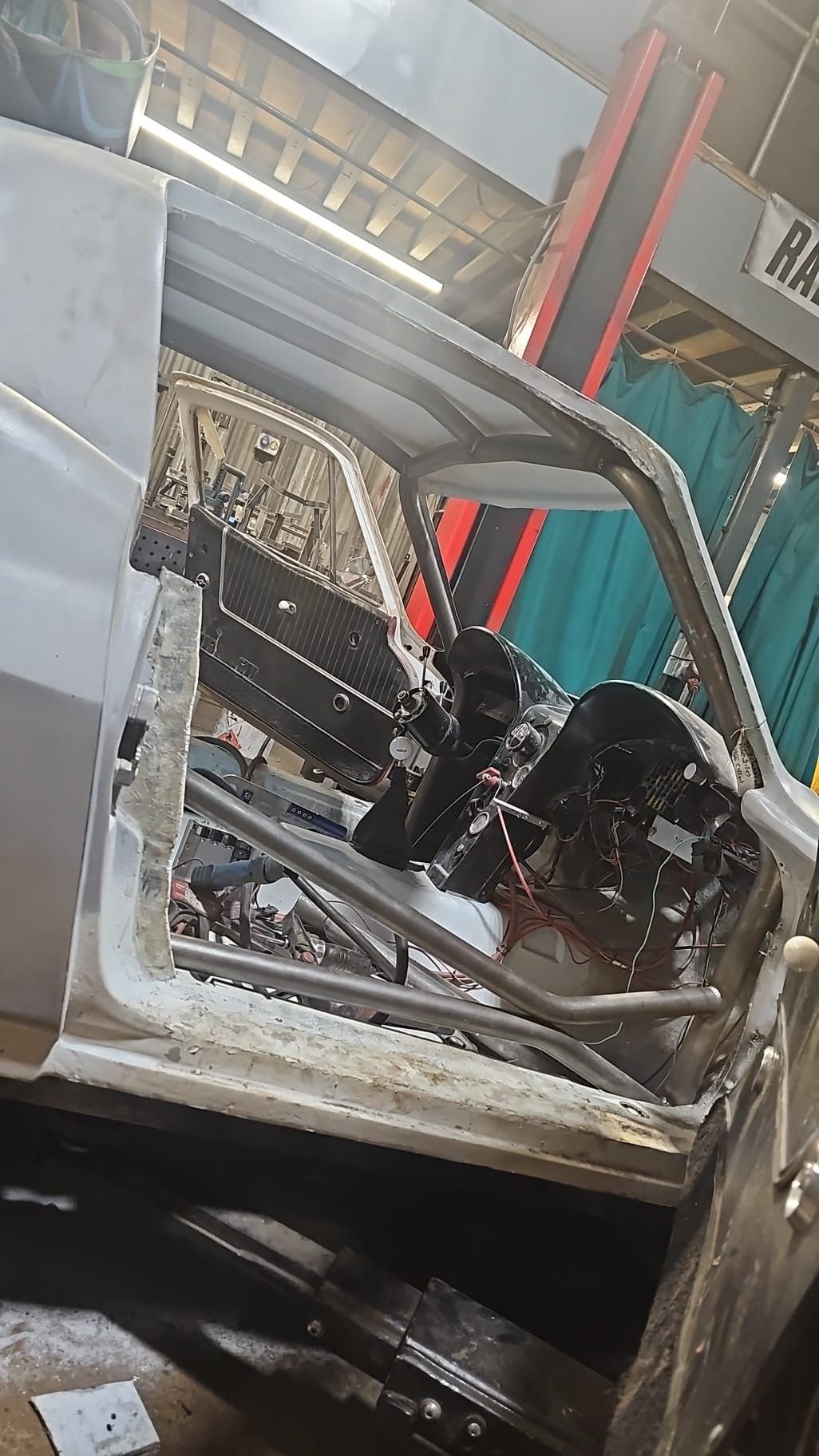

Bit more progress

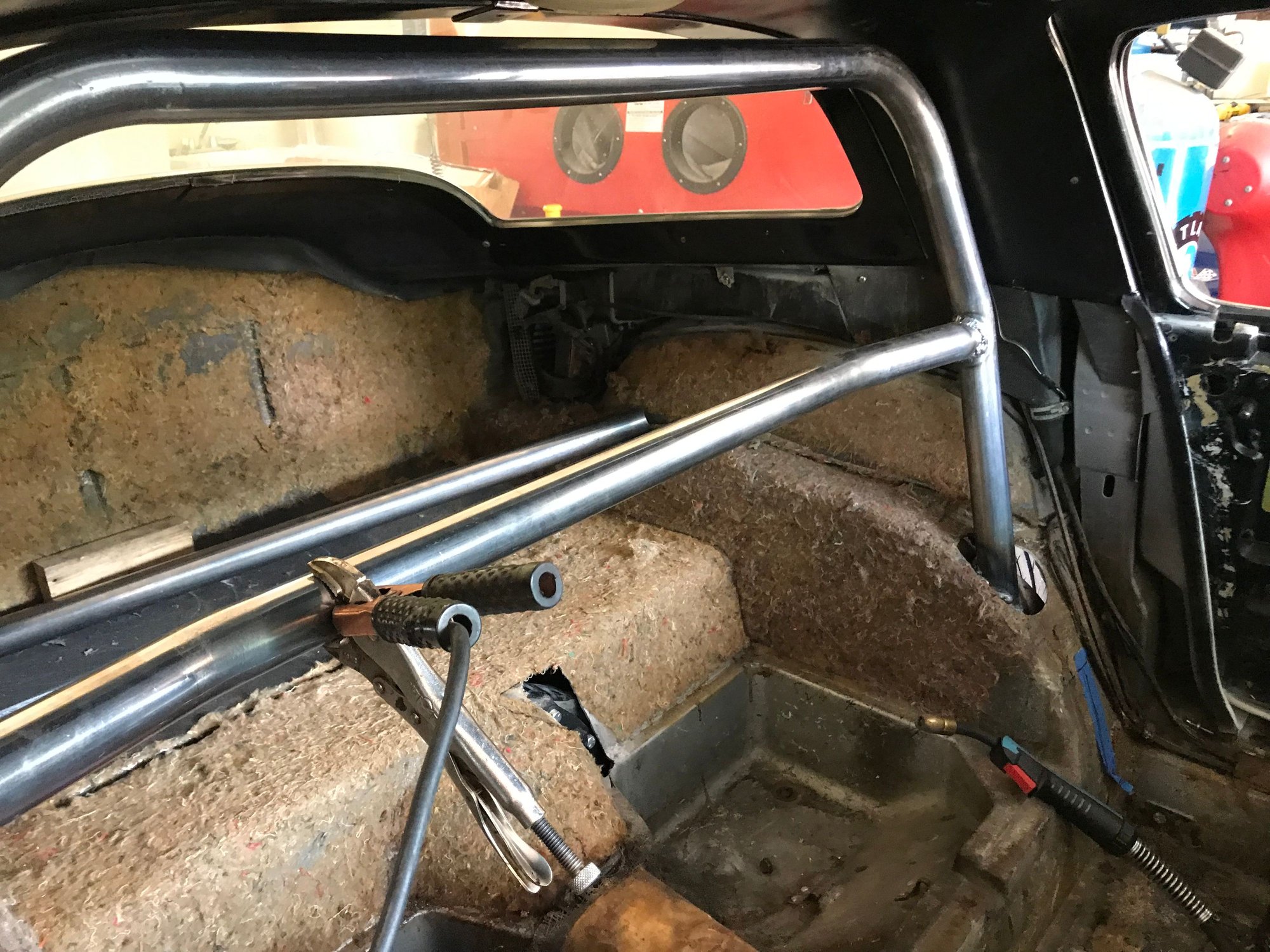

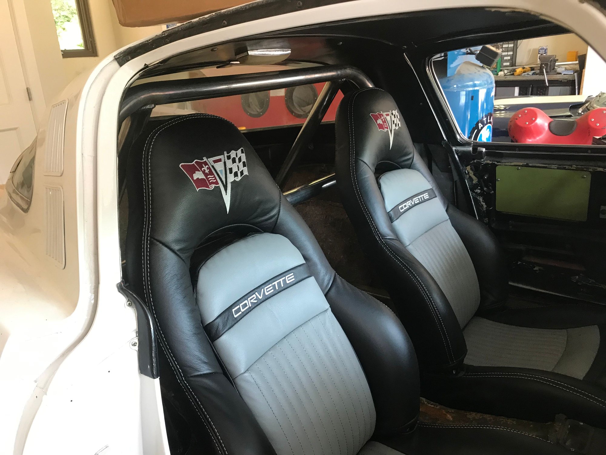

Very well executed and it looks like you preserved the birdcage for the most part. I installed a 4 point in my coupe mainly for additional rollover protection and harness mounting points.

If you're going to do any serious vintage road racing you will need side protection in the door area and frame to top cross bracing side to side.

Rear pretty much finished

Did you cut into the dash?

unfortunately but not to much

Do you know if they make one where you can keep you interior moldings maybe not so aggressive? And are you going through the fire wall?

They make them bespoke but you are limited by steering wheel to cage room for bar placem
ent

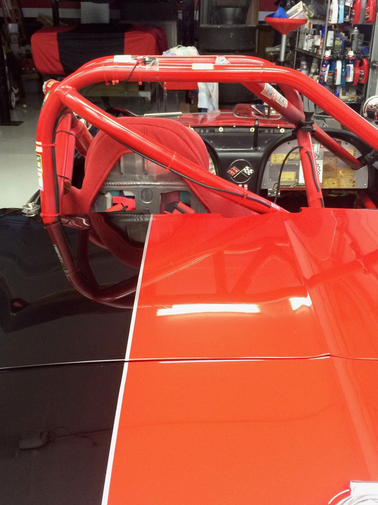

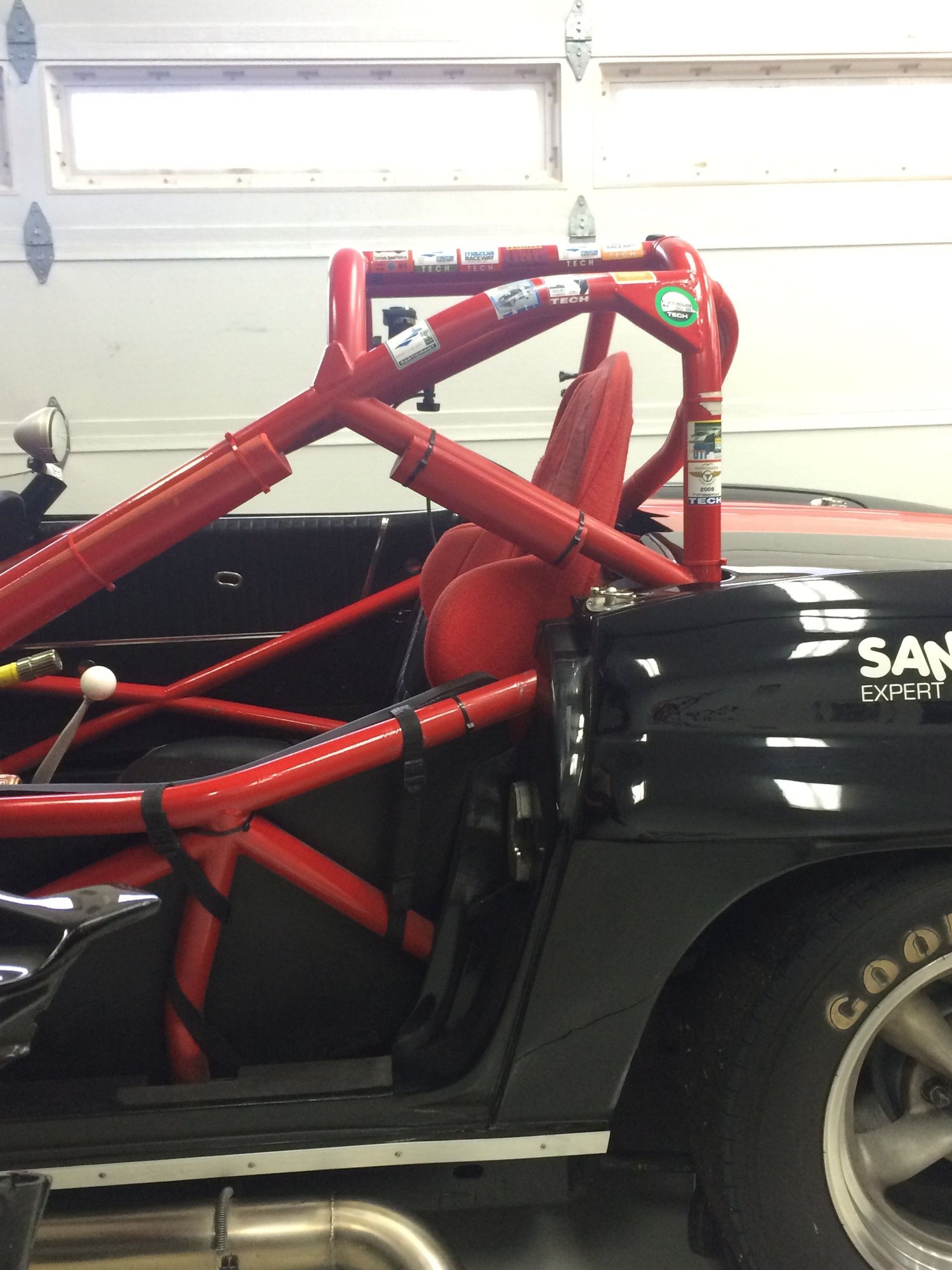

331 cu inch 13.5 compression, stock 461X heads ported and relieved 14 quart wet sump system, stamped steel rockers and flat tappet cam. Rochester fuel injection. Around 500 HP.

I bet that sounds great with that compression

Better have good ears plugs in, it hurts.
