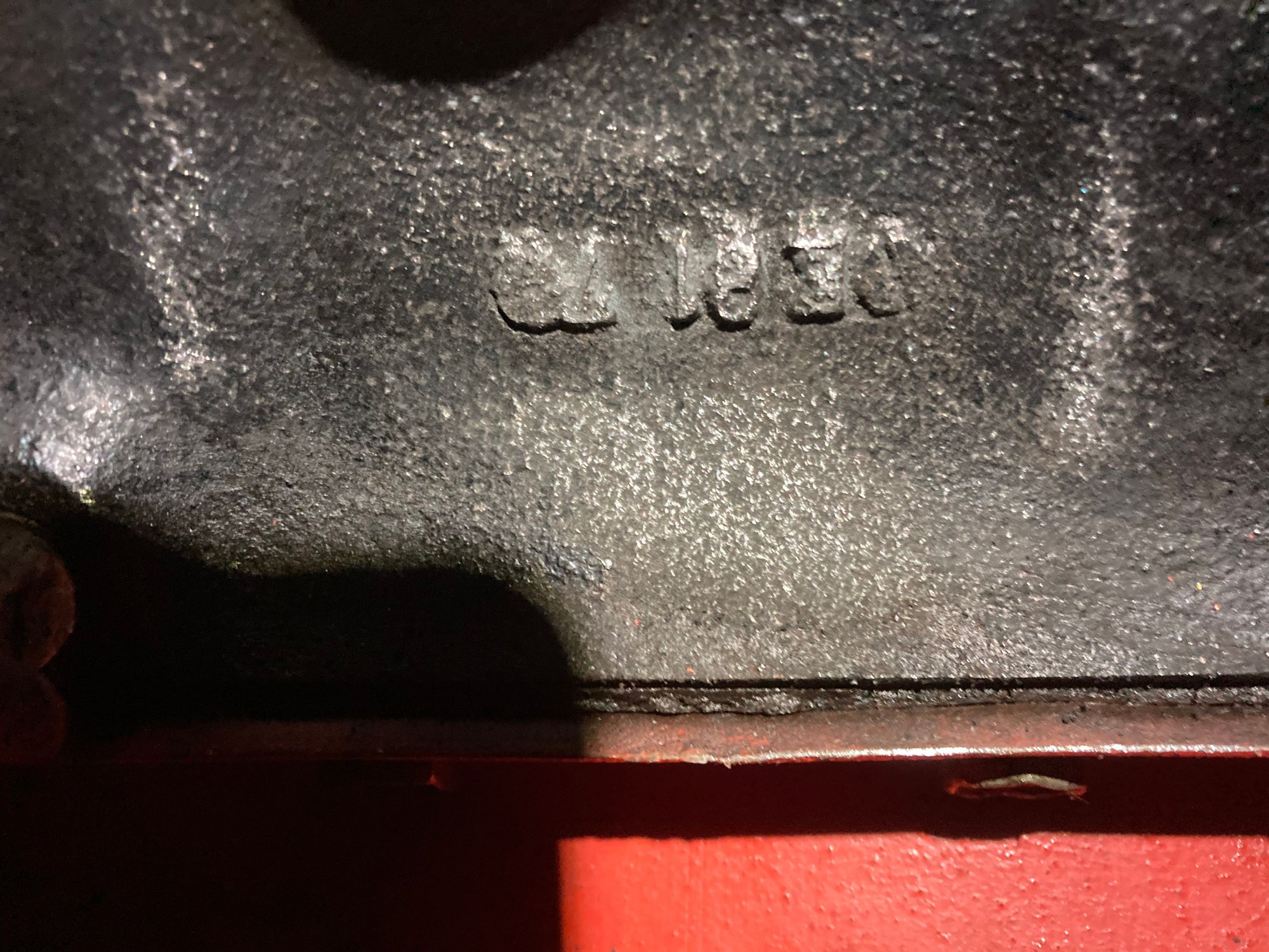

I cannot figure out this date code. It looks like E 31 7 but is that may 31 1967 Any help would be greatly appreciate it.

May 31 67 would be my guess. Of course it could also be 57 or 77, the casting number would help determine the year.

MAY 31 any year that ended in 7

It’s a 3904351 67 4 bolt main.

The "351" block came in both 2 and 4 bolt configurations, depending on the horsepower. Solid lifter engines (L-71 , L-89, L-88) got 4 bolt mains, hydraulic lifter engines (L-36, L-68) got 2 bolt mains.

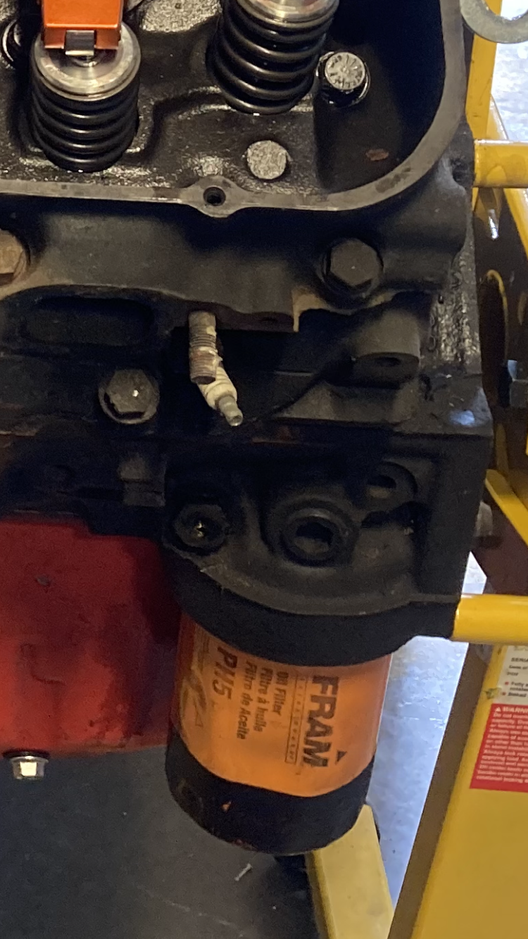

4-bolt blocks had a functional oil cooler passage while 2-bolts did not. Unless you have to anyway, before pulling the pan investigate the following detail from John Hinckley:

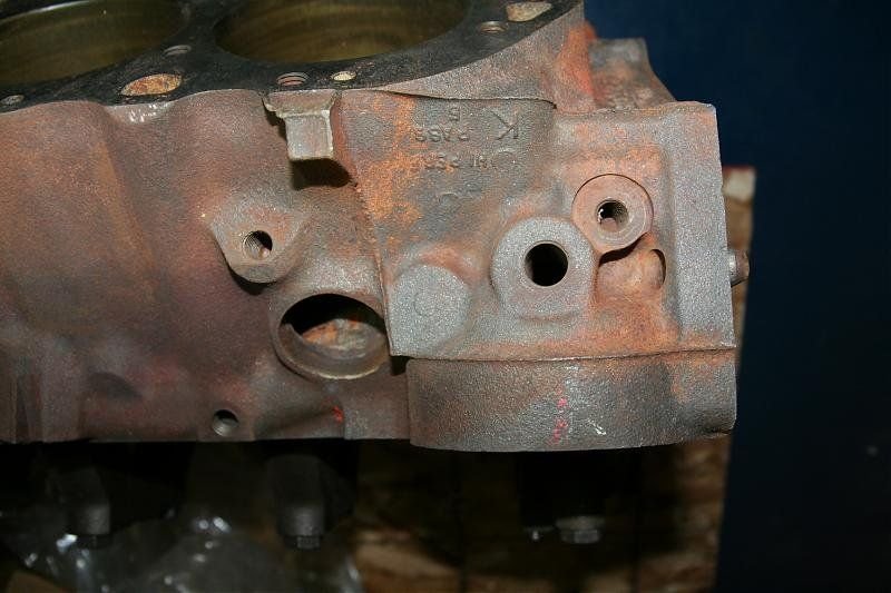

Originally Posted by JohnZ
The photo above is correct for the 4-bolt blocks - leaves the middle hole available for an oil cooler connection, which is why it's there. On a 2-bolt block, the forward hole isn't drilled, so the drilled oil pressure tap is the hole immediately above the center of the oil filter canister (same hole used for the oil cooler on a 4-bolt block, but smaller). Photo of 2-bolt block below.

So this is a 67 351 block 4 bolt main then. Thanks for the education
