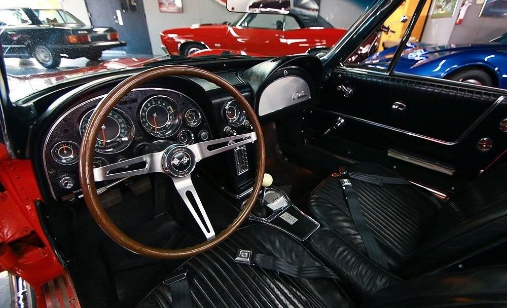

New pics posted while I was composing my reply above. I'd steer far and clear of this car. Even giving the benefit of the doubt on the VIN tag being human error, there are too many other weird things, most of all, the '64 interior. Those gauges and the textured dash/waterfall are not '65. The gauges should be flat-faced, satin black; the dash should be smooth matte finish. The seats and door panels are also the 1964 style.
I'm thinking this car has been assembled from various years and who knows what the real VIN is.

Maybe it's me, are those gauges from a 63/64? Jerry
That is Correct!!!
