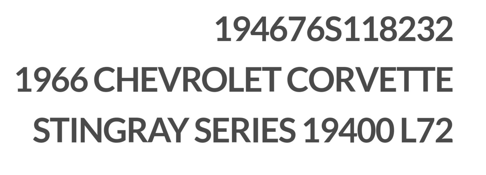

Just out of curiosity I went to BeenVerified and typed in the VIN for my 1966 Vette. It came back with:
Is there any possible way they can identify my car as an original L72? (Which I don't think it is.)

Sorry, no.

All the vin tells you is it's made by Chevy, coupe or convertible the year. Where it was assembled and when

They can’t even spell “Sting Ray,” so…

If you have the original protecto plate it will have the vin# on it that matches your vin on your vin tag. It will also have the engine, transmission and differential codes. If the engine code has "IPH" on the end of it. It's a real L72. (That's my understanding anyway.)

Isn't the thousand dollar question as to using our "shorter", non 17 digit serial numbers? I thought this was not possible

it wasn't until 1972 that GM put a place letter in the vin for the engine type. so anything else before that is guess. some more correct than others. just think of your car as a base 327/300 3 speed until otherwise proven different
