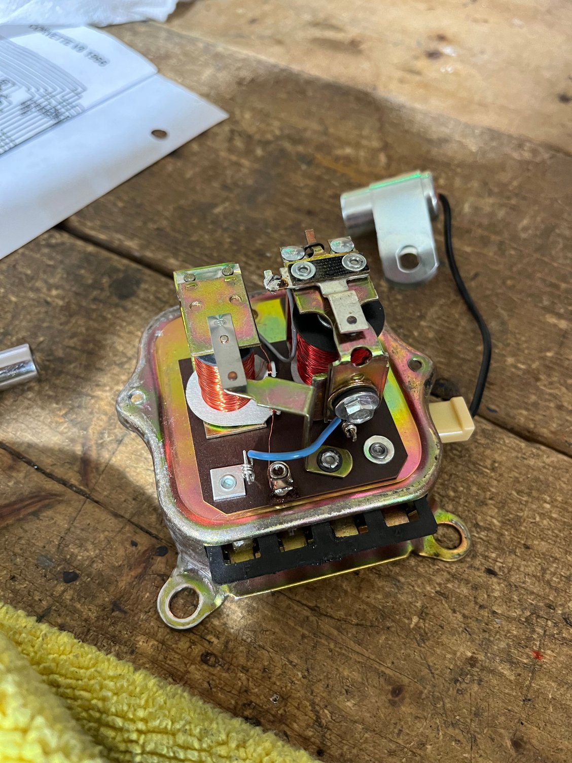

Default Voltage Regulator
Last cruise out 66/427, I discovered a buzzing like noise from under the hood. Upon further investigation I noted that the voltage regulator was the culprit. Did some research on the issue and found mine has points system. (So does my ignition system). So I cleaned up the tri-set of points, and so far it’s been quiet. It has a good ground so I don’t believe that’s the problem. I placed an external multimeter at the battery cables and am getting 14.5v. On its way out? Replacements units no longer have the old style contact points.

Many of the forum members have switched over to an electronic VR. They slightly modify it so you can use your original cover. Yours looks new. I would just keep an eye on it. Jerry

Sounds good to go to me – the output voltage is good, the contacts are now refreshed – I wouldn't change it out.

Vibrating points type regulators, also called electromechanical regulators buzz. Normally you don't hear it unless a mounting screw or cover screw is not tight. These regulators work somewhat like a door buzzer in that a contact makes and breaks a circuit or circuits many times a second. They are slower when charging a depleted battery and quicker fully charged. The moving contacts are buzzing between resistor poles mounted behind the regulator rapidly switching them in and out of the field circuit.
If you measure 13.8 - 14.2 volts DC across your battery with the engine at a fast idle, with headlamps on, your regulator is fine.

Without those readings its obvious diagnosis is required. You can bypass the regulator and command full output with a jumper between the F terminal on the alternator and the alternator output stud (which is 12 volts from the battery). Engine running at high idle make this temporary connection with your meter across the battery. You should see between 16-18 volts DC. This is the alternator running at full unregulated capacity. No or low readings indicate a faulty alternator. Correct readings indicate a faulty regulator.

I advise highly against this. His regulator and most in current service are reproductions and approximations of the original Delco design. The original Delco design is adjustable if done via shop manual instructions. These modern day replacements are not adjustable. Bending the armature or spring hook will ruin it. Regulators don't fall out of adjustment. Their contact surfaces pit, oxidize, create high resistance and eventually an open circuit.
