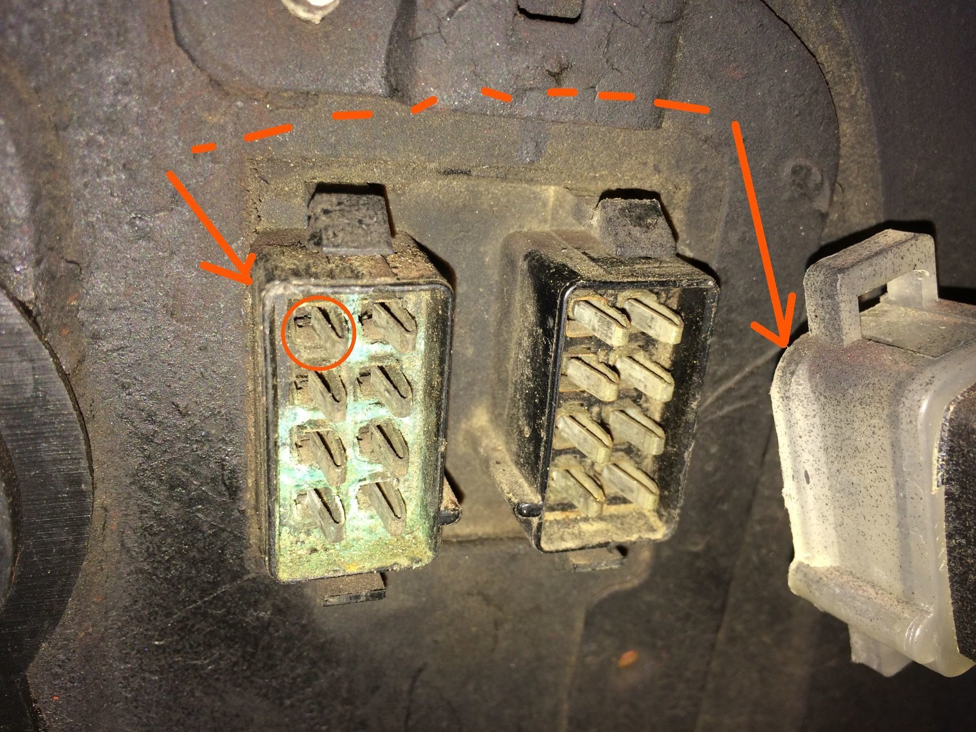

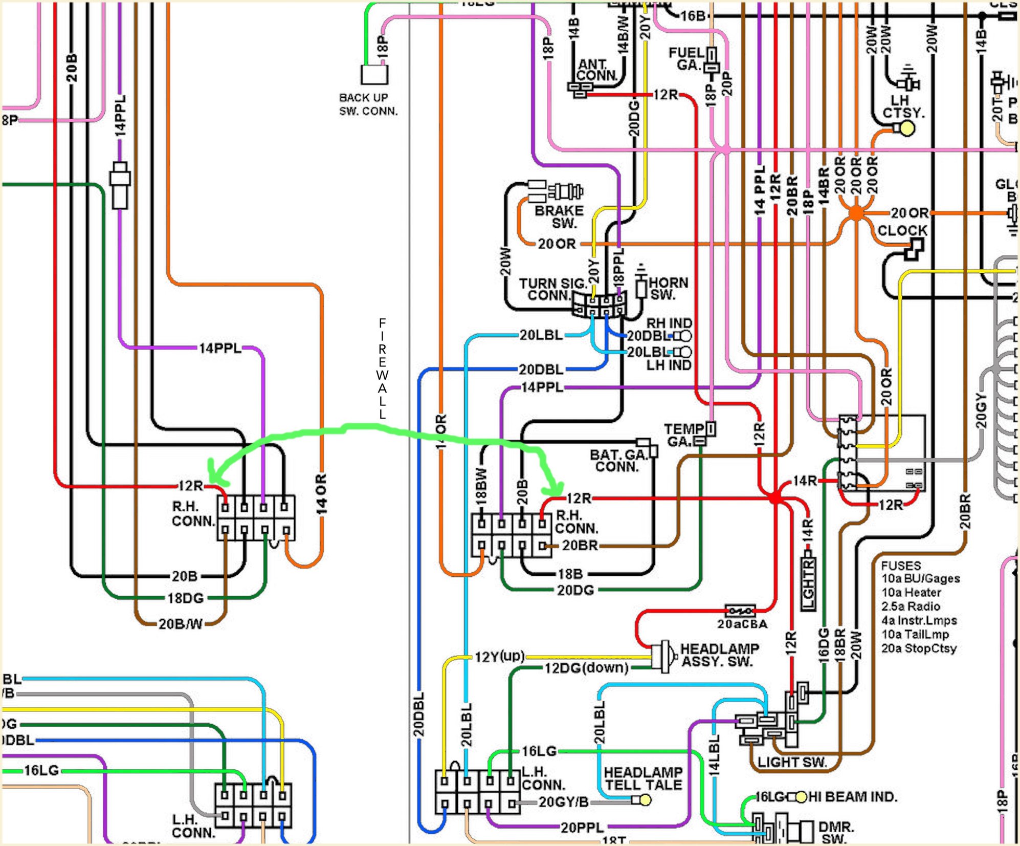

Next time this happens try the horn. If the car is stone dead but the horn blows the problem is in the firewall connector, left hand connector as you face it. Gently pull back the two ears being careful if its old. Pull the connector away and look at both ends for green corrosion and so forth. This is a very common problem and your description fits it to a T.

It won't be the battery. This connection feeds all power to the cabin. When it happens again, you'll find if you just wait a few OR slightly wiggle this bulkhead connector the car will work again for a while. If you pull that connector off and look, you'll most likely see it has been hot and is corroded. A SURE PERMANENT fix is to bypass that connection by connecting a new piece of wire (I prefer red) from the wire coming out of that connector to the back of the fuse box where the red wire connects, OR you can connect the other end of the new red wire to the connector on the headlight rollover circuit breaker with a ring terminal. Use the post on the circuit breaker that comes to the fuse box and not the one that goes to the rollover switch under the dash for the headlight motors.. This picture's plug is badly corroded, if yours looks to be in pretty good shape you may be able to just clean both sides of the connector and reconnect. If the red wire is the problem as said earlier (and your horn worked previously) it will still work. If you were losing connection at the battery, the horn also wouldn't work.

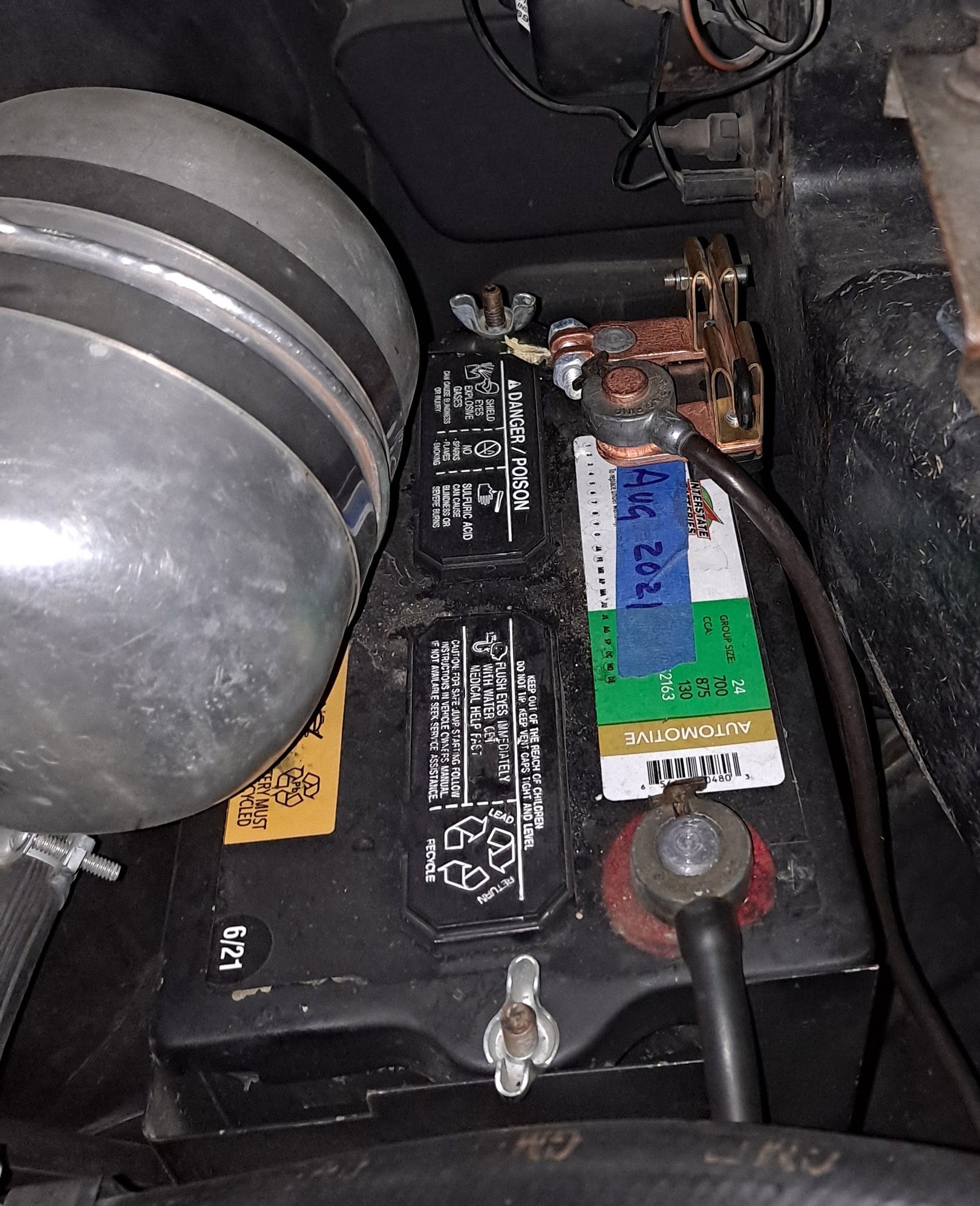

Thanks for the information. I will research it further. One thing I didn't mention is the positive post has a disconnect on it. The kind with the round **** on the terminal clamp. I was advised to replace this with a standard cable clamp which I'm going to do. Also when this happens I have no electrical power at all. Nothing works. Lights, horn etc and the ignition switch doesn't click either. As soon as I tighten the clamp it starts right up. I'll do the research and report back. Thanks again

There's a good possibility that you have corrosion where the screw **** threads are down inside that cut-off switch. Secondly, you would be better served to, simply, buy a new switch...they get old and tired. Thirdly, it's best to have the cut-off switch mounted on the negative battery terminal. Clean/tight electrical connections are key in all situations, especially both ends of your battery cables. Just some thoughts.

Removed the cut off switch completely. Positive battery cable was a tad loose where it connects to the cut off. Put the clamp back on without the cut off and securely tightened it to the battery post. So far no problems. I hope I found the gremlin. Still with no emergency flashers I'm gonna get someone to follow me over some bumpy roads and see if it happens again. Keeping my fingers crossed.
Still have to fashion a custom battery hold down to keep it from bouncing around. Doing that tomorrow.

Regardless of the type, battery disconnects only complicate an already weak connection for high amperage use. I have never had a failure like yours where the car dies while running, but have had plenty of cheap terminal clamps fail due to poor contact with the posts. I remember having to drive a screw driver between the clamp and the post to get enough power to start the car. Hoping you found your problem.

IMHO, this is the best battery disconnect. Throw that green **** crap in the trash can!

One of us should have weighed in by now, my apology. The cheap green **** quick disconnects sold at swap meets are a piece of **** if you will abide by my directness. Put it in your hands. Unscrew the **** and examine what is actually making a connection that is intended to pass 200 amps of starting current. Yours is likely all pitted and burned. If these go open under way they will play hell with your alternator.
Use a half inch wrench or a knife switch instead. The cheap green ***** are a well known problem.
