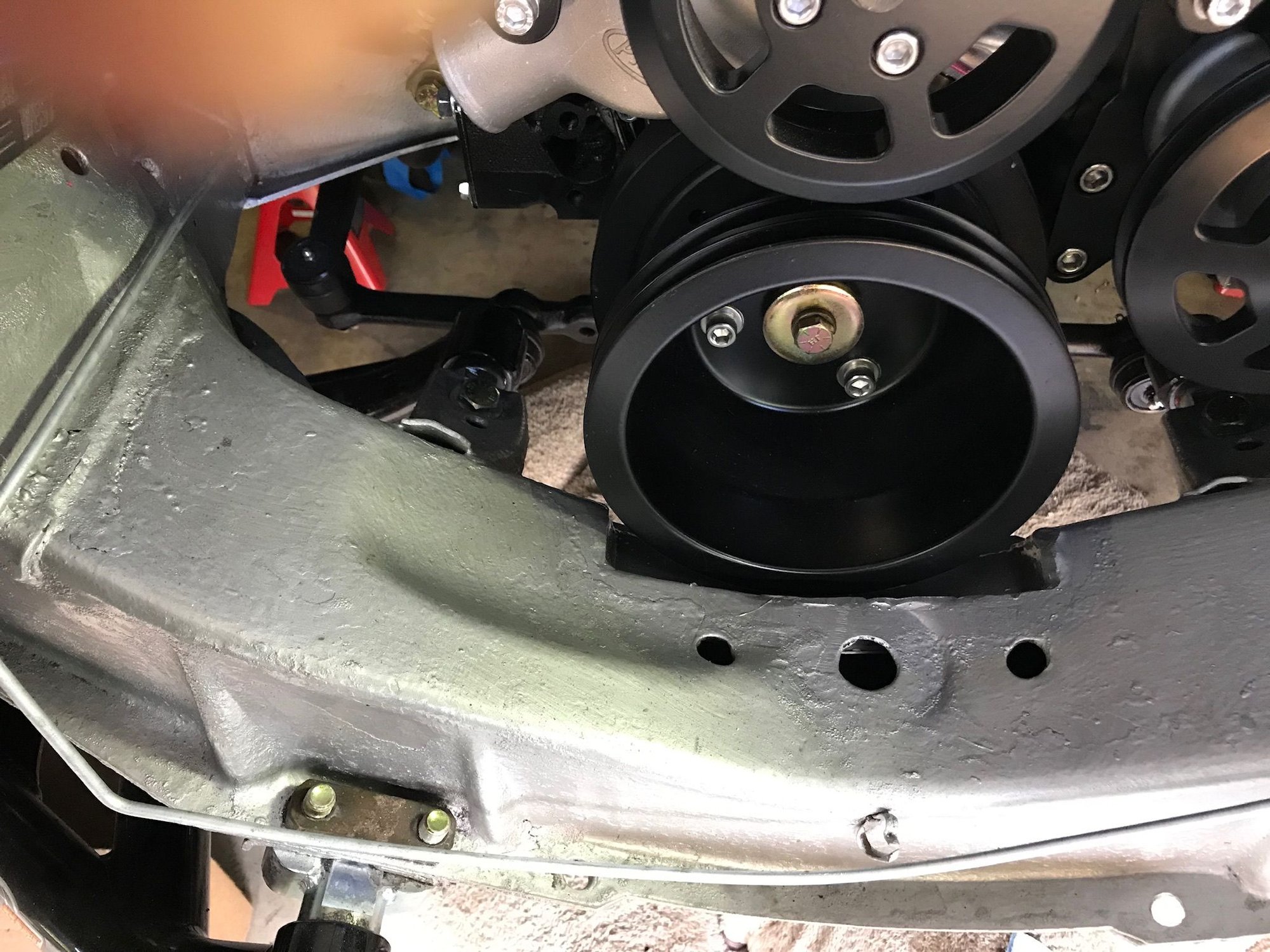

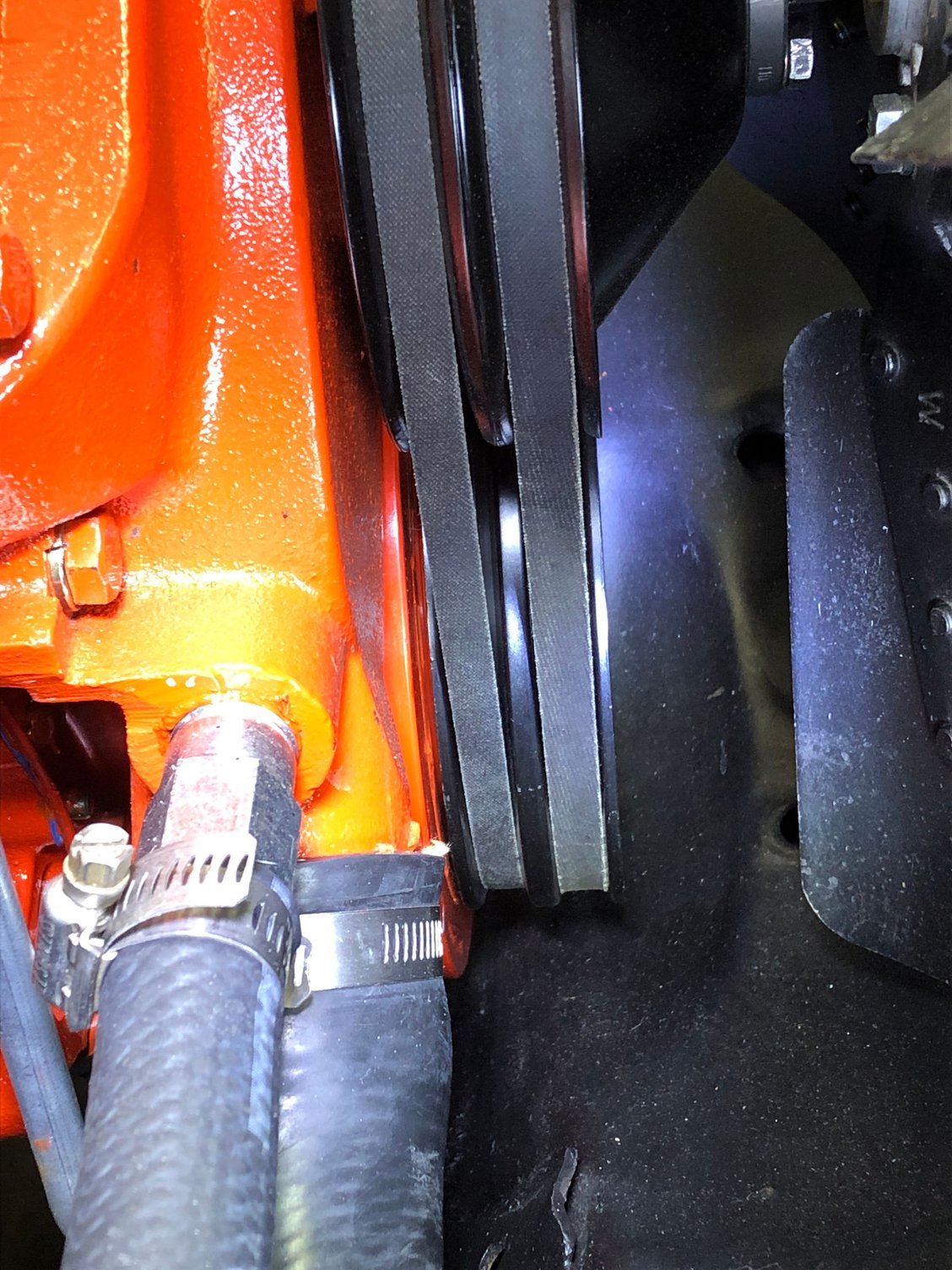

I'm converting my 65 Corvette with a 396 engine, from manual to power steering. I'm using the Borgeson Steering Conversion kit 999016.
I've run into 2 problems:
1. Shaft from steering column shaft to long to fit into rag joint on Borgeson. Understand I may have to cut shaft from steering column. Any other suggestion or solution?
2. Had to purchase harmonic balancer pulley for big block, but pulley is rubbing against the front chassis cross member. Has anyone run into this problem? Is there another pulley that solves this problem?

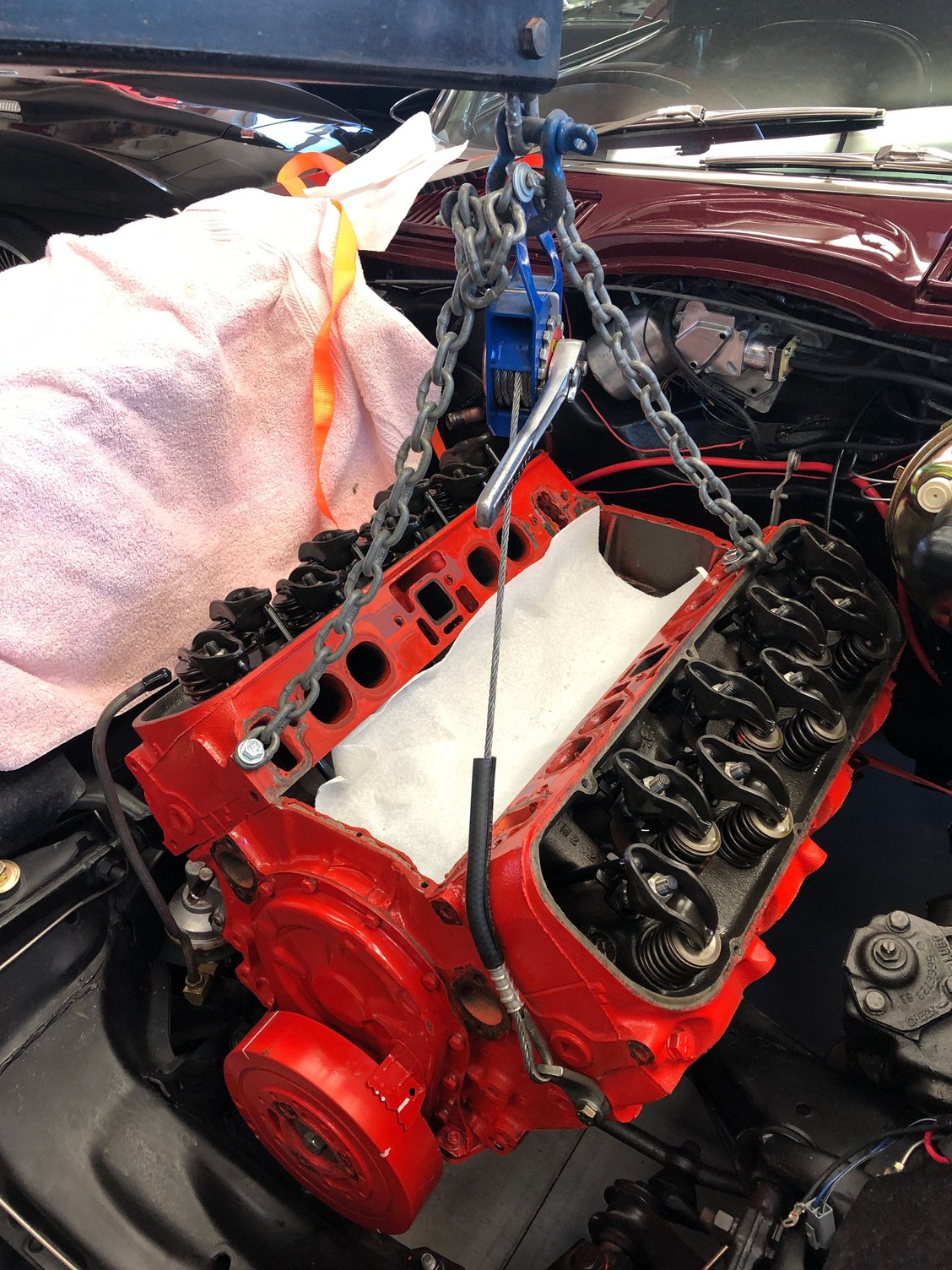

I added PS to a 65 396 Roadster and a 66 L72 Roadster in the last year or so. Both had their original harmonic dampers and everything cleared that front crossmember
divot but I was using the stock style power assist setup. I've never done the Borgeson PS installation but quite a few on here have so I expect you'll be getting some
first hand advice soon. To help us understand the problem, can you post up some pics of the interference with the front crossmember?

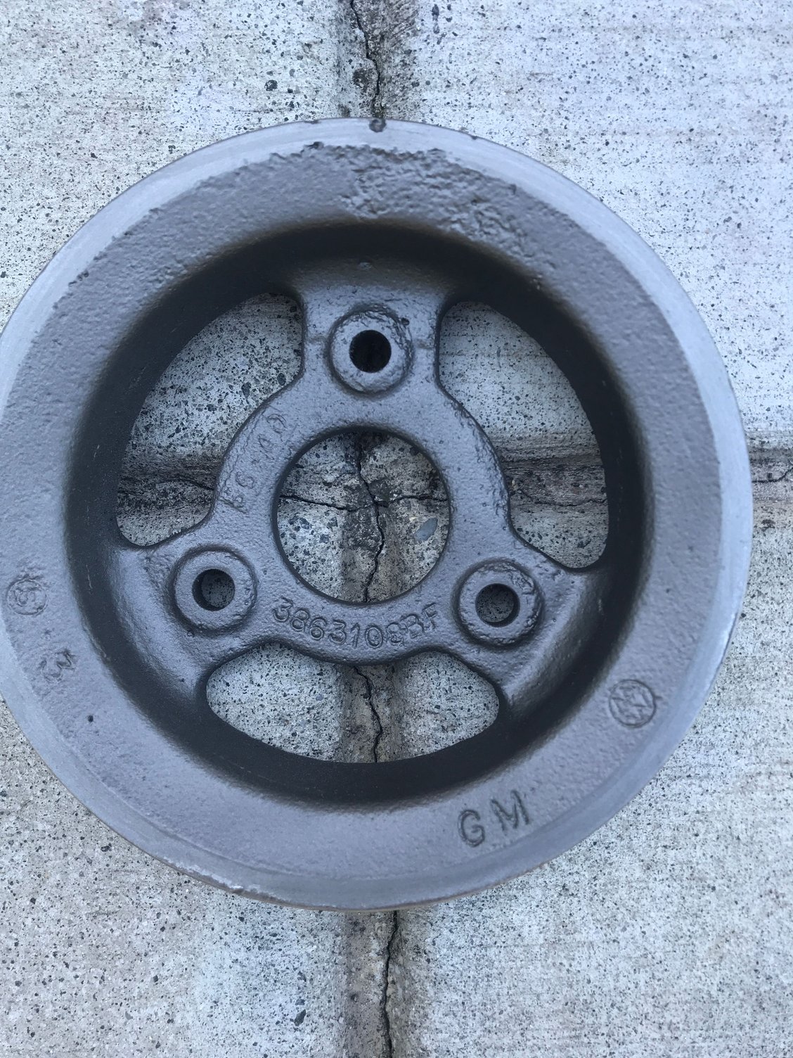

Does this seem like (or look like) the (cast) pulley you had to purchase for the harmonic balancer?

Yes, that's the pulley. It's too tall (diameter) and to wide to fit harmonic balancer, and sit behind front cross member.

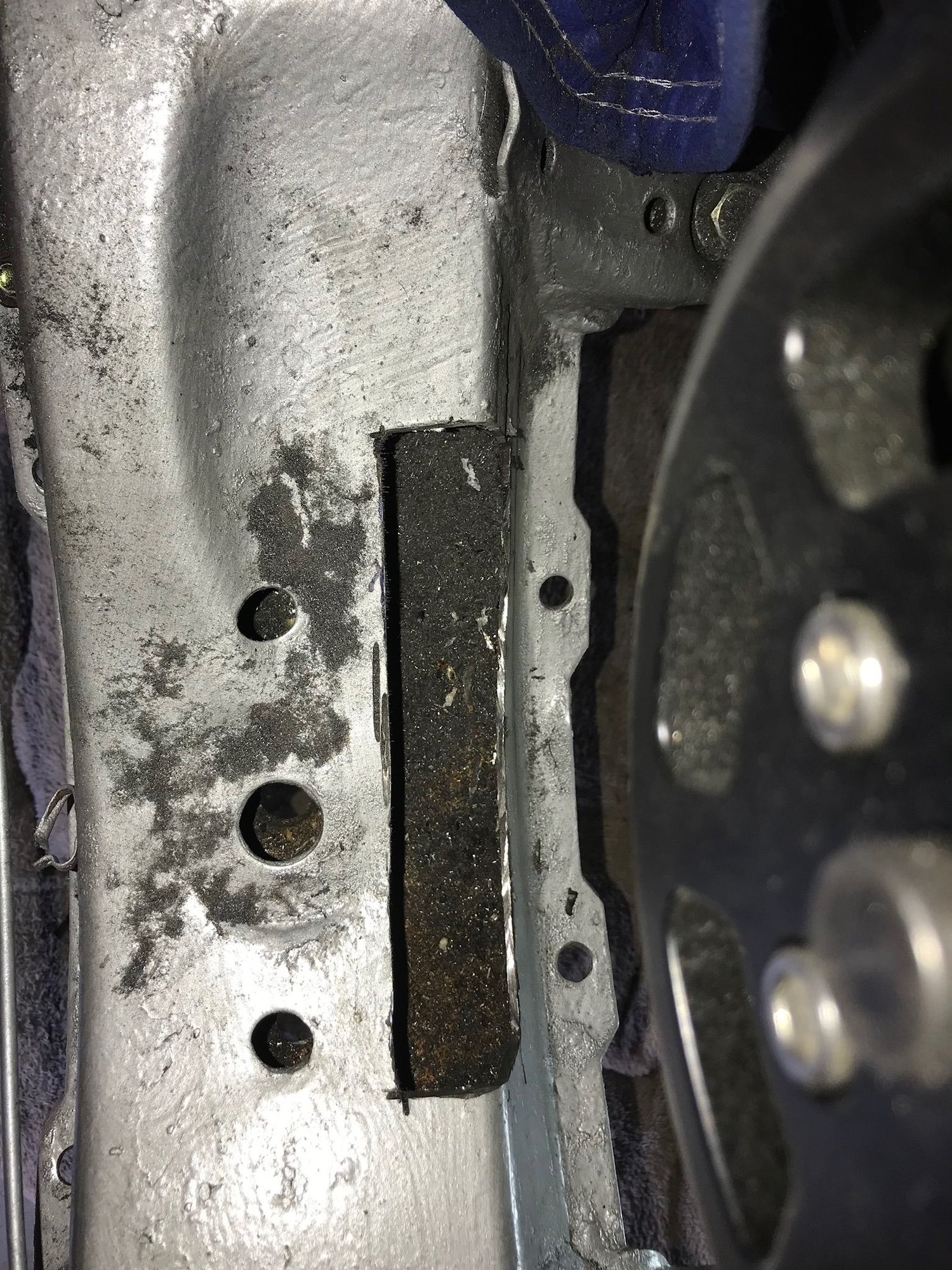

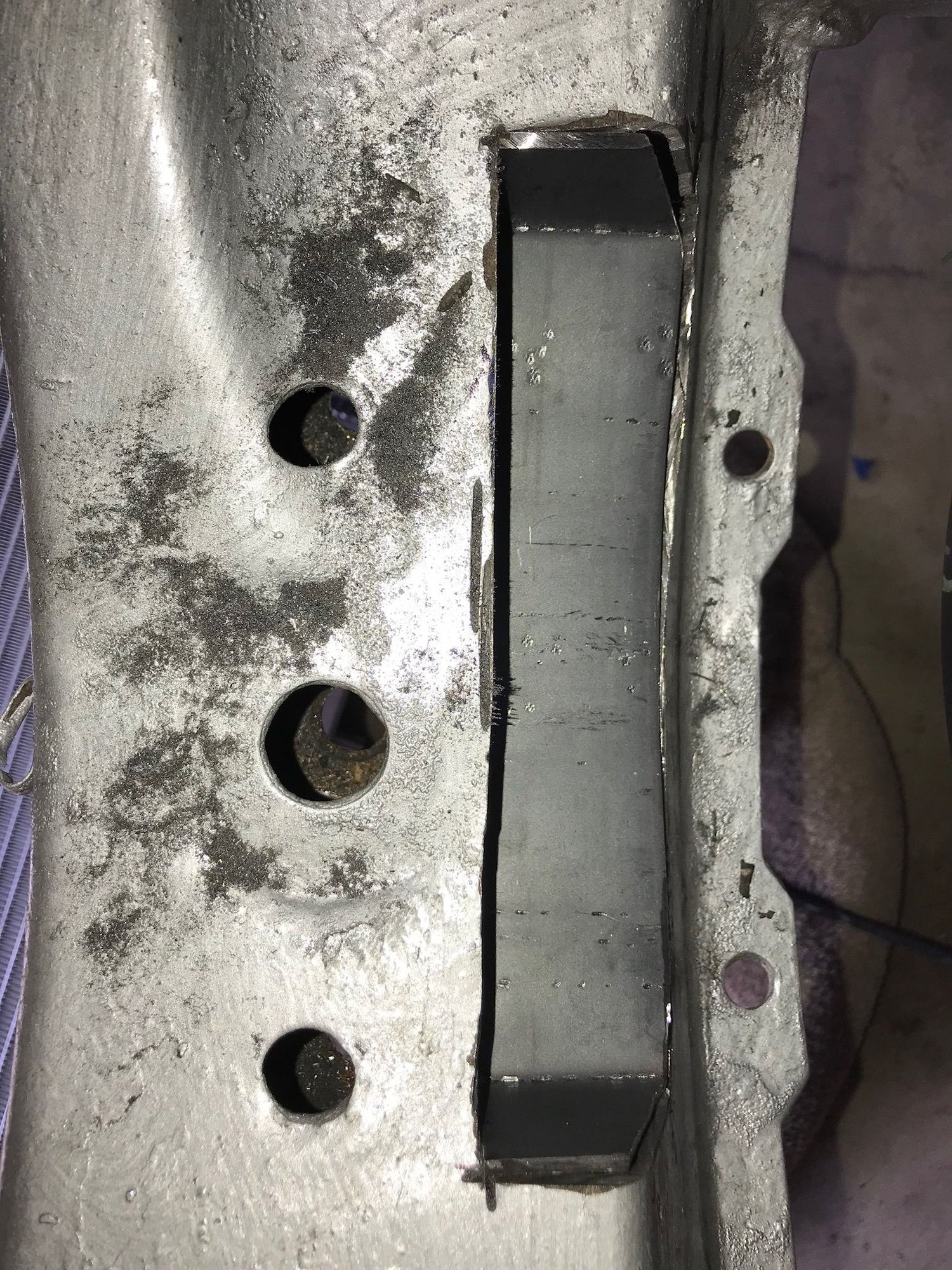

Larry, can you post a picture of the interference? It should clear the crossmember and provide enough space to change the belt. The pulley fits the notch in the front crossmember that all ‘65+ C2 corvettes have. Also, yes you have to cut the end of the steering column shaft for all C2 Corvettes except ‘67 which has a collapsible shaft.

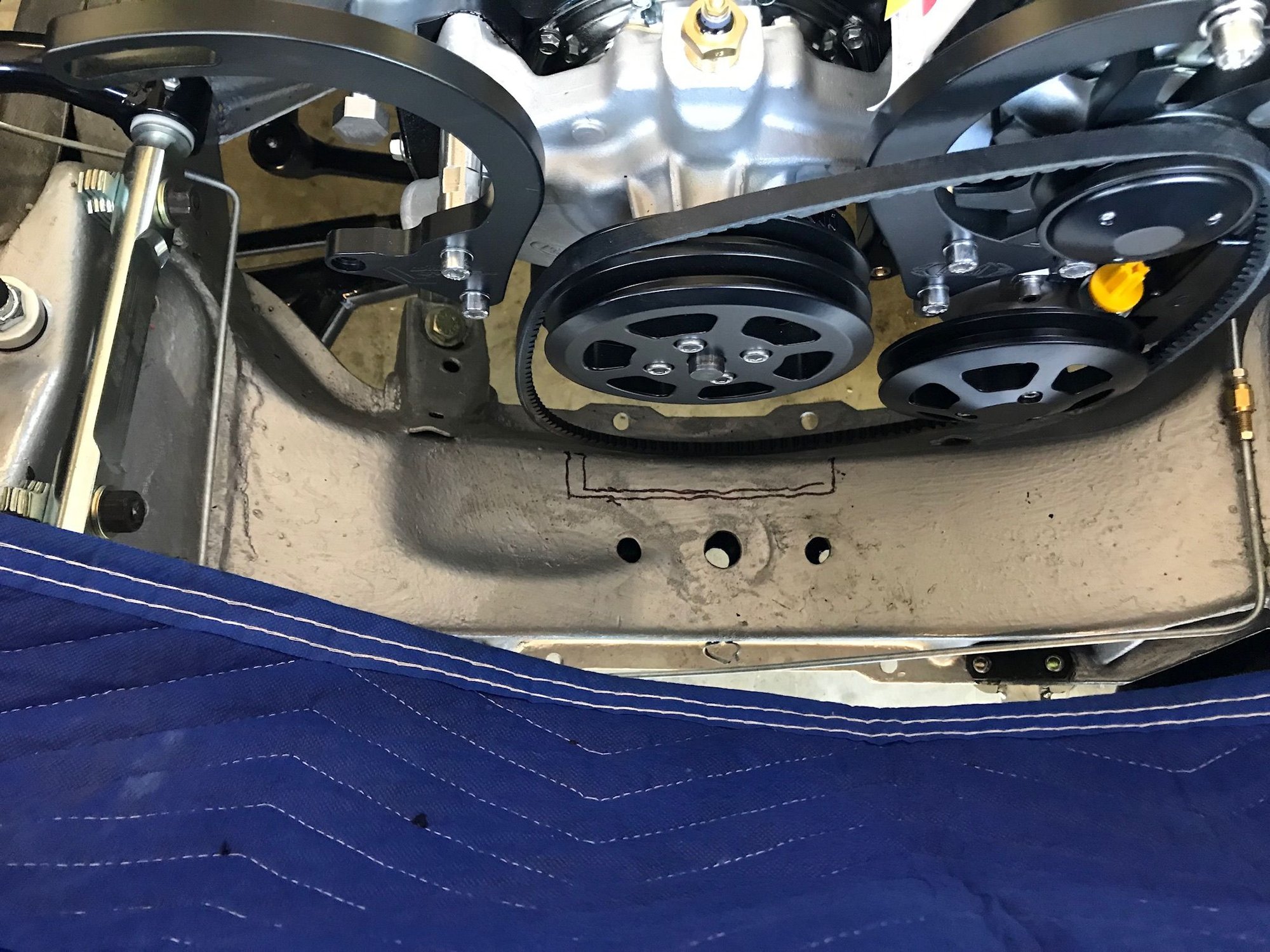

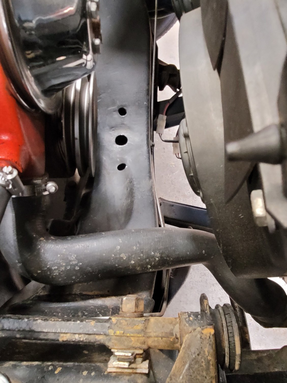

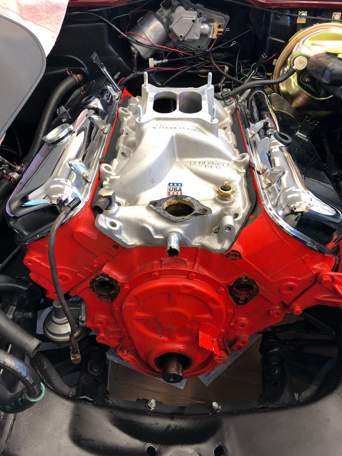

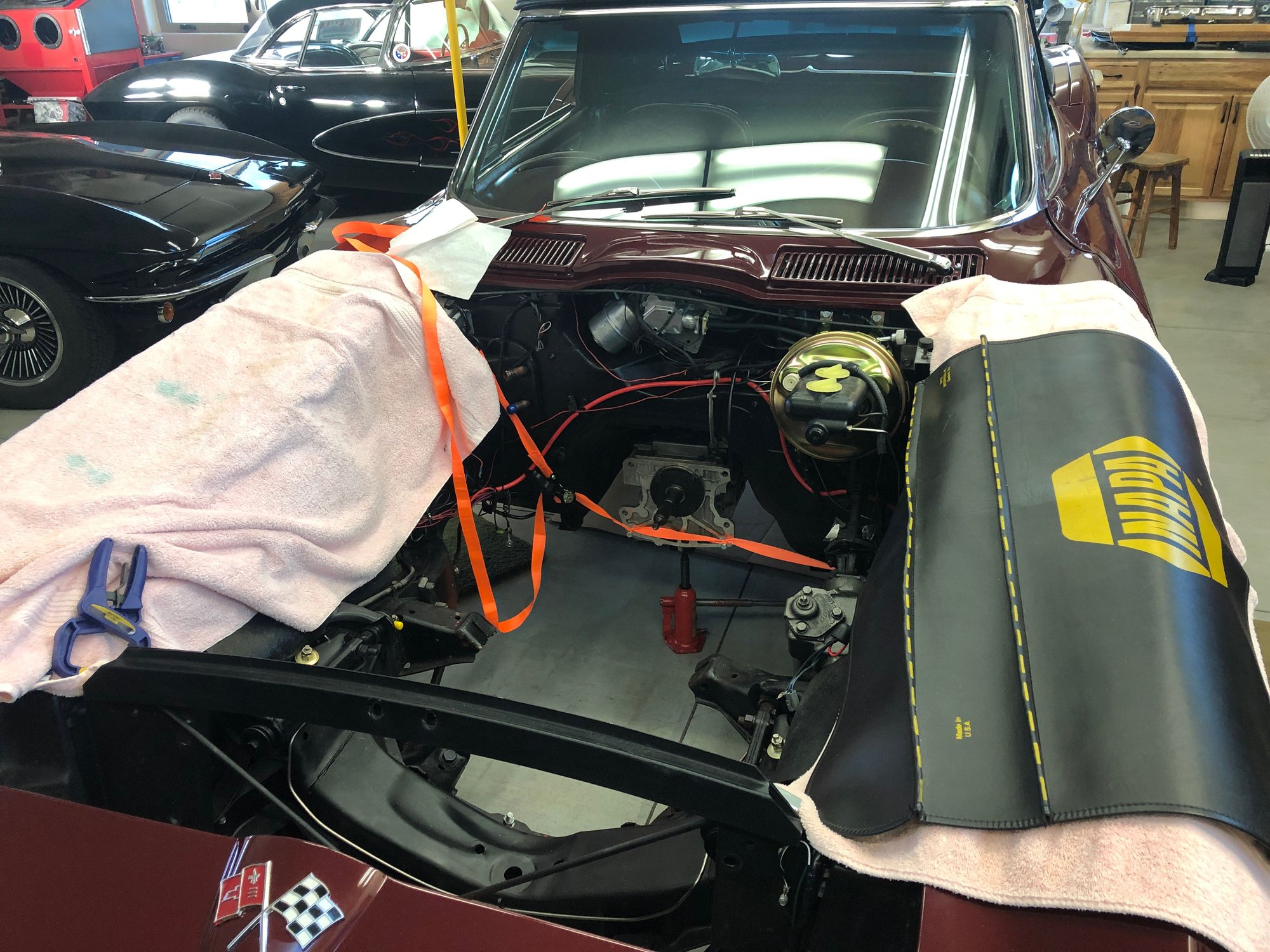

Here's a few pics from my 65 L78 Roadster showing the notch that Factoid is talking about that started with the 65 model year. All horsepower versions got it, not just the Bigblocks.
Mike T - Prescott AZ

Thank you for this information it is helpful. Unfortunately there is no notch in my crossmember. I'm going to have find a workaround solution.

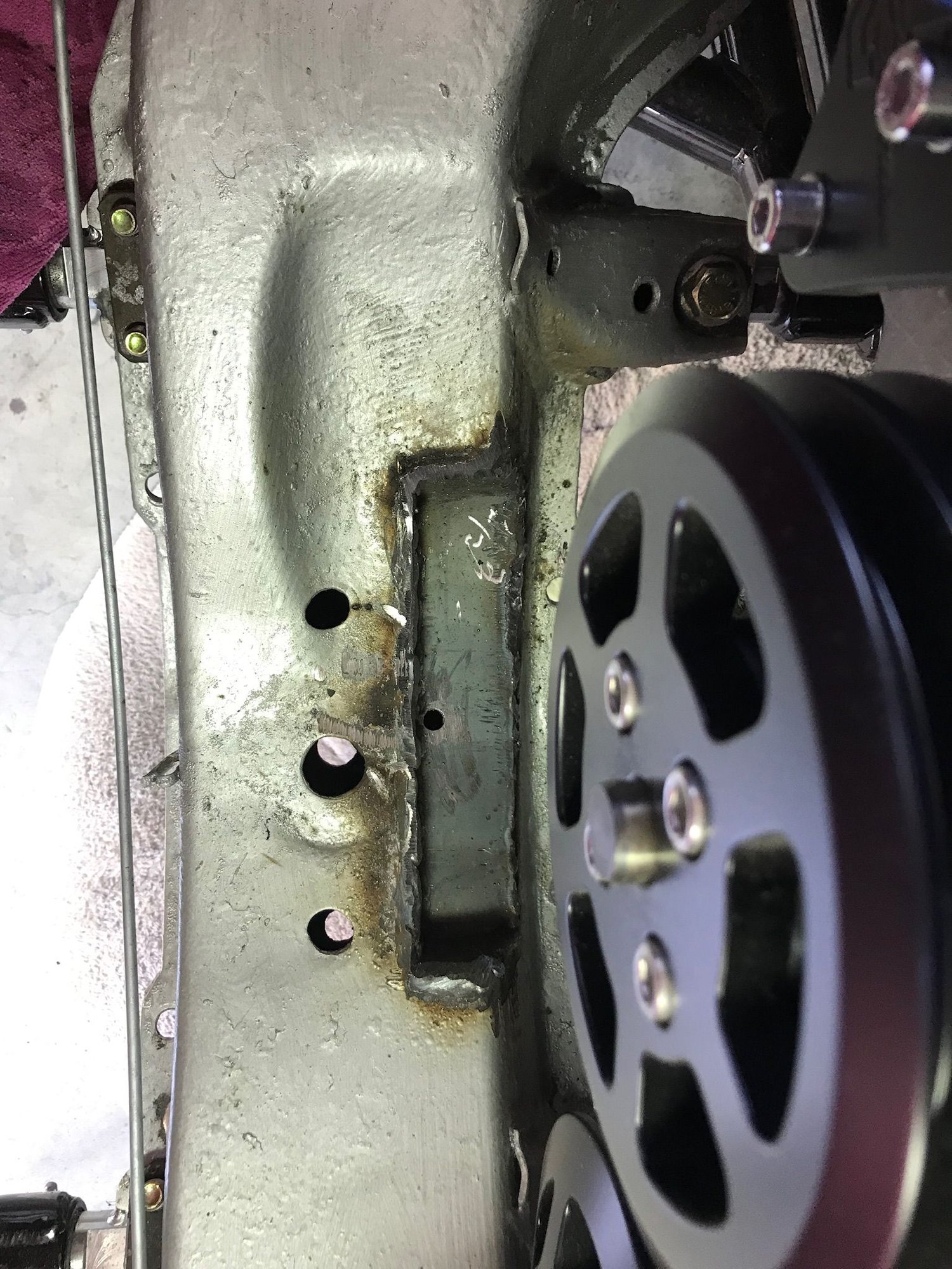

Here's a couple pics showing the pulley proximity to that front crossmember divot. I can just squeeze my fingers between the outer edge of the pulley and the divot.
I put GM power steering systems on both Bigblock Roadsters and as far as I know, there is no 'smaller diameter' crank pulley that could be used, especially since it's a double pulley.
Before you started in on adding the PS, I'm guessing you had a single crank pulley but it had to be close to that front crossmember even then.
Any chance someone swapped out frames on your 65 some time in the past?

I have no knowledge of any frame work done on this car, I purchased it several months ago. As I look at the pictures of my crossmember compared to your crossmember it looks like the notch starts at bottom by my hose then it was smoothed out of the cross member as you move up the page.
Looks like I'll have to find a new manual steering box that may provide some relief over the original?

Larry - If you happen to have a magnet handy, next time you're messing with your 65, try laying the magnet down in various areas that would normally be where the divot
would be and let us know what you find. The pics you posted have some 'uneveness' to that center part of the front crossmember. Could just be a distortion in the pic itself

That looks like a ‘64 frame in the picture. A picture under the car where the seatbelts mount by the driveshaft tunnel would help confirm.
I have a ‘64 and had to add the notch for my engine to fit.
it was not too bad to add but I had to remove a lot of the front pieces like the radiator and core support to get in there.
