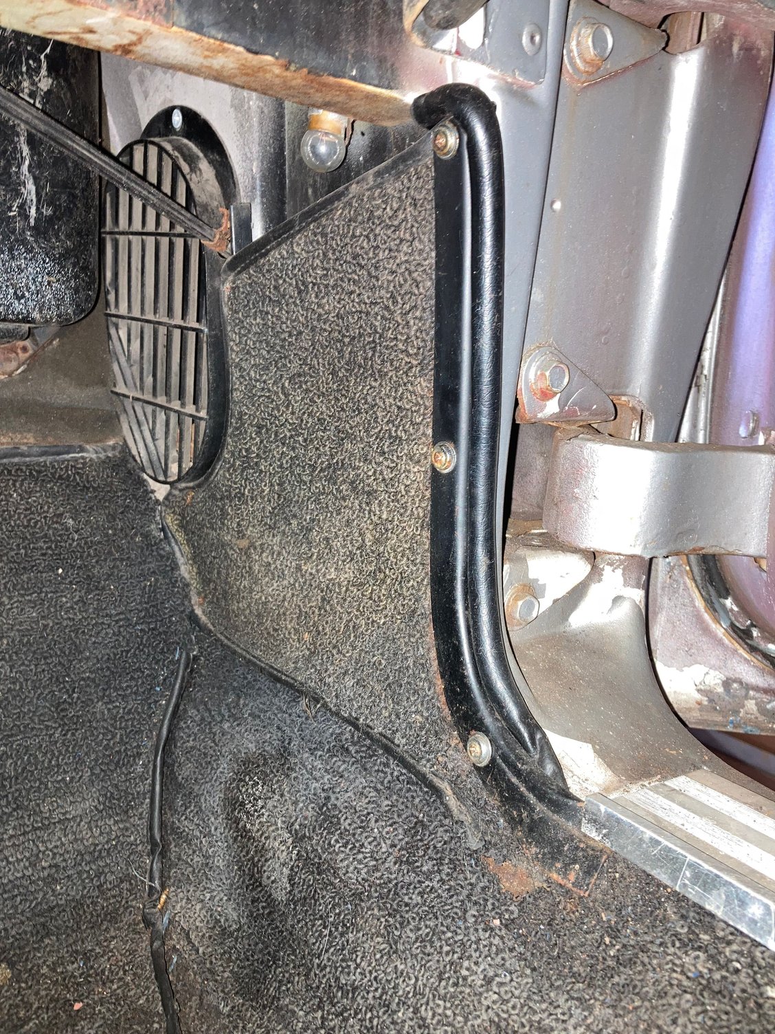

64 convertible, installing the kick panel carpet. I have two types of screws. 1 has a large somewhat flat head about 3/8” in diameter. There are 8 in the package, 4 for each side. There are 6 phillips head screws and 6 cone shaped washers, 3 for each side. My issue is the cone washer and screw doesn’t fit on the metal trim piece where 3 screws match up numerically with 3 holes. I think the supplier reversed the proper count for each fastener. Does someone have a good picture showing which screw goes where on this carpet?
Found part of the problem. I received the 65-66 screw pack. 63-64 has 8/4 to a side flatter heads. No listing for the three holding the metal trim.
For posterity should this question be asked again: 63 (same fro 64)
4 phillips with cone washers, 3 large flat head
