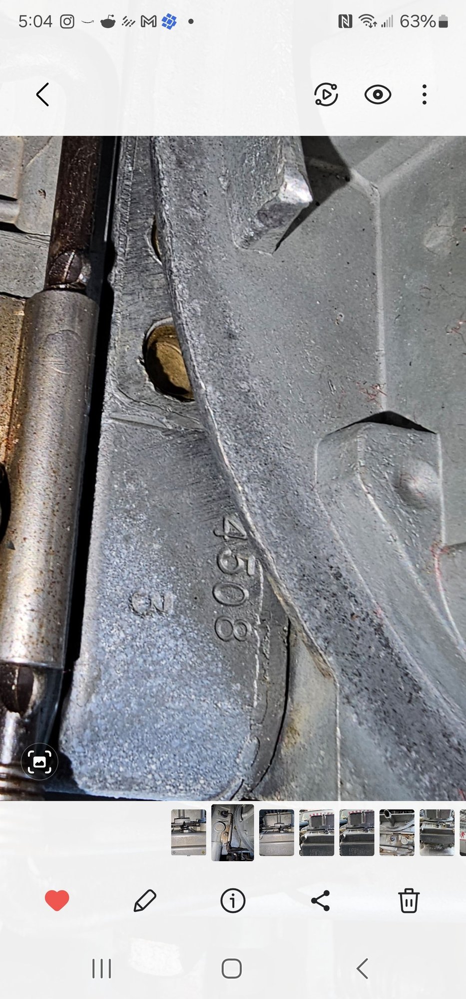

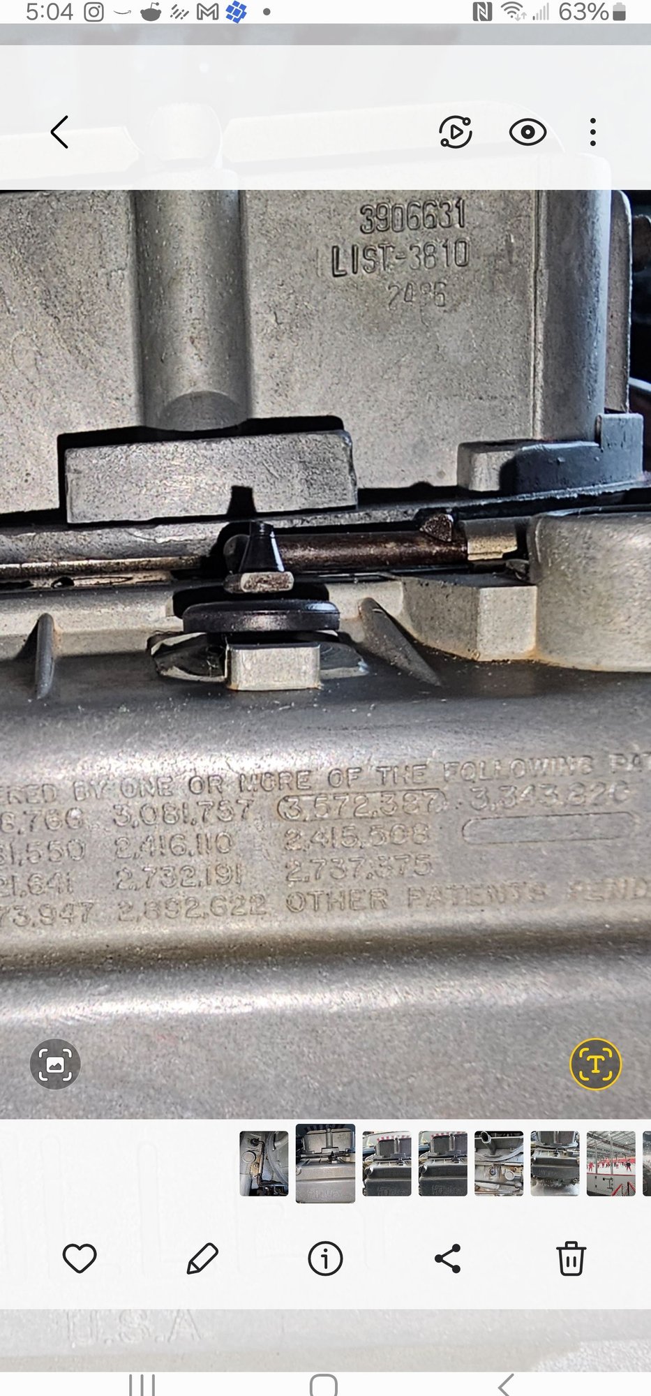

So I did the easy fix, removed front and rear bowls, cleaned, and made sure the floats were free. Leak continues, so I would like to rebui;d this carburetor, only I am not sure what it is. Any help is appreciated.

Where is it leaking from? You have a correct 67 SB 49 state carb but made in 1976 or 1986. It's a Holley 4160. You need to check to make sure all mounting areas are flat and true.
