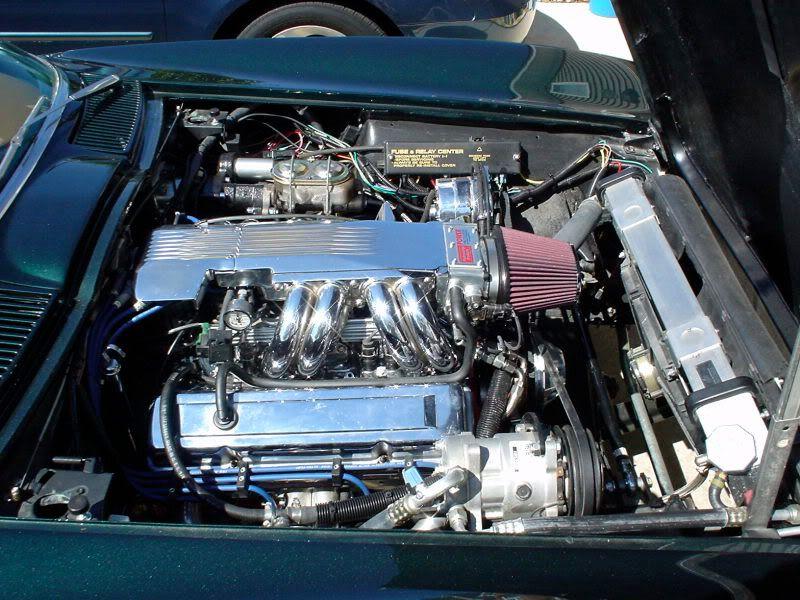

This was my 63 when I found it. Hopefully you can make out the white tie wraps if you look hard enough.

Looked like this when I finished it. Has since been reconfigured and put on SRIII Motorsports chassis with LS power.
