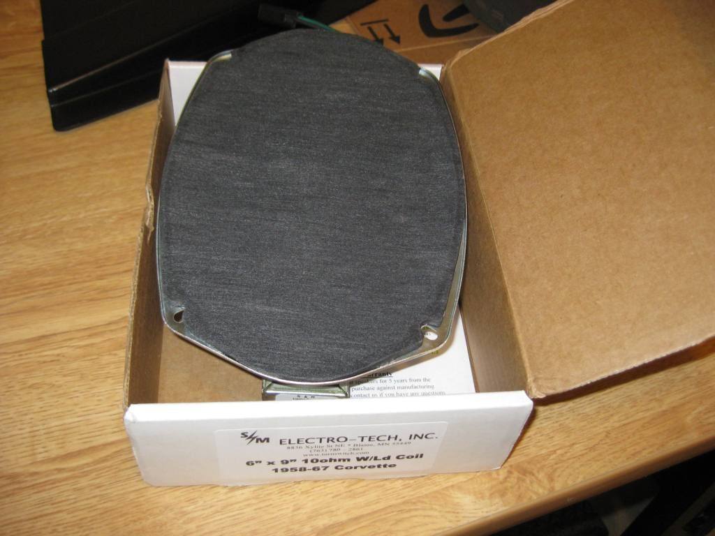

Corvette central or Zip for Corvette only parts. You can get a 10 Ohm speaker any where place that sells automotive radios and speakers.

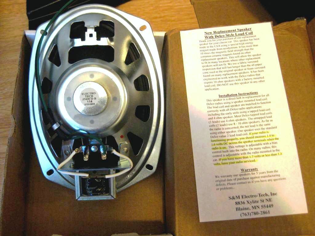

You'll need something similar for compatibility with OEM radio - ~8-10 ohm impedance; certainly not 4. Not sure if Electo - Tech is still a source, as the long time owner-operator passed away a few years back. It's a good starting point for you. And ...

Tape player?? So, what radio do you have in the car...must not be a stock radio. Which generation of Corvette do you own? What year? Need more information on the radio you're using.
BTW, S&M Electro-Tech is still in business and is know for their quality products. Link below.
https://www.smelectrotech.com/produc...&category_id=9

The original radios were designed with a power transistor that required a matching impedance speaker of 10 ohms along with the coil mounted on the original speaker. If you use any other speaker design with the original radio, it will most likely overheat the power transistor and it will fail. An 8 ohm speaker can be used for a short time for testing, but is not recommended for the permanent installation. A 4 ohm speaker will most likely overheat the transistor in a short time. I would not try the 4 ohm even for testing.
That said, I am not a radio expert, so you can roll the dice if you so chose.
Was your original speaker bad? Is it an original Delco radio? Did the radio ever work since you have had the car? What is the 8 track? Sounds like you have an aftermarket radio in which case all bets are off. Look on the back or top of the radio on most radiors for a tag or stamp that will tell you 8 ohm, 4 ohm or 10 ohm speaker.
