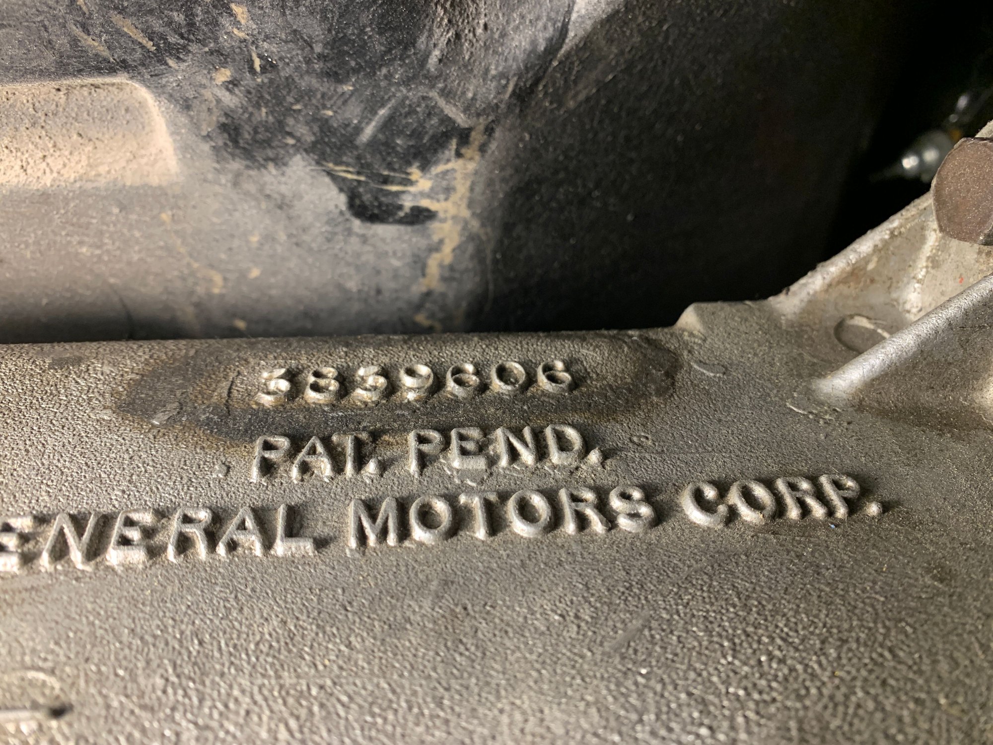

Hello
i have a casting number of 3839606
How do I tell if M20 or M21?
thank you
john

I believe the 3839606 casting indicates a 63-64 Muncie. Do you have a pic of the input shaft? Going off memory here...not always a good idea, an early Muncie with no 'Rings' cut into the input shaft means a
wide ratio while a single 'Ring' meant a close ratio. There are quite a few members with far more knowledge about how to decipher a Muncie than me and no doubt they'll respond shortly.

63 muncie is a one year ONLY part. What year is the car ?

Weren’t all early Muncies coded M20, wide and close ratio? Out of the car, mark the input and output shafts, put it in first gear, and rotate the input until the output makes one complete turn and count how many turns were required of the input 2-1/2 (WR) or 2-1/4 (CR). Probably easier to count the input turns for 2 or 3 complete turns of the output to get a little larger distinction between the two.

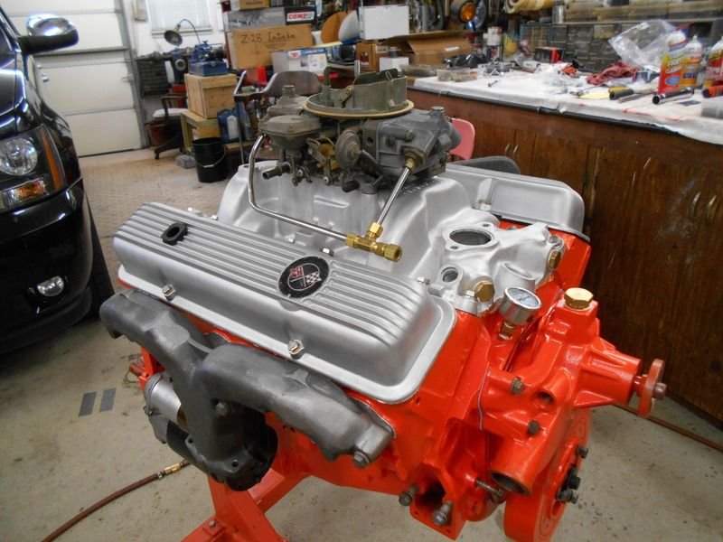

The WCFB is a good, simple, dependable small 4bl carb. The 2x4 versions are about 385cfm each (770 total). Not quit as good as a professionally dialed in Holley or Q-jet(be careful when you bad mouth a Q-jet).
But a trick Holley just does not have the magic image as a well built 2x4 setup. And the early 2x4 intake bolts right up to any first generation small block and performs great.
I have a 57-61 style 2x4 setup on a 389 in the 51 Chevy with an M20 and 3.08 posi. Excellent combo!

The following is NOT, repeat, NOT from me. This is research/observation by Alan Colvin in his book CHEVROLET by the Numbers 1960-64.
OK, I will try to cover some things that have been asked.
In the early years of Muncie production there were a few oddball main cases.
The "normal" and most common 63 case is the 3831704. And as a performance Muncie version, it is the least desirable.
Another early 64(Aug 63) oddball (VERY rare) main case is 3839606. I have never personally seen a 606 case, BUT, I would guess it had the 64-later larger front bearing and bearing retainer as used in all 64-74 Muncie main cases.
The MOST COMMON, and best known 64-65 Main cases (VERY common) are 3851325. I have a few.
An oddball 65 case is 3864848. I have never seen one, and have no clue how many were made.
The 010 cases were 66-67. The 660 cases were 68-69 (MAYBE 70). The 661 cases were 71(70?)-74
The OPTION CODE for a 63-65 4sp was M20-------------THERE WAS NO M21 OR M22 option code. The M20 installed in any car was either referred to as a close ratio or wide ratio (and still is by some folks today).
For the 63-65 cars with an M20 Muncie, the determination as to whether it was a close(2.20 1st) or wide(2.56 1st) ratio, WAS DETERMINED AT THE FACTORY, DEPENDING ON ENGINE OPTION AND REAR AXLE RATIO. NOT, repeat, NOT THE CUSTOMER.

So we can say that my ‘…606’ casing is an oddball casing and that’s about it unless we see the internals?

For sure, the 606 848 main cases are quite rare. Over the years, I have sorta known of them, but never had one on the workbench. I am not a big Muncie rebuilder because I do not want to be covered up. I always have plenty to do without being covered up with a specialty.
Since I have never had a 606 or 848 on the workbench, I am not aware of any specific or different features about them as compared to the 325-010-660-661 cases.
SOOOOOOOOOOO, if anything and every thing that fits inside a 325 case, then you should be fine.
Now, with that said, the 63-65 Muncies are considered to be less desirable because the smaller 7/8in cluster shaft. I have had several 325 cases bored out to accept a 1in shaft. To convert a 325 case to a 1in requires using the 66-later type input and cluster gears. Everything else fits. BUT, the 63-65 and 66-74 synchronizer hubs and brass rings are different. One thing I do is upgrade the 63-65 syncros to the 66-74 type.
