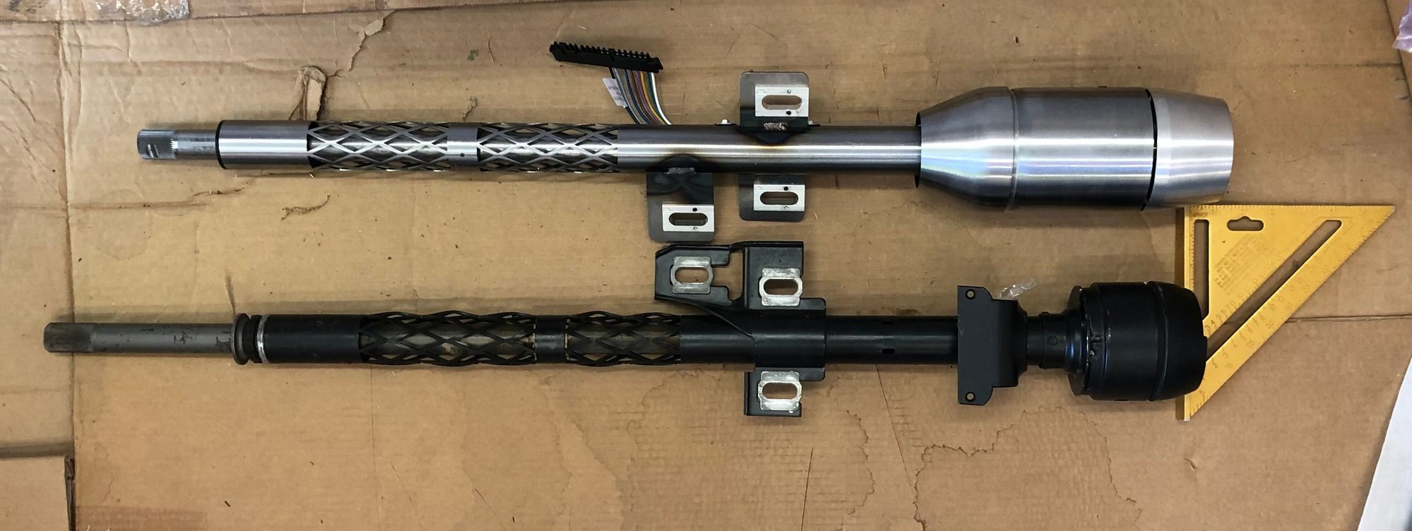

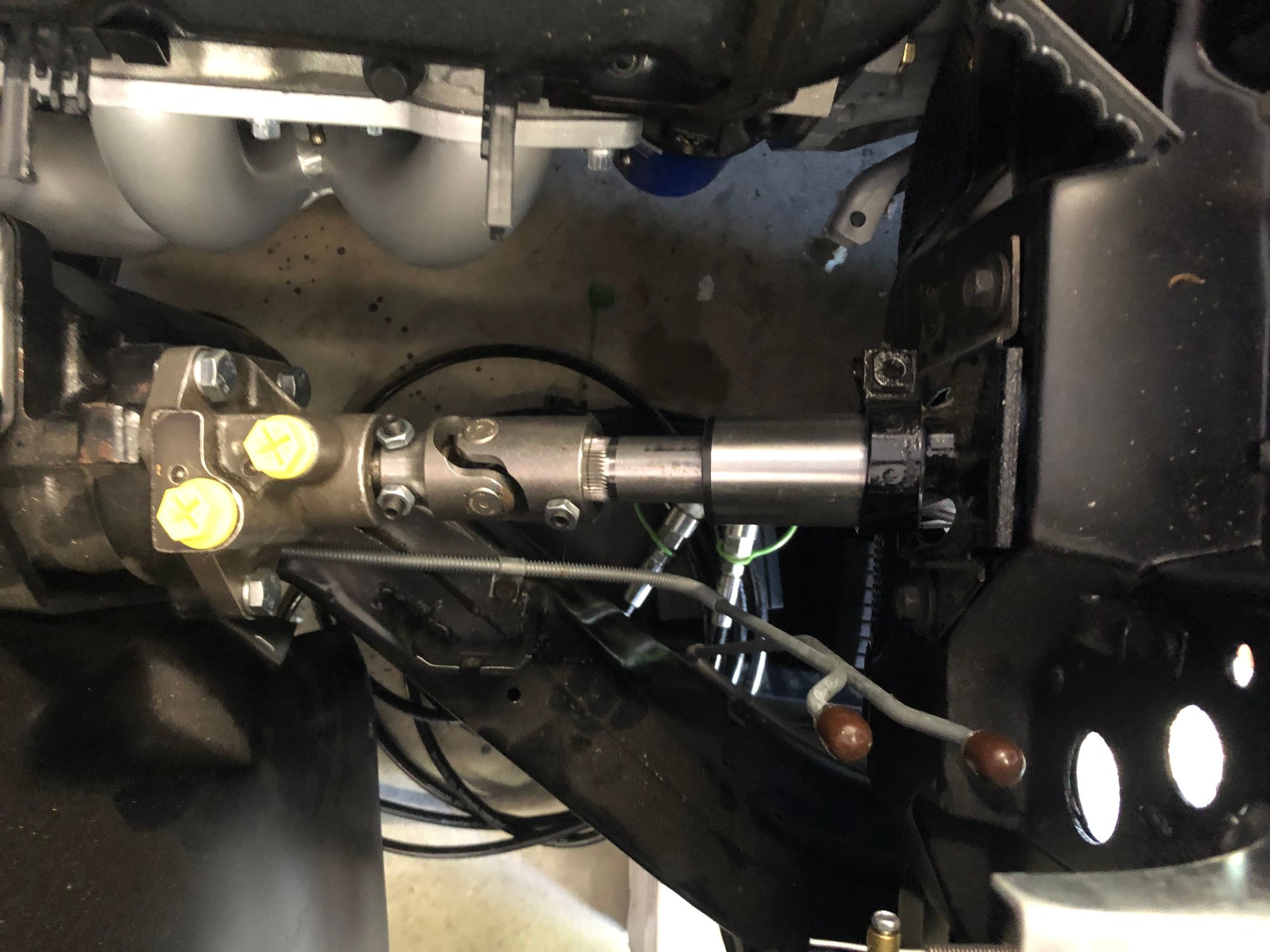

I don’t believe they have them precut since there would be variations on if you use a u joint or rag joint and how close do want your wheel to the dash. I had mine custom cut from IDIDIT.

What did you have custom cut? The center shaft length only or the whole column length? Are you using the double ujoint?

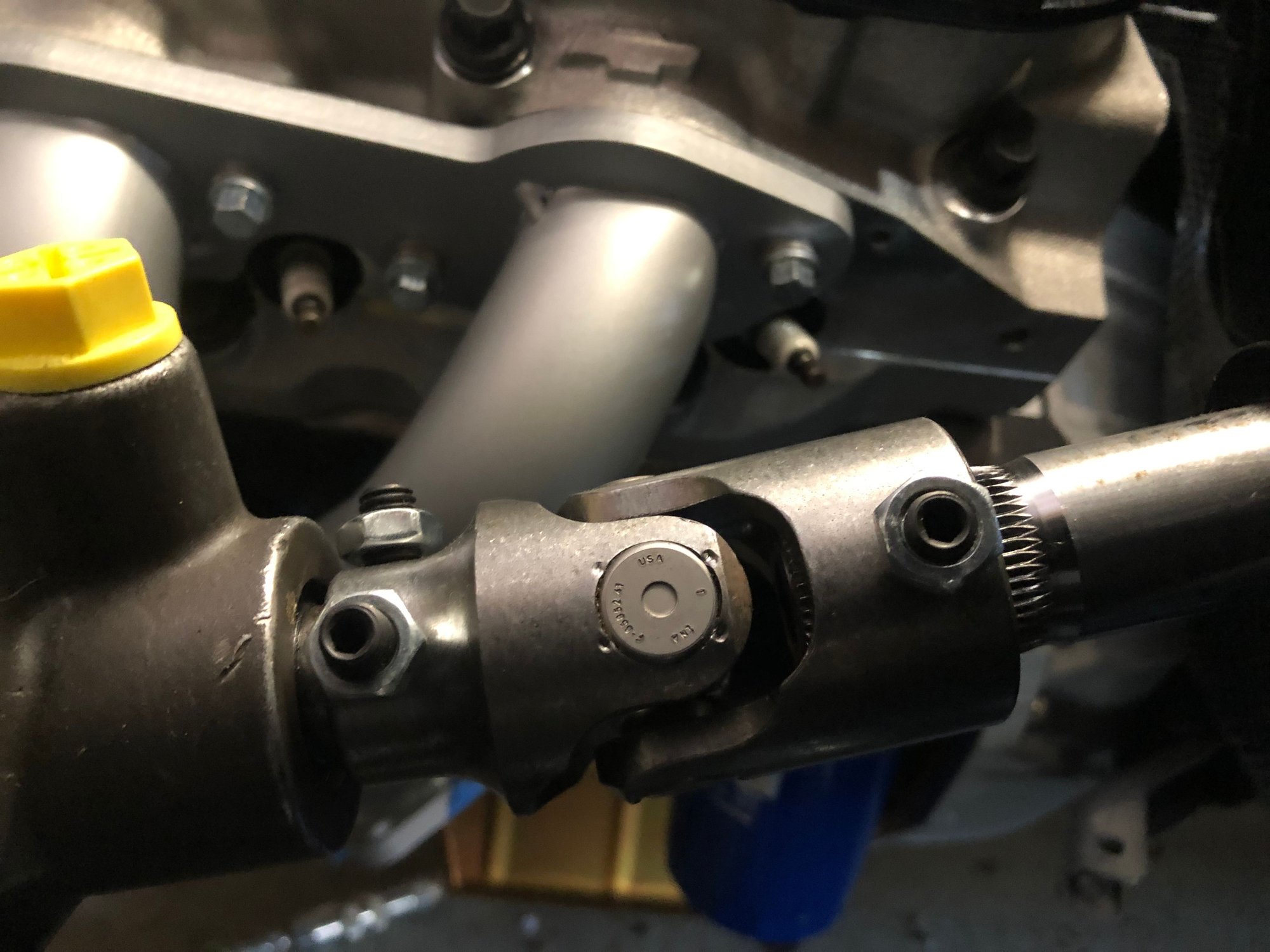

Hi Tom. I told them the length I wanted and I guess they just cut the shaft. I am using a ujoint as I didn’t like the angle on the rag joint I had with the stock column.

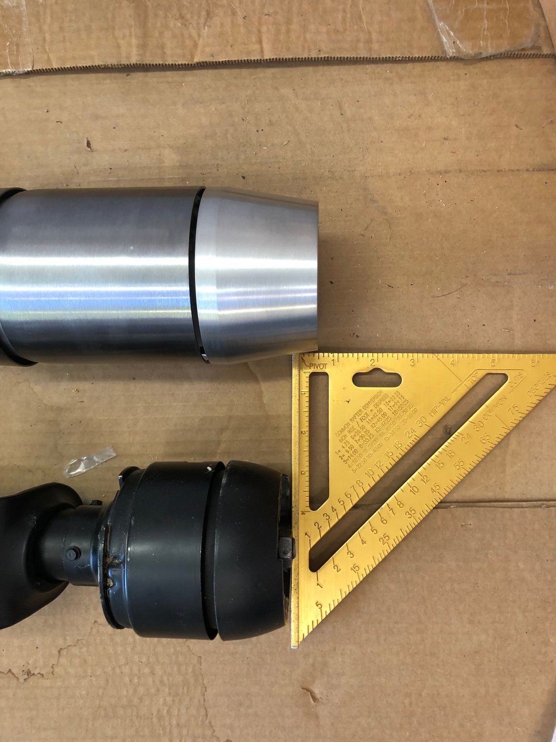

OK. I see. I was thinking r&p not a box. Setup is different. Just an FYI. I use an IDIDIT column and an early Camaro hub. It may be the same as a 67 hub I don't know. Anyway it fits the column fine and as your pic shows it moves the steering wheel closer to the dash.
