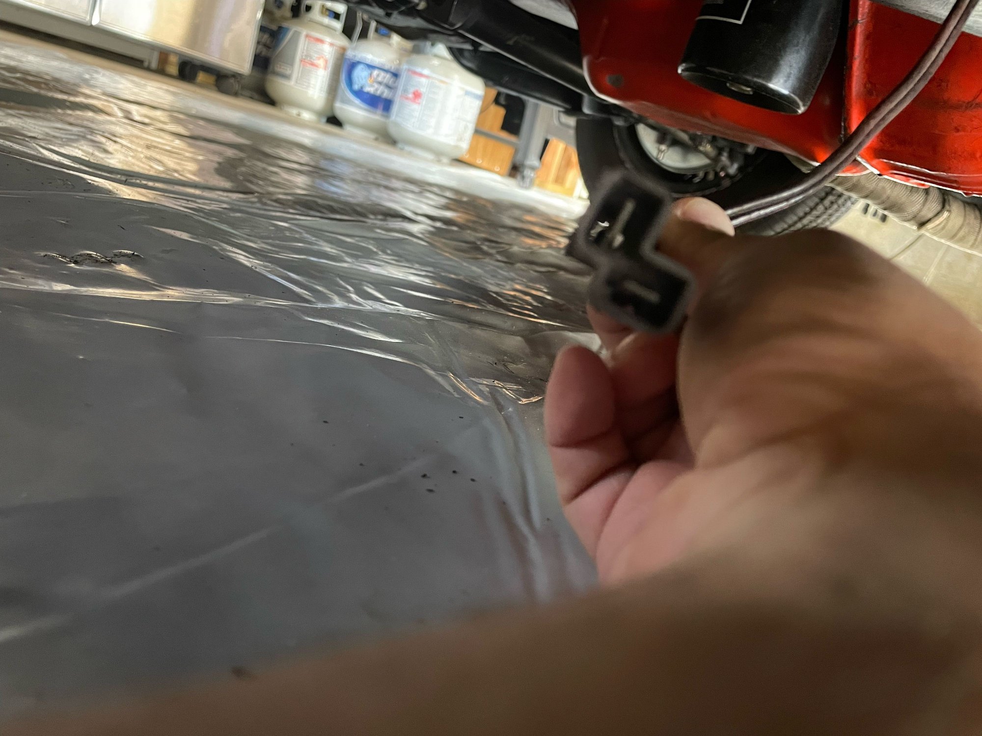

Can anyone help identify where this wiring harness plug attached to? Happen to see the green and red wired adaptor hanging down underneath my '67 327 A/C this morning. Also, everything is running fine (gauges, lights) that I can see.
Thanks for any help!

Back-up light switch on the transmission.

You will find the mate to that connector on the firewall just above the ballast resistor.

Thanks R66 - Found the mate and reconnected. Thanks again for the fast replies and help!
