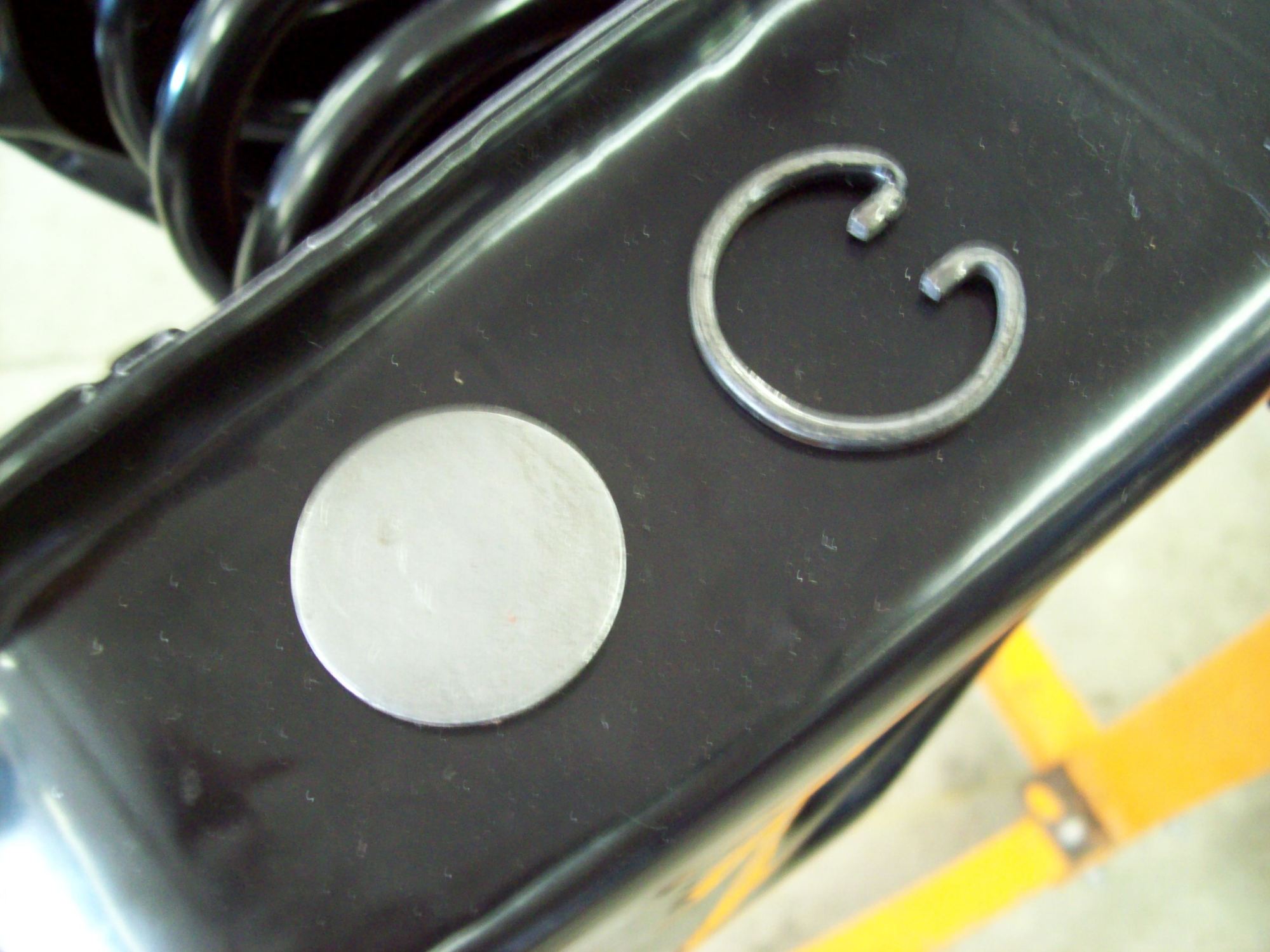

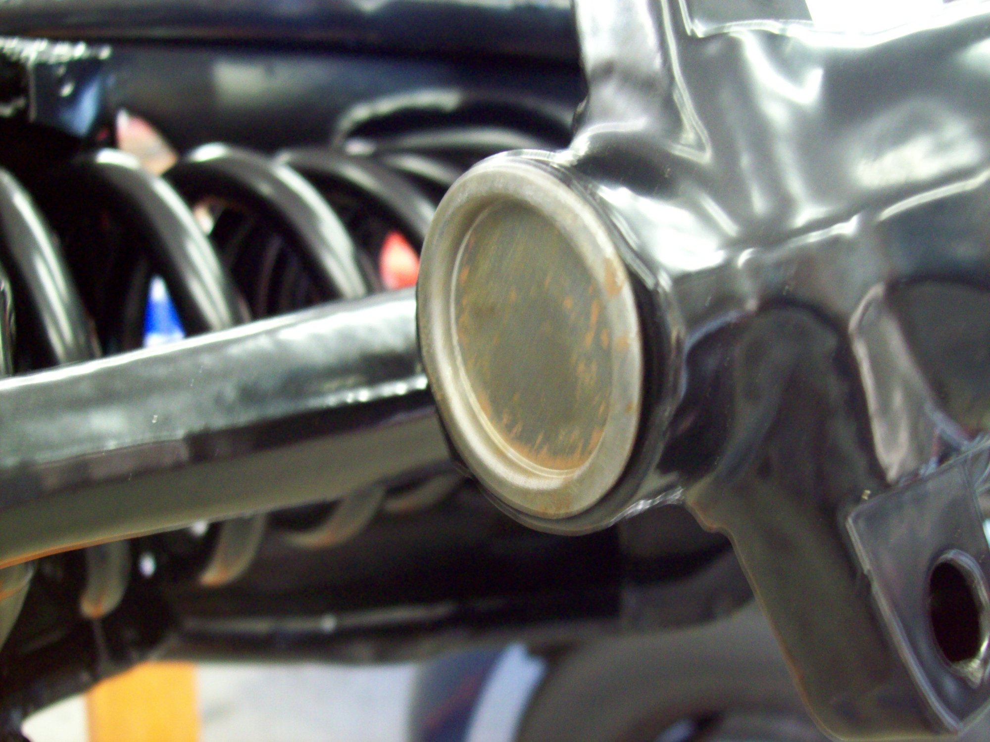

The welch plug that is installed UNDER the snap ring, and the cap that SUPPOSEDLY fits on top of the spindle bore are two different plugs. I have never come across a good, tight fitting cap for the top of the spindle bore.
This is the welch plug and snap which is installed in each end of the spindle bores.
This is the welch plug installed, BEFORE the snap ring is installed.
Then the snap ring.
