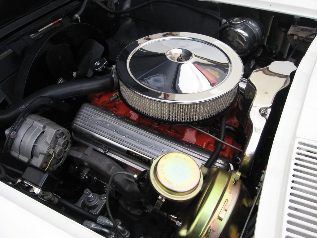

Don't know about 63's but later cars had a notch in the hood for clearance for booster...
NOT MY car or PIC borrowed from the internet...

Originally Posted by anyChevy
You can just add a booster if you just want power brakes.
Its this a 63'? Is so, any hood clearance issues?
Old Aug 5, 2024 | 10:35 PM
anyChevy's Avatar
anyChevy
Joined: Apr 2011
Posts: 1,611
Likes: 395
From: Australia
Thats a 66
So if you're retaining a single reservoir M/C you should have no clearance problems.
If going with a dual reservoir M/C ? You may need to space the top of the booster down slightly.
