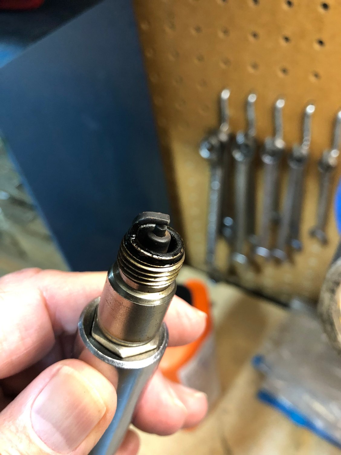

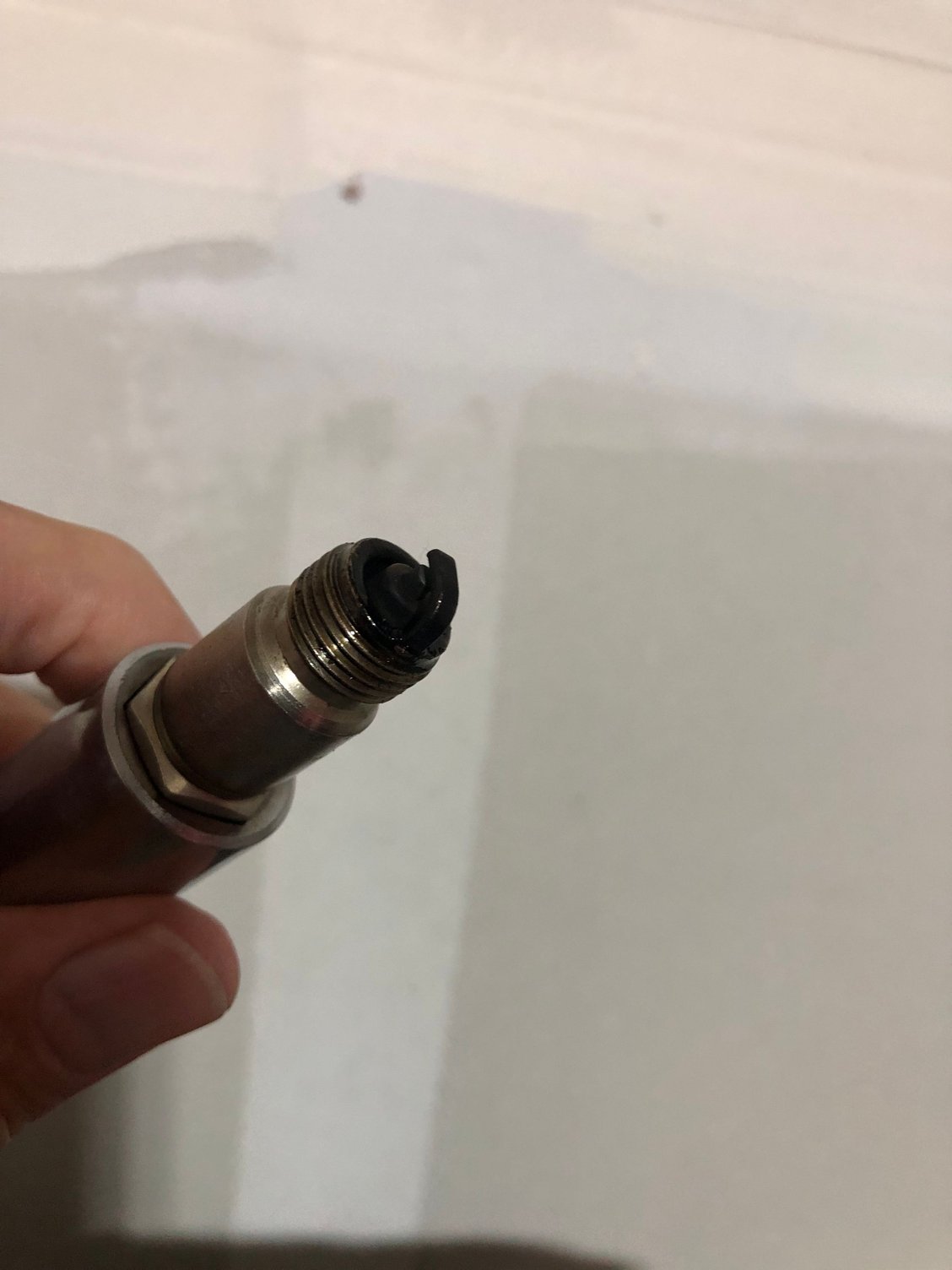

Here’s a couple pics of what plug look like cold. As I said, when pulled hot it is clean of any oil, although it is somewhat black from running rich and I suppose burning off the oil? Probably the valve seals as mentioned, so I may wait to see if things worsen. Thanks for the responses.
John

Update-
Well, after reading Drummer Boy’s thread, I did more investigating. No, I don’t have aluminum heads, but I did have oil wicking up around the intake bolt on driver’s side, above cylinder #1. Pulled bolt, cleaned it and applied a liberal amount of thread sealer, and leak issue is gone, plus plug is staying dry! I don’t fully understand the whys of this, but issue appears to be resolved. Maybe oil leak at manifold created enough of a vacuum leak to cause this? Also, I noticed that I didn’t have gas dripping from my carb pump nozzles after a hot shutdown. Coincidence? Who cares! Thanks again for all the advice.
John
