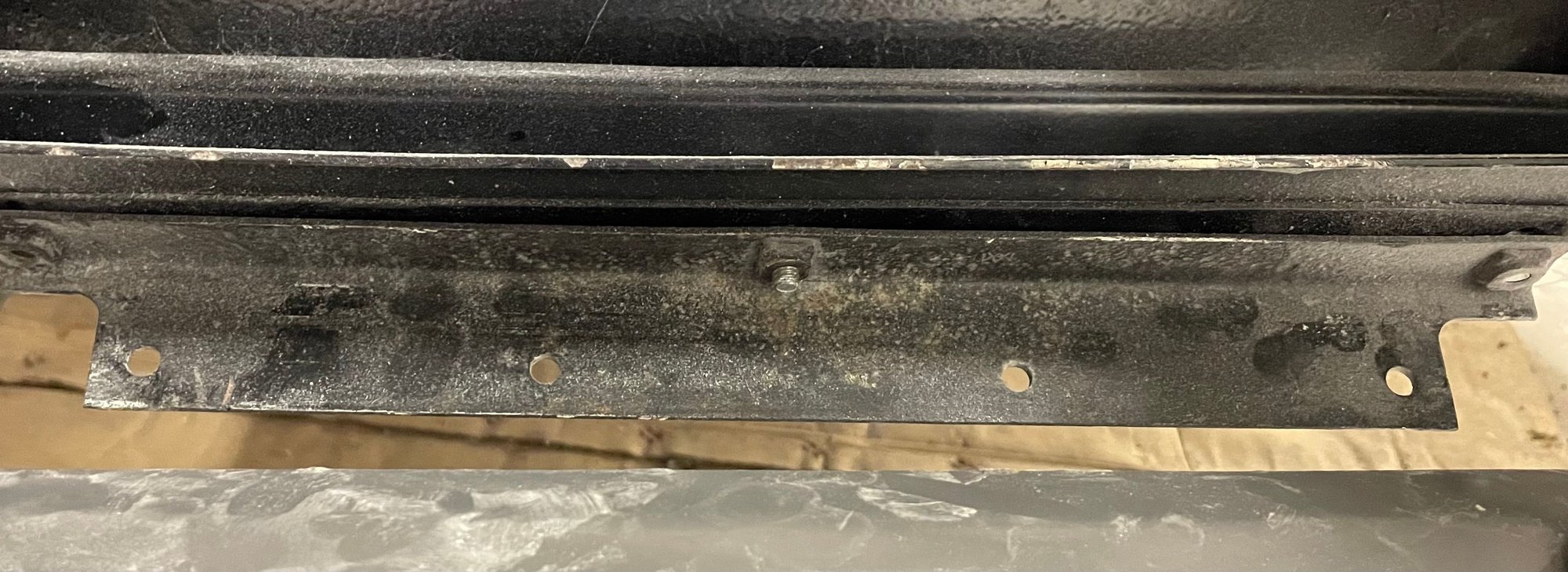

Need a pic of baffle mounted to radiator bracket
58. Glass on top or under radiator 4 bolt bracket
Thanks.

The three bolts have nuts welded, the 4 are just holes. Does that lay on top or under baffle edge?
Thanks
Thanks
Those four holes should have weld nuts in them, looks like they may have been drilled out. Fiberglass baffle mounts under that bracket with bolts into the weld nuts.
You may have the bracket upside down as well. I'll look for a pic from mine........

Found one

This really helps.. now in makes sence. Are those vertical bolts on baffle correct?
Thanks!
If you are referring to the three long studs, no, too long. They hold the grill shell to the body and were just in there for mockup. This was after the car came back from being painted and I was test fitting everything and getting ready to do the black out.

I’m referring to the vertical screws that mount the forward edge of baffle
Baffle has "J" clips that the bolts screw into from the bottom.

Are there 3 of them?
I know these are basic questions. I don’t have my books with me
Yes, I believe so
