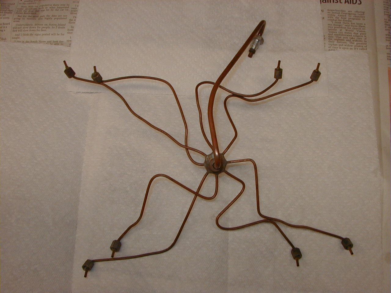

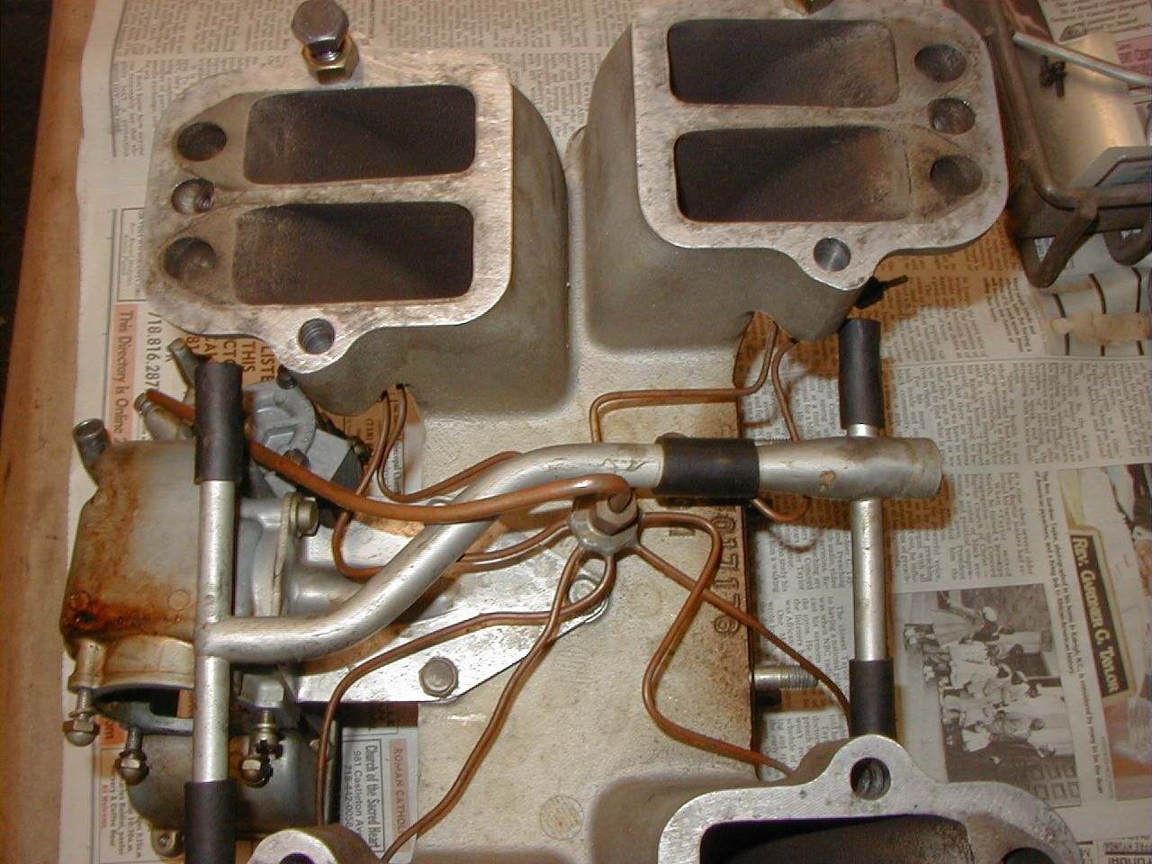

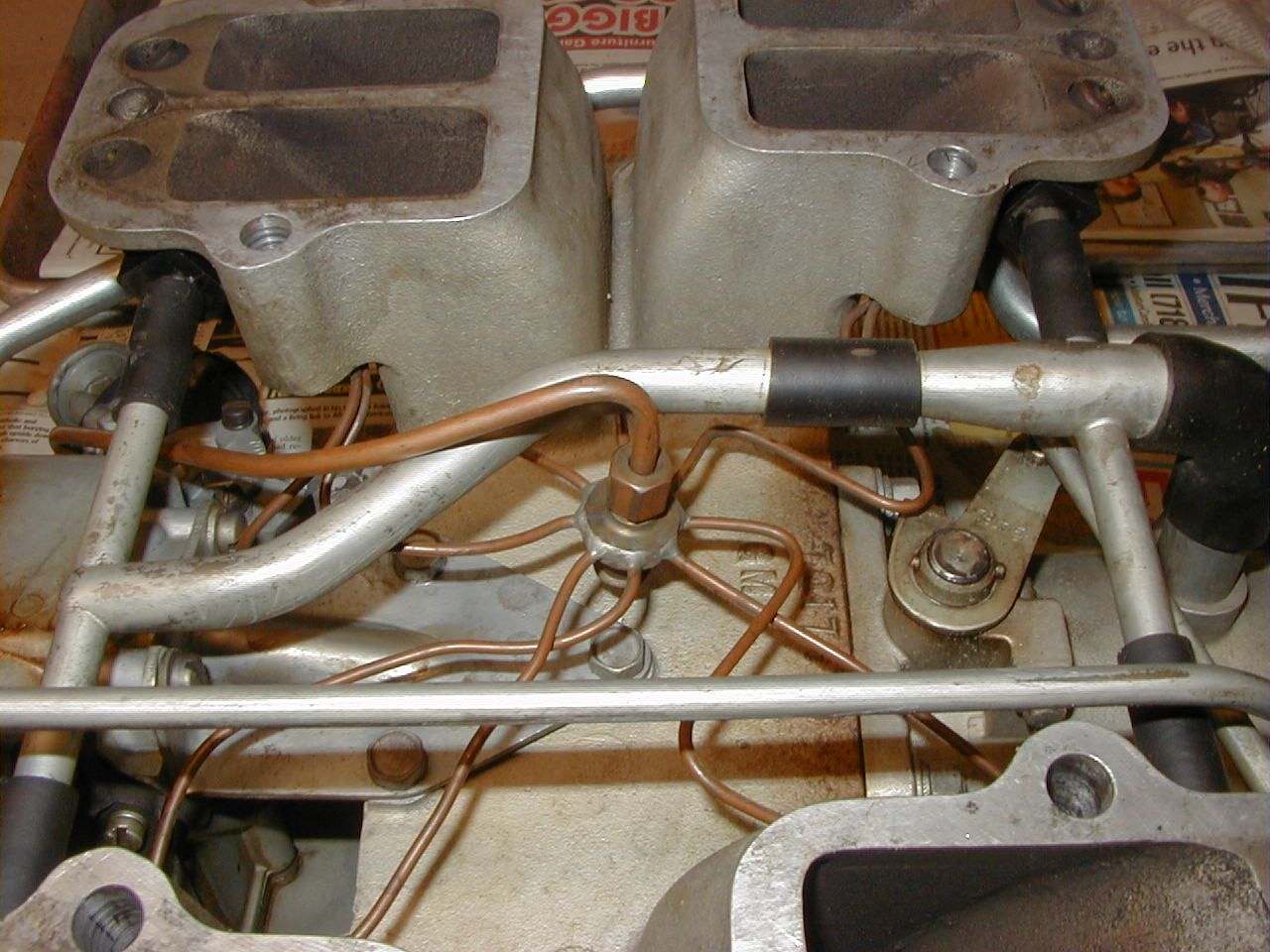

These are from my 62 unit.
To ‘62 FI fuel lines
