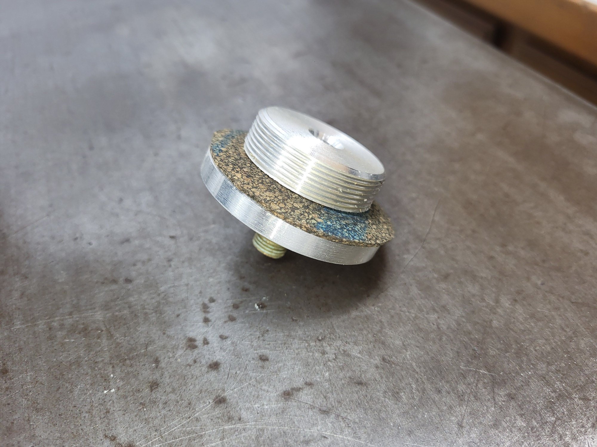

A few years ago I made my own brake bleeder and machined an adapter for the master cylinder on my car (same unit as on your car). It is essentially the same thing as the part you posted the link for and it works very well. Much nicer than using plates, clamps, etc.
Photo attached.
Ted

Thanks guys. I went ahead and ordered it, so I'll report back in a few days how it went on my C2.

UPDATE - It works perfectly. That is, after a quick trip to NAPA for a bigger gasket than what it came with.
