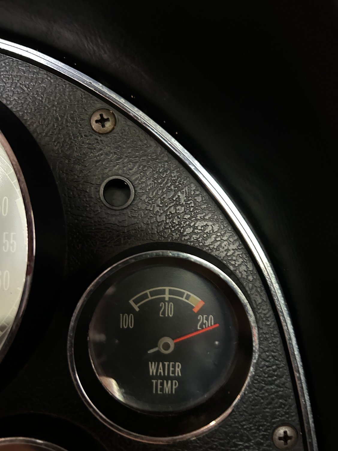

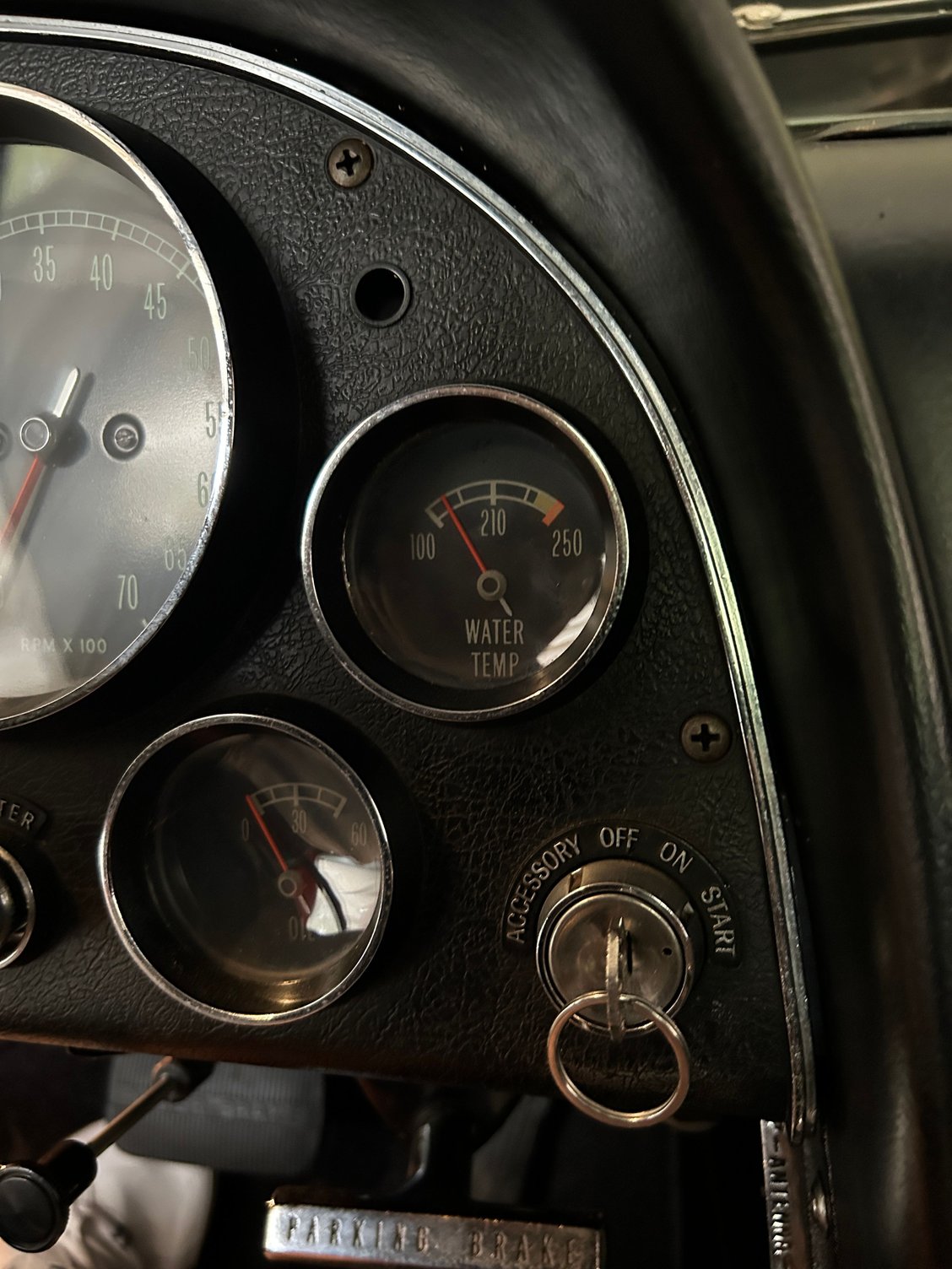

Beginning position of temp needle, ignition on or off, hot or cold
Temp sender wire jumped to ground. Ignition on. The needle remained full scale when the ignition turned off.

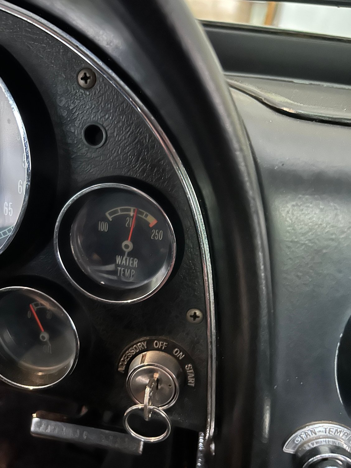

When the ignition was turned on again. the needle dropped to this position and now remains there regardless on ignition on or off, engine hot or cold.

Looks like the needle slipped out of position and then stuck there. It shouldn't be that high or stay that high with the key off.
