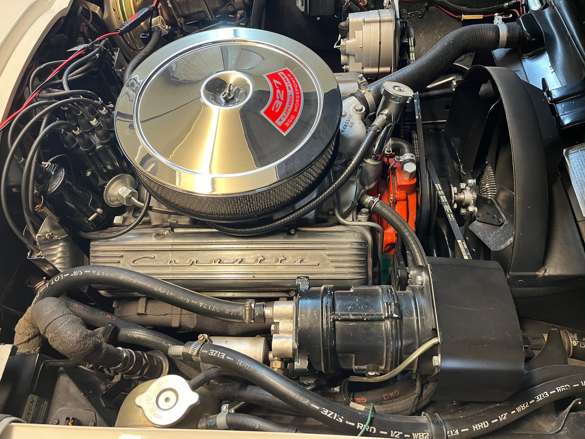

Larry,
I will, if you'll come to Big D and help with the installation and evacuation and recharge. The Pro6Ten is a great compressor. Mine has been on for over ten years with minimal use. I'm a windows down, old school kinda guy. Hence, the lack of urgency to re-install the original that Dom restored for me back in 2019.

Leif:
Thanks for the offer. . If I still lived in New Orleans I just might make the trip........and do the Texas NCRS October Regional as well. . I used to be a Texas Chapter member and attend their chapter and regional events. I stopped when Louisiana Chapter was formed and became a Louisiana Chapter Member and Officer.
We need to tell Ed that your seal cover is not a standard part that comes with the Pro6Ten. Don't know if the Pro6Ten even needs one. The original A-6 compressors certainly do. You may or my not remember that I helped to design these covers years ago. I supplied an older prototype to a guy in Ohio, who then tweeked the design, had a shop build him 50 or 100 for local sales, and then apparently sold the design or the sales rights to Ecklers Corvettes. When I left New Orleans a few months ago, I gave my originals and a few of the revised ones to my friend Stick to use for his and friends cars. Stick has a 69 350/350 HP original red/red convertible car with factory air.
All my AC equipment and R12 supplies etc were left with friends in New Orleans.
Take care my friend.
Larry
