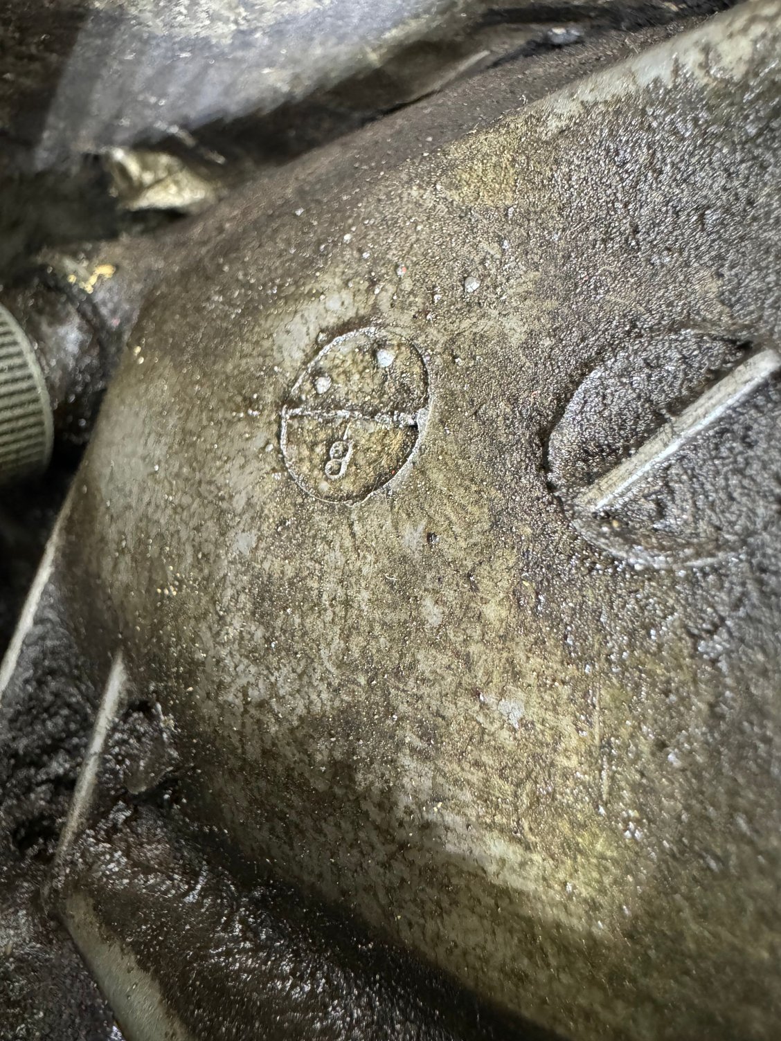

I recently acquired an early build 1965 roadster and was looking at the transmission assembly date. I thought it was a restamp because of the “fly cut” where the assembly date is. Then cruising the forums I saw another one like it. Then I thought to myself that would be a lot of work just for a restamp. You would have to disassemble everything and have the bare case all by itself to make that fly cut. So now I’m thinking it’s a factory thing. Does anyone have any insight on something like this?

I have never seen a stamp like that on a Muncie.
Also, the blurry photo is not kind on my eyes to read the numbers and letters. Try again.

Agreed clear photos
And Need to see the Cast-in numbers symbols next to the P Date
I’ve seen this
been long time
It was machine milled
Very important here is that original aluminum casting once blasted are very obvious
you cannot fake a muncie

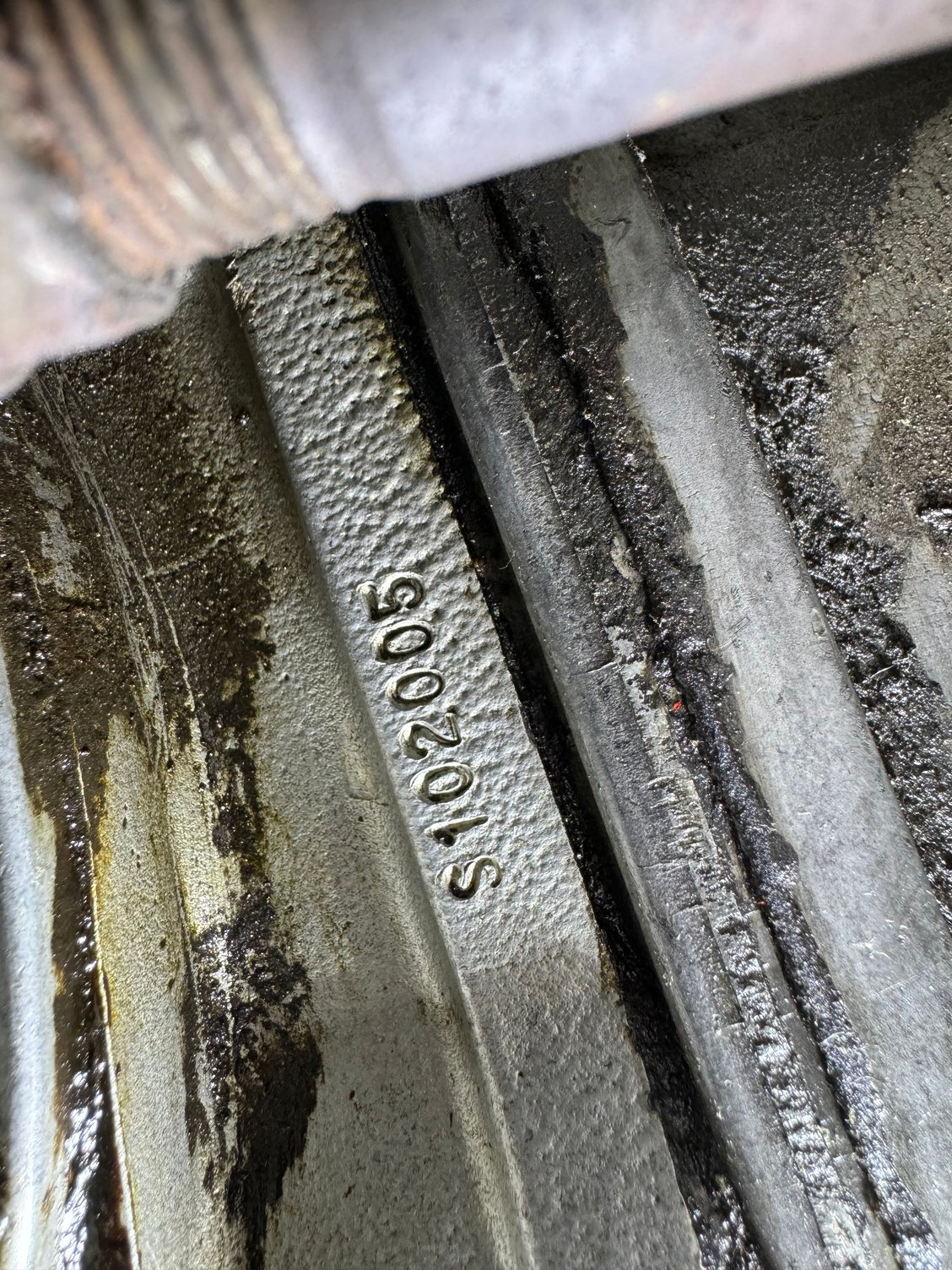

next I need you to get a pic of the vin on the drivers side flange
again
get up in there with non iPhone illumination so the phone focuses properly
If you really want to go deep
carefully wipe off tail shaft and side cover
there are casting symbols there that can be decoded
it always nice to see a survivor born with car having a Muncie that was cast at the foundry two or more months after the car left StLouis Asy

This Vin Gang stamping is consistent with what I have seen...This is from my 65. Unfortunately did not picture the Muncie Date Code on the other side of the Muncie.

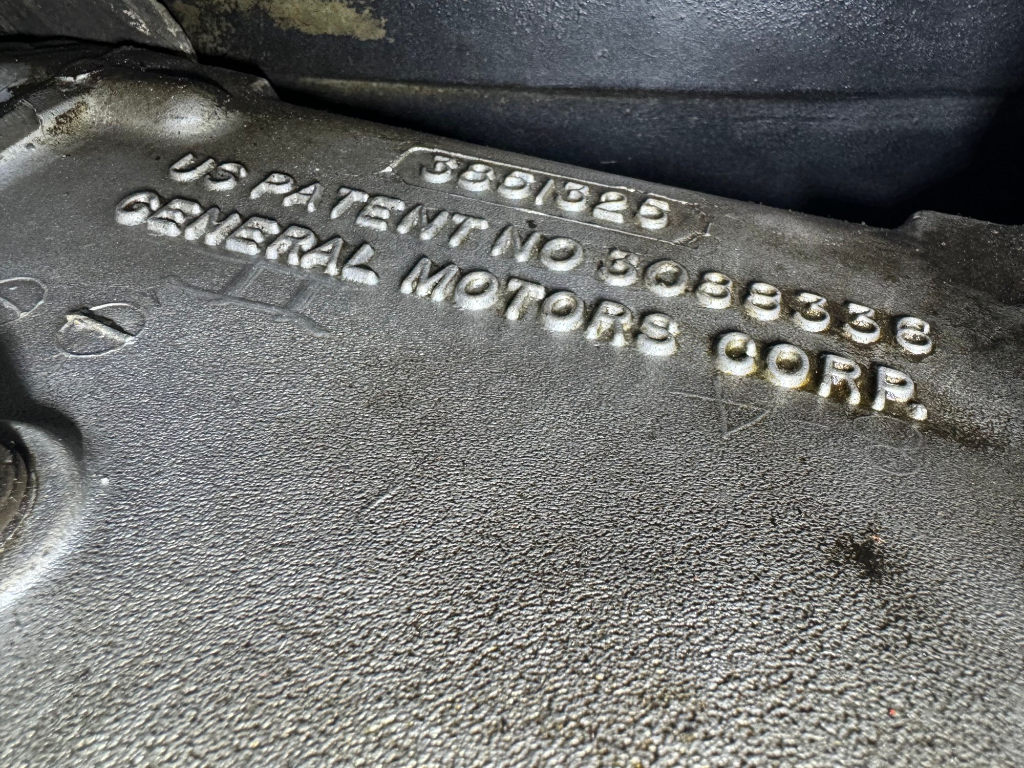

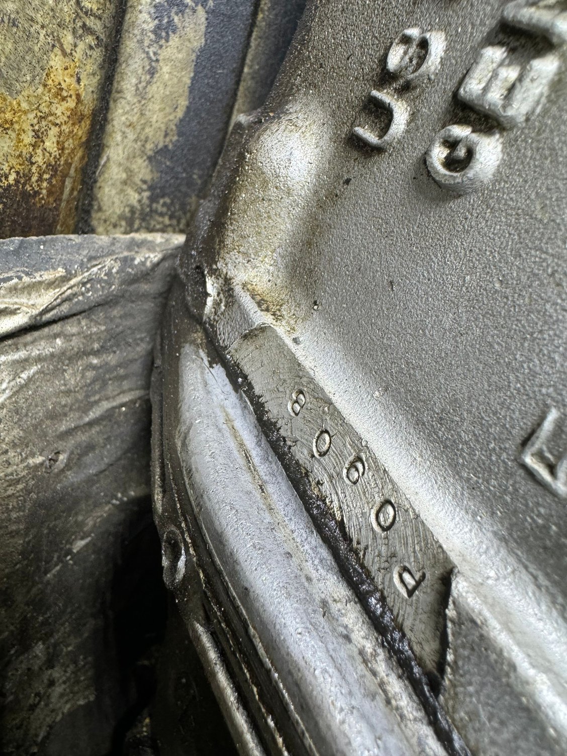

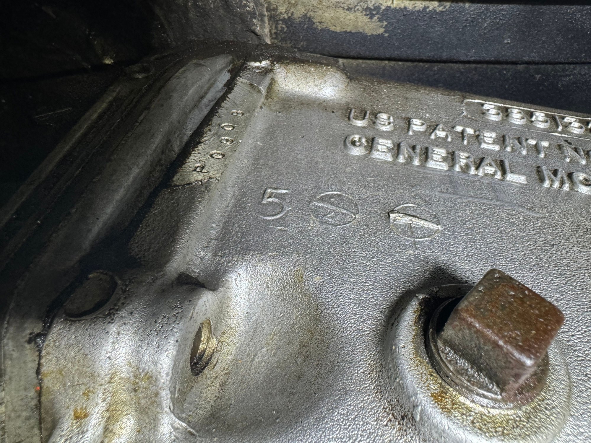

Better pictures.
Old Oct 9, 2024 | 01:59 AM
Argentimage's Avatar
Argentimage
Joined: Sep 2009
Posts: 1,806
Likes: 212
From: Metro MI too close to the D
To the right of the P date are casting details
please get that picture

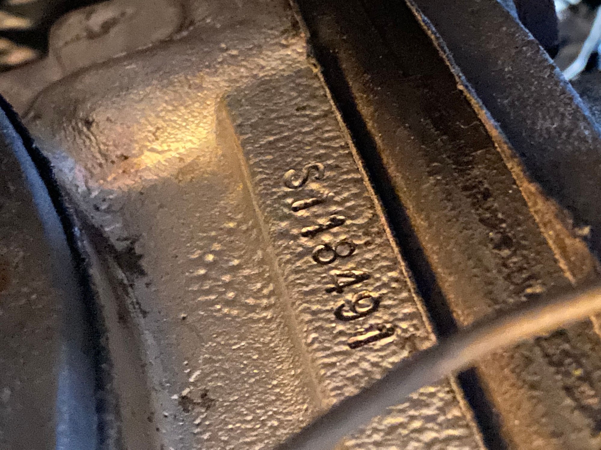

OP
what is the ratio?
engine?
what is the delivery date to the first owner?
Did you get a Ncrs shipping report?

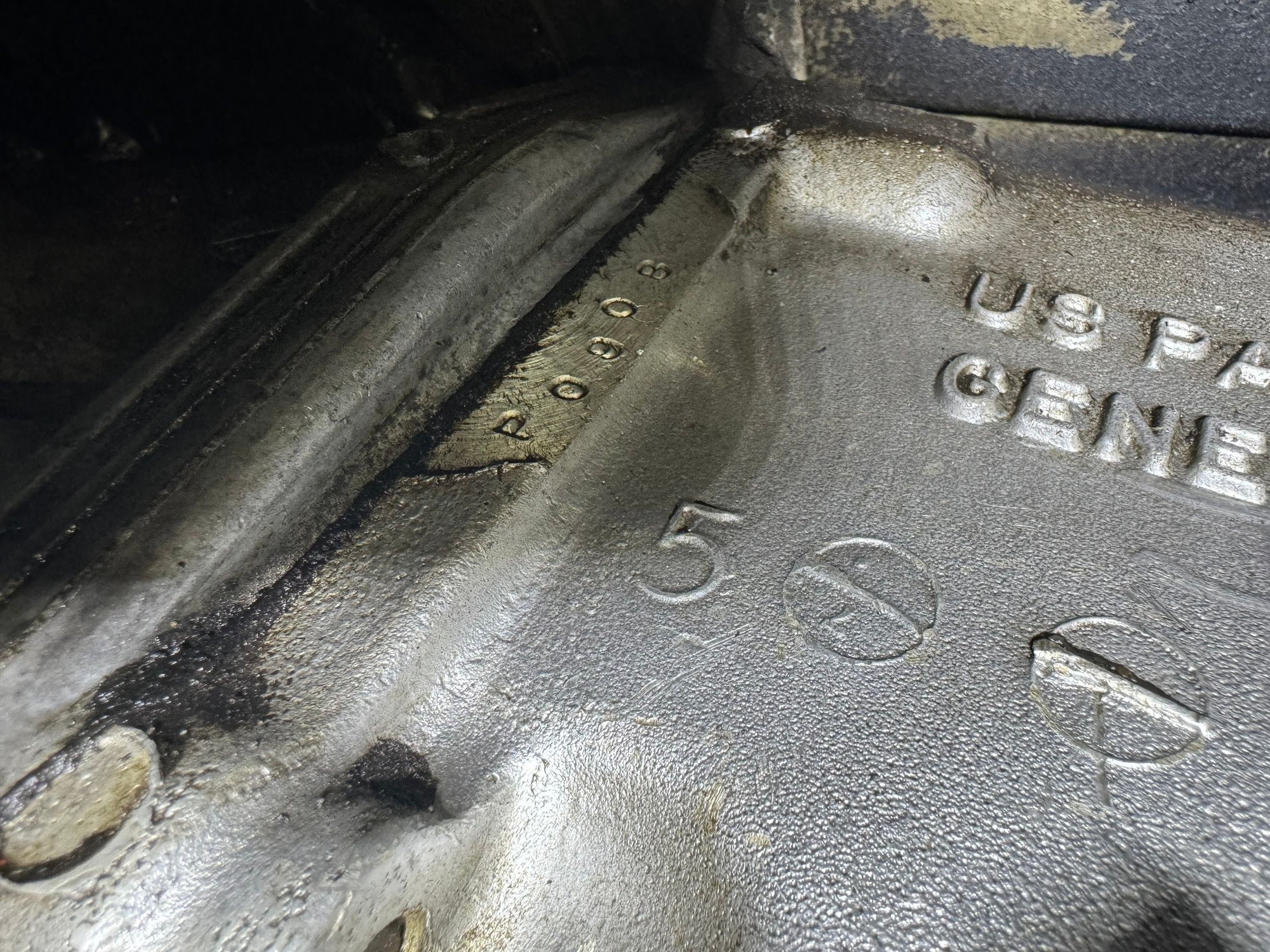

No NCRS report until tomorrow. More pics of the main case.
Old Oct 10, 2024 | 04:29 AM
Argentimage
Joined: Sep 2009
Posts: 1,806
Likes: 212
Main case cast 1st week of July - lines up with early 65 build
What was the final asy date of the vehicle?
and in the pop dealer delivery date?

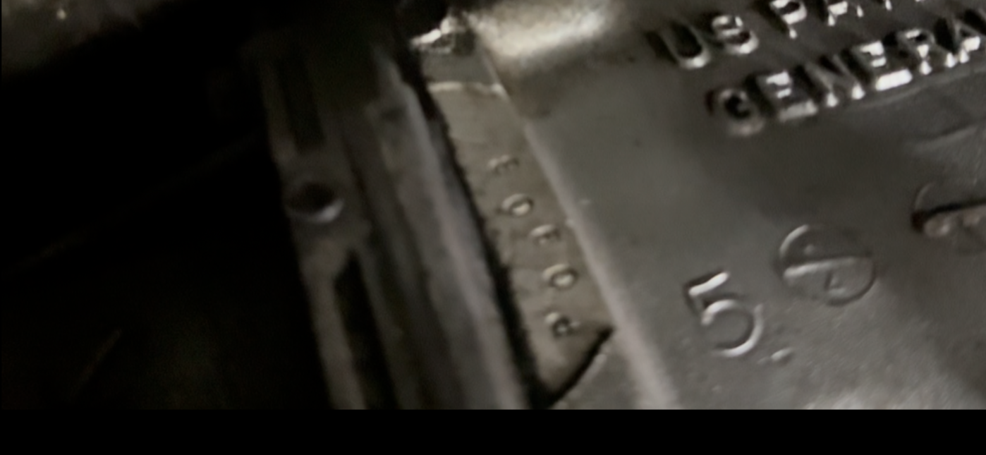

This is what an early 1965 model year "P" number(build date) stamp looks like.
I have about a dozen of these in stock, I have never found any cases with August to Oct early Nov. of 1964(1965model year),
that are not stamped like this.
The only reason I can think of for GM going thru this process, is 1963-64 Muncie's were stamped on side cover flange, a machined surface.
So 1965 model year the "P" number is stamped on the right side of the main case on a rough casting. Then some engineer de-sides it has to be stamped on a machined surface like 1963-64
so the case gets fly cut, and it takes 3-4 months for the engineers to figure out its easier to just stamp the rough casting.
Hope this helps... Eric

I haven’t replied because I was waiting for my NCRS report. I just got that report about an hour ago in the mail. NCRS says that the production date was 11/13/1964. The protectoplate does not have a delivery date on it, but does list it as an L, meaning a November car. I think that the delivery date of 5/26/65 is to the second owner.
