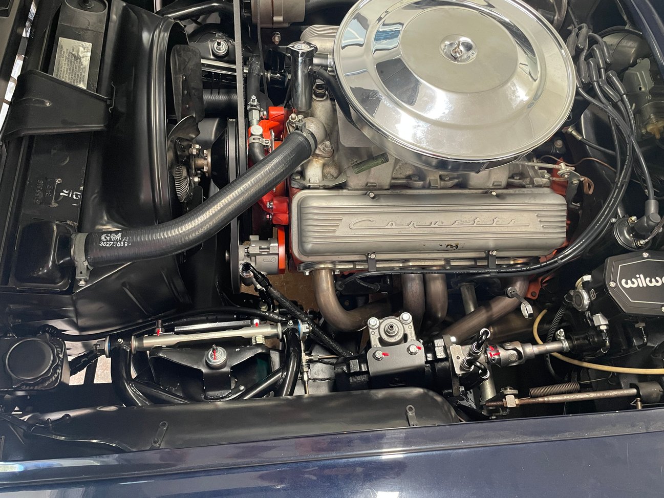

working on getting parts together now, for my conversion. Looking to do the same setup ad Greg did on his 64.
https://www.corvetteforum.com/forums...post1605902806
Not buying the kit - just parts to set it up a little different and cheaper.
Starting with the Steering box
Borgeson 600 Power Steering Unit PN - 800108 - $434 @ summit currently - probably cheaper if you look. I think Jegs had a $20off coupon.
Power Steering Pump - Speedway has the whole unit for $143
I'm going to try the GM Type II pump instead of the old Ham can style. Aluminum and a little lighter.
Speedway PN: 91033902-10
- Type II pump adapter for my SBC. $33 on speedway
pn - 91032905
- Rag joint or coupler for steering shaft - Borgeson brand
- Rag Joint is 18mmDD to 3/4" 36 spline PN - BRG-055034 $105
- universal joint - pn 013450 $79
They also make a universal joint with vibration dampners.
Vibration Damper, Steel, 3/4DD X 18MM DD - pn 034950 $115
- Hoses and AN adapters 3 hoses, 1-10an hose from the res to the pump, 2 - 6an hoses, one to the pump and one to the res. Cheap kit for PTFE high pressure hoses about $110 on ebay or you can buy them summit etc.
- Fluid res - $62
Keyser Manufacturing Power Steering Tanks 100 15382
- Probably the reinforcement bracket for the PS unit to frame
RideTech Steering Box Reinforcement Brackets 11539535 $80
https://www.summitracing.com/parts/ART-11539535
