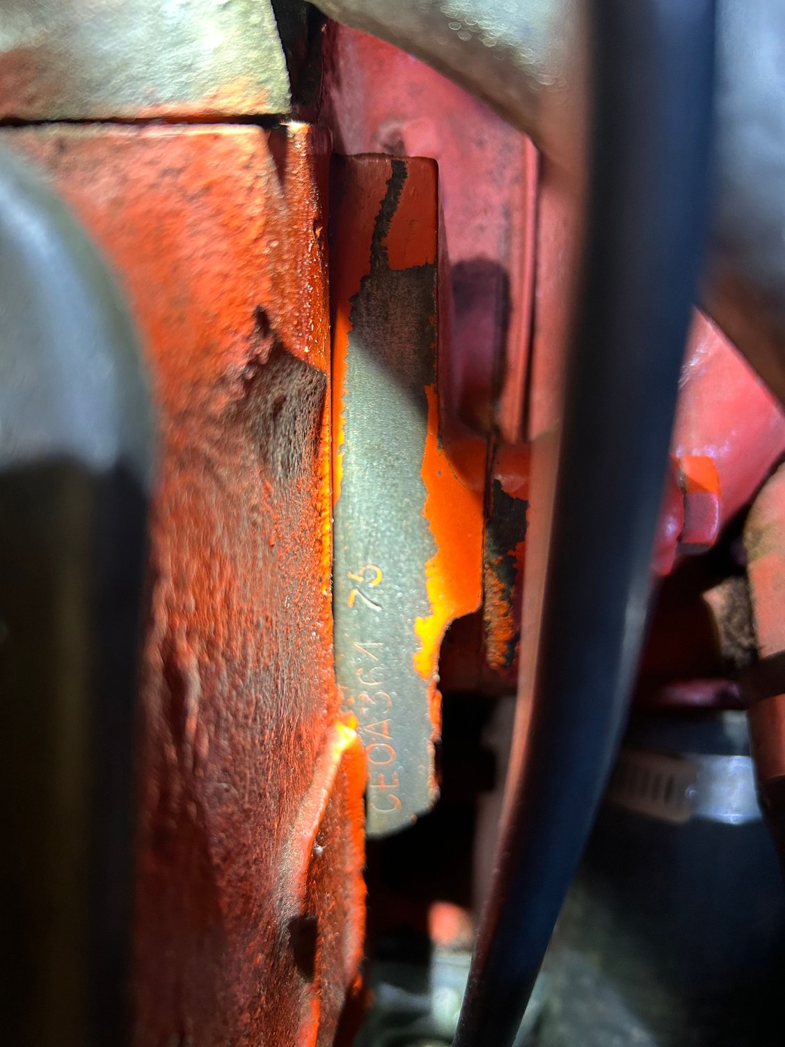

I have an attached a photo of a block stamp on my '66. Its is a 'CE' block. Can anyone tell if this an original stamp...something about brooch marks I recall. Also, is there a registry of these replacement engines and what car they were placed in? Thanks

It's just a counter exchange block, no records for those.

What is the casting number and casting date of the block. The CE program did not start until 1968

As above have stated, it’s a replacement engine. Never original to your car. Nobody cares when it was installed or why. I would prefer a CE to a modern crate engine, but no one will fake a CE engine pad. There is no value to it……

The real meaning of CE to Chevrolet:
Crate Engine- unlikely
Chevrolet Engine-possible
Counter Exchange = hopium for wannabees
You went to the dealer, or as an employee of GM, you could go to the GMPD parts depot and buy it.or any other part in stock.
And even if it was in the 30 seconds or less warranty window of the 60s, a CE block is NEVER going to be an original engine, never factory correct.

CE - Chevrolet Engine, 0 -1970, A - 1st run of the 20000-49999 number series ( 2nd run would start with B), 36475 - engine number in series.

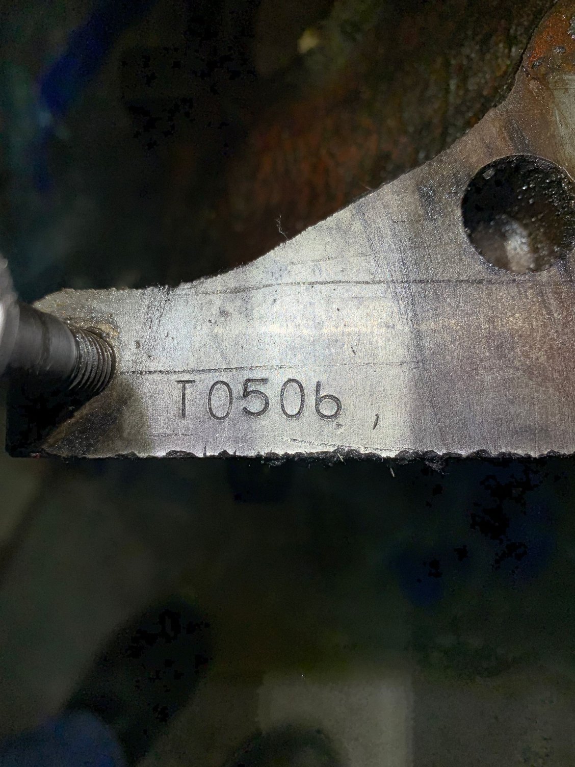

One more thing - on big blocks, the month-year of machining are stamped on the starter mounting pad. Not sure about small blocks though. This is a May 1970 big block.

This is from the starter mounting pad on a 942 block that has a casting date of E236 so May 23 66, I can't come up with a logical date from the stamp.

It’s hand stamp
