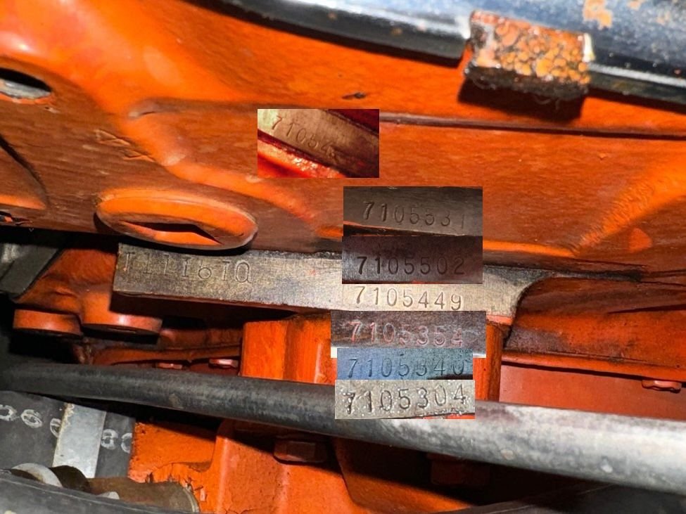

Default '67 Stamp comparison
FWIW:

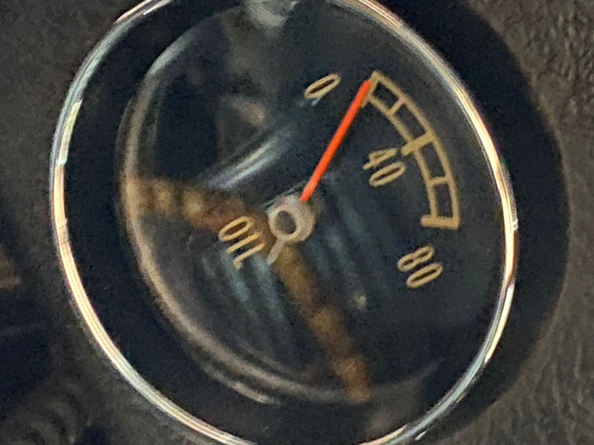

IIRC '66 390/400 HP 427s have a 5300 redline and all C2 427s should have a 80 psi oil pressure gage.
Duke
Duke
Post disapeared
Duke yes and John z helped me debunk that fakester propaganda bout 15 years back by those selling sbc cars with barn find bbc
For the record here is a low mile 390 66 gauge
