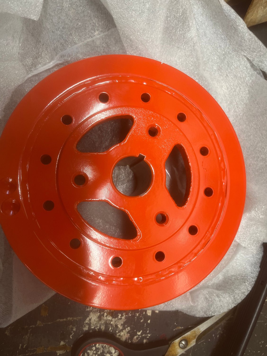

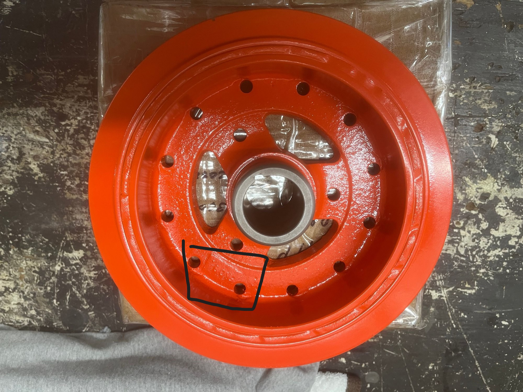

Picked up a NOS Harmonic Balancer, #3817173. Box shows GM production in Canada with an order date of 3/13/2003. My question/concern is that I cannot find the above part# anywhere on the balancer? The only numbers I have found are on the inside, one is 2538 and the other is 5K08 or 5KOB. Does the below picture look to be the correct balancer?

I don't think your balancer is what the box says – the 3817173, I believe, is a "finned" balancer. Shown as the top one in the pic below. From what I've read, the over-the-counter replacement did not have the fins - like the lower balancer.

Thanks for reply! I believe this to be an over the counter replacement without the fins, but it’s weird that there isn’t a part number to be found?

Yeah, if you look at pics of the 7173 it seems they are all stamped on the front with the part number.

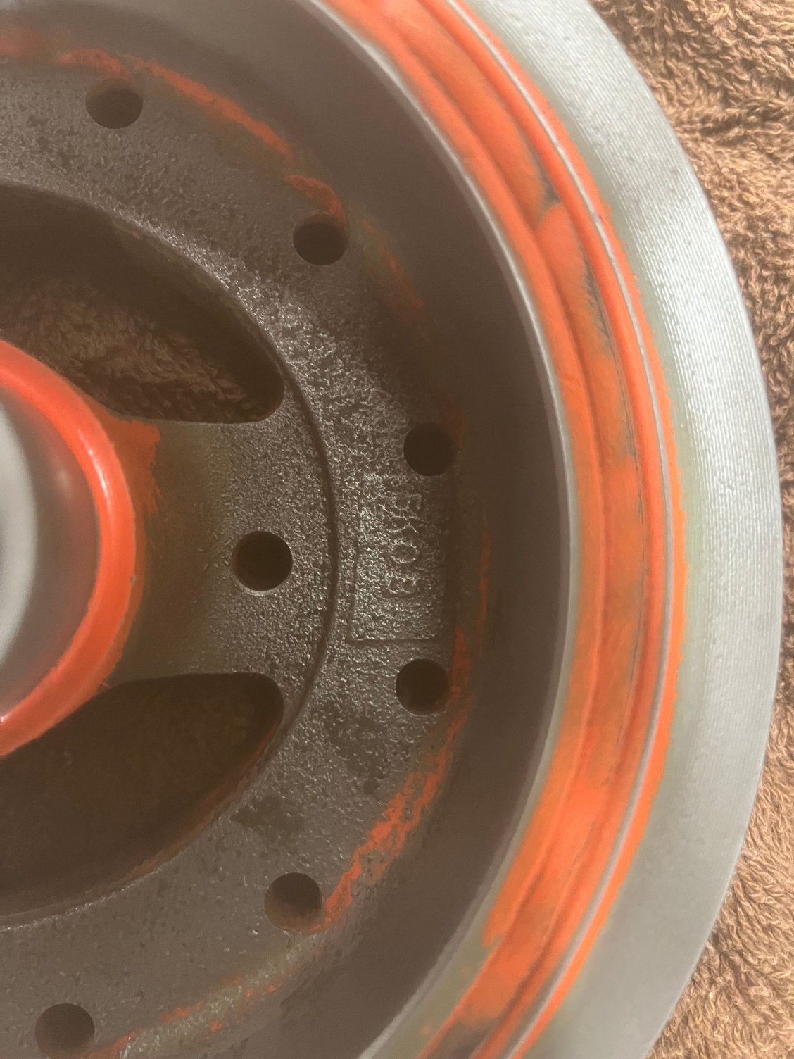

what is cast into what I circled

I believe that is either 5K08 or 5KOB

I think it looks like 5K03, which kinda sounds like a 2003 casting date...

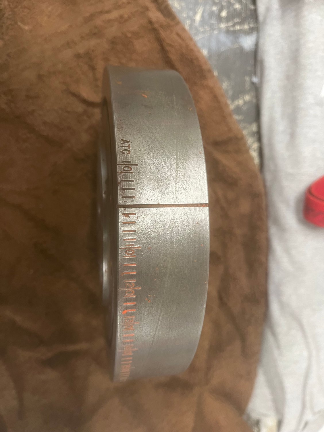

Based on these pics what degree am I looking at?

My '77 Corvette P & A catalog lists 3817173 as the balancer for 62-68 w/ FI, Sp. H/Per, (327), and there's also a note to use 3883206 key with this balancer. So it looks like what you have is the real deal. The reason you don't see a part number is because what you have is an "assembly" made up of three separate parts... hub, rubber ring, and iron ring. The 2538 could be the last four digits of that individual part.
I'm not sure about the cast in characters... 5K03 could be 5 November 2003 (I is typically skipped so as not to confuse with 1, so K would be November), but that's prior to the pull date, so no dice.
What surprises me is that GMPD would still have this part in the early 2000s whose last use was over 30 years prior.

Those degree markings are not OE. I assume that the unpainted painted part is different than the painted part. Maybe you could explain in more detail.

Same part, I stripped the damn thing to find any numbers to help me identify what I have!

The outside ring of a stock balancer never had calibrations. It only had the the single timing mark.

So someone who possessed that part in the last 21 years had the degree marks added, except the notch that goes clear across. That's the factory index mark that indicates TDC when aligned with zero on the OE timing tab that's tack welded to the timing chain cover. Said person also probably painted it. I don't think the service part would have been painted, but if so it would not be nearly as nice.

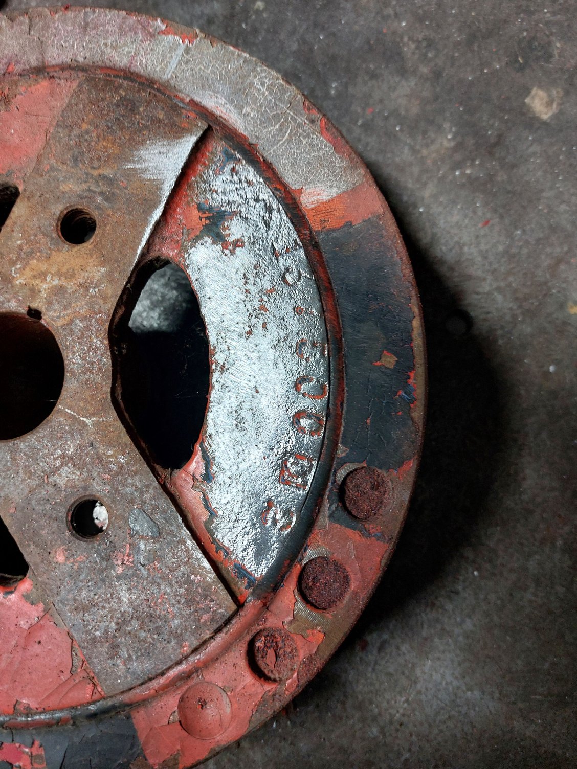

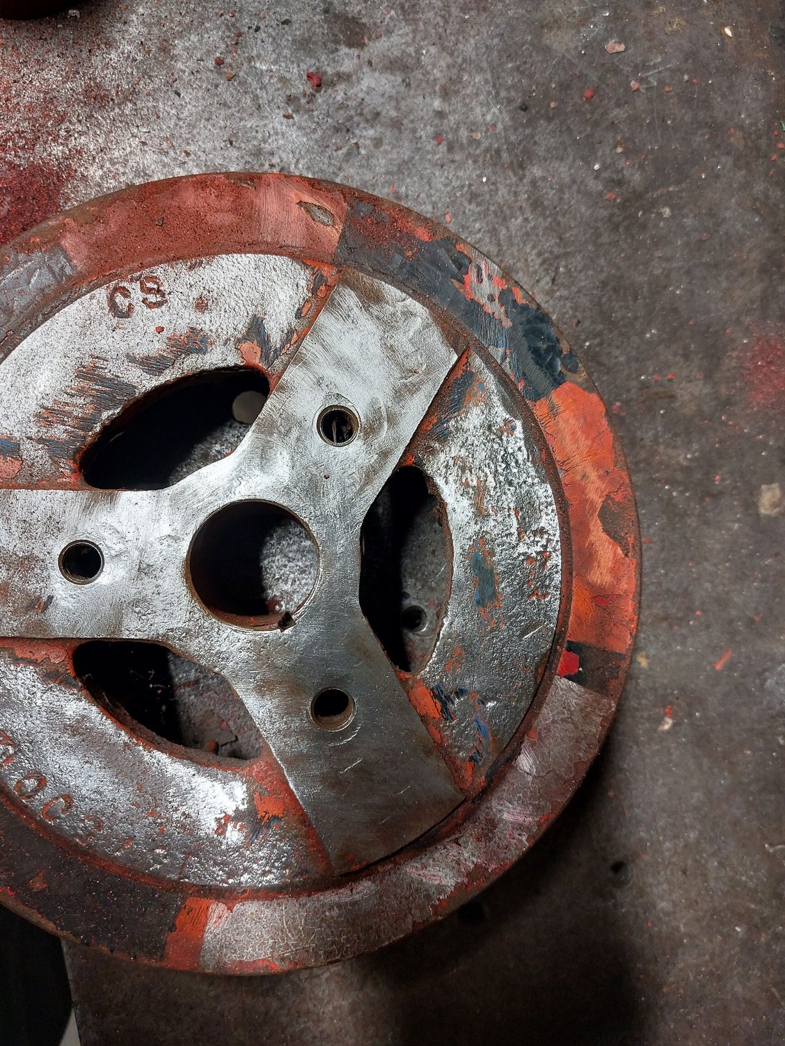

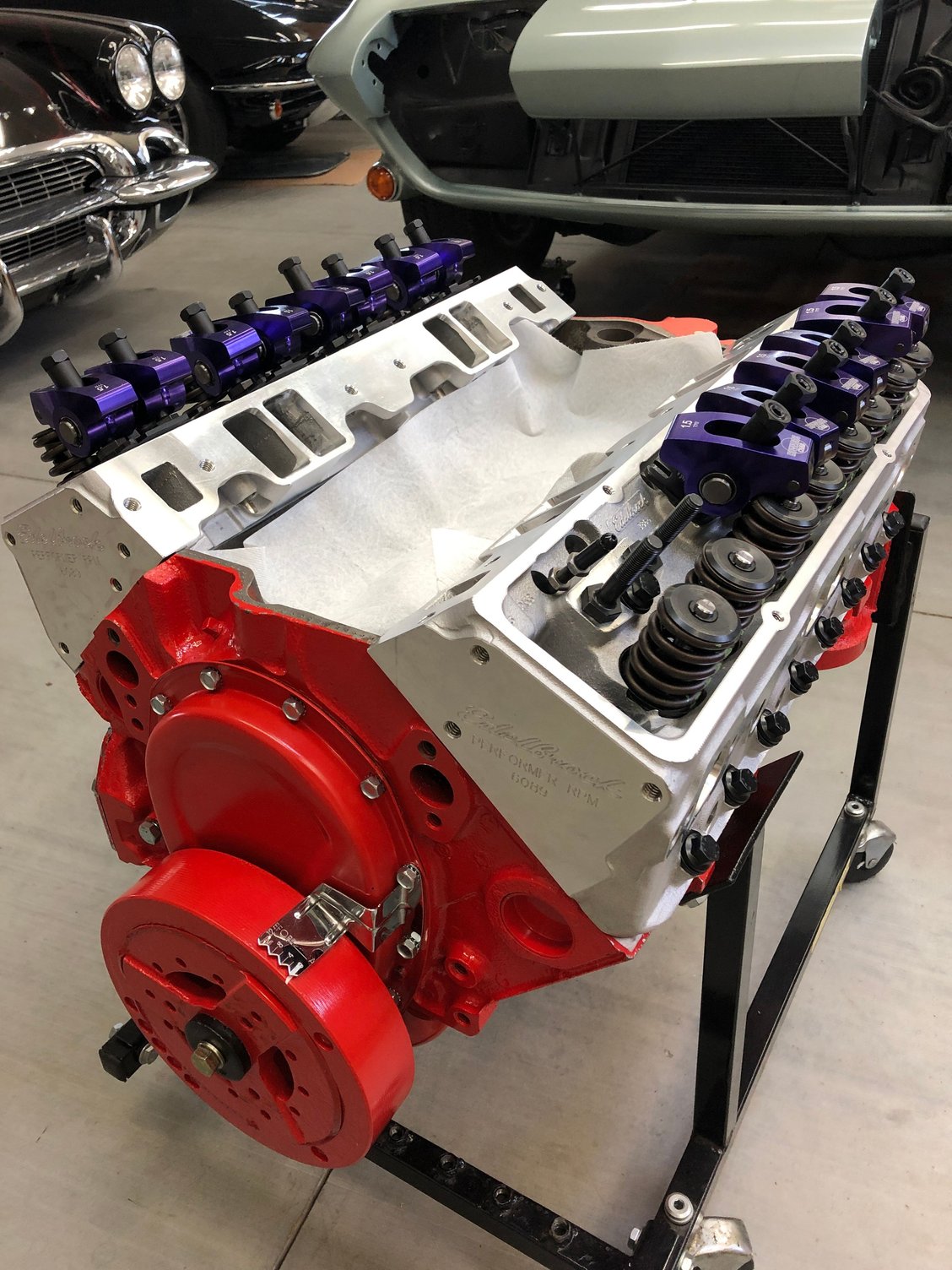

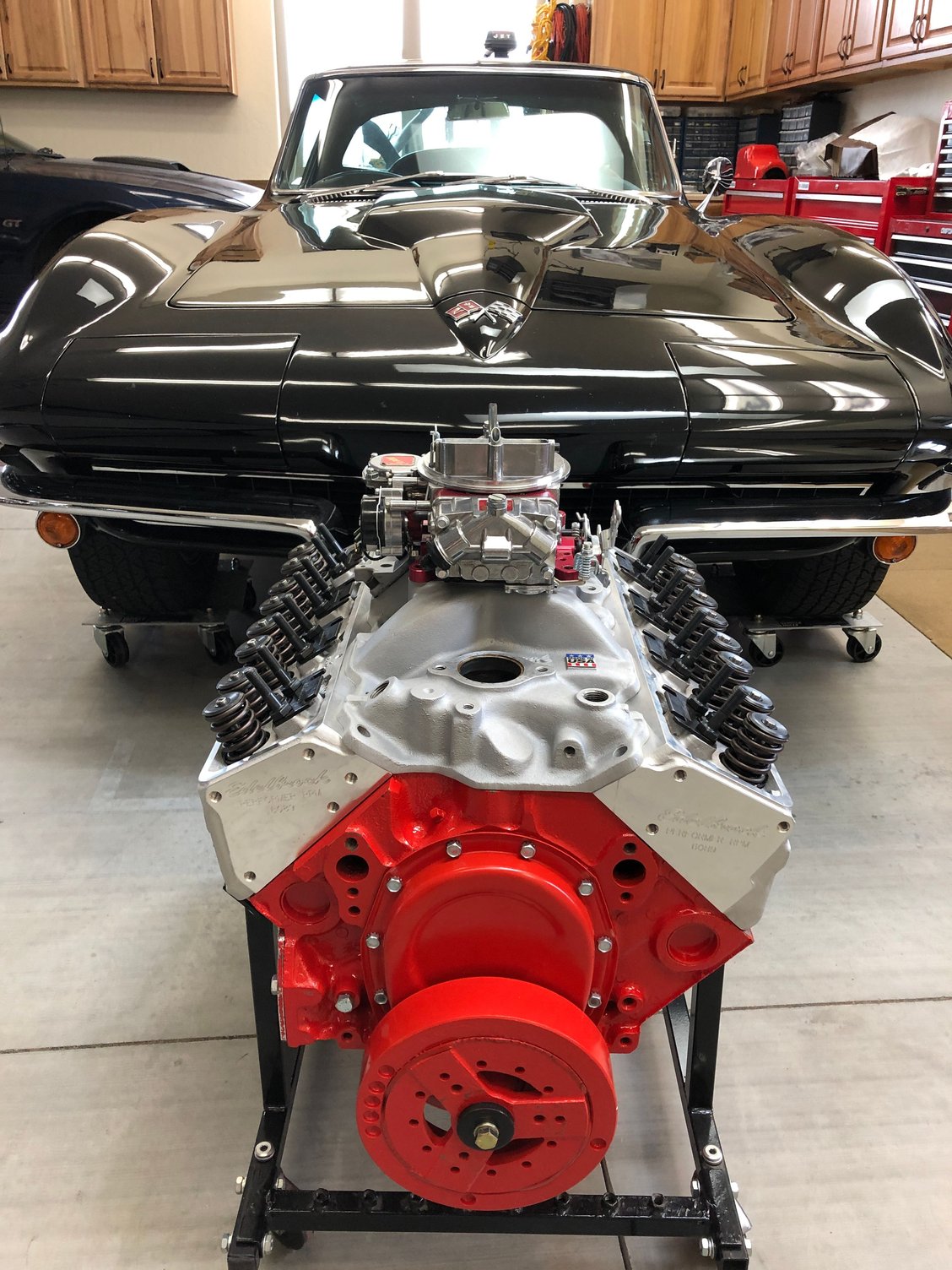

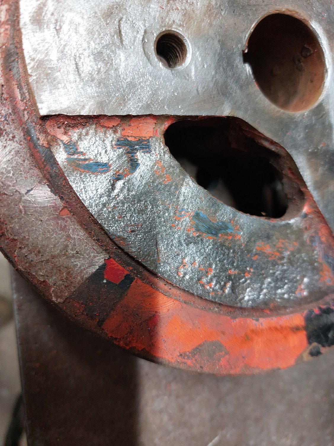

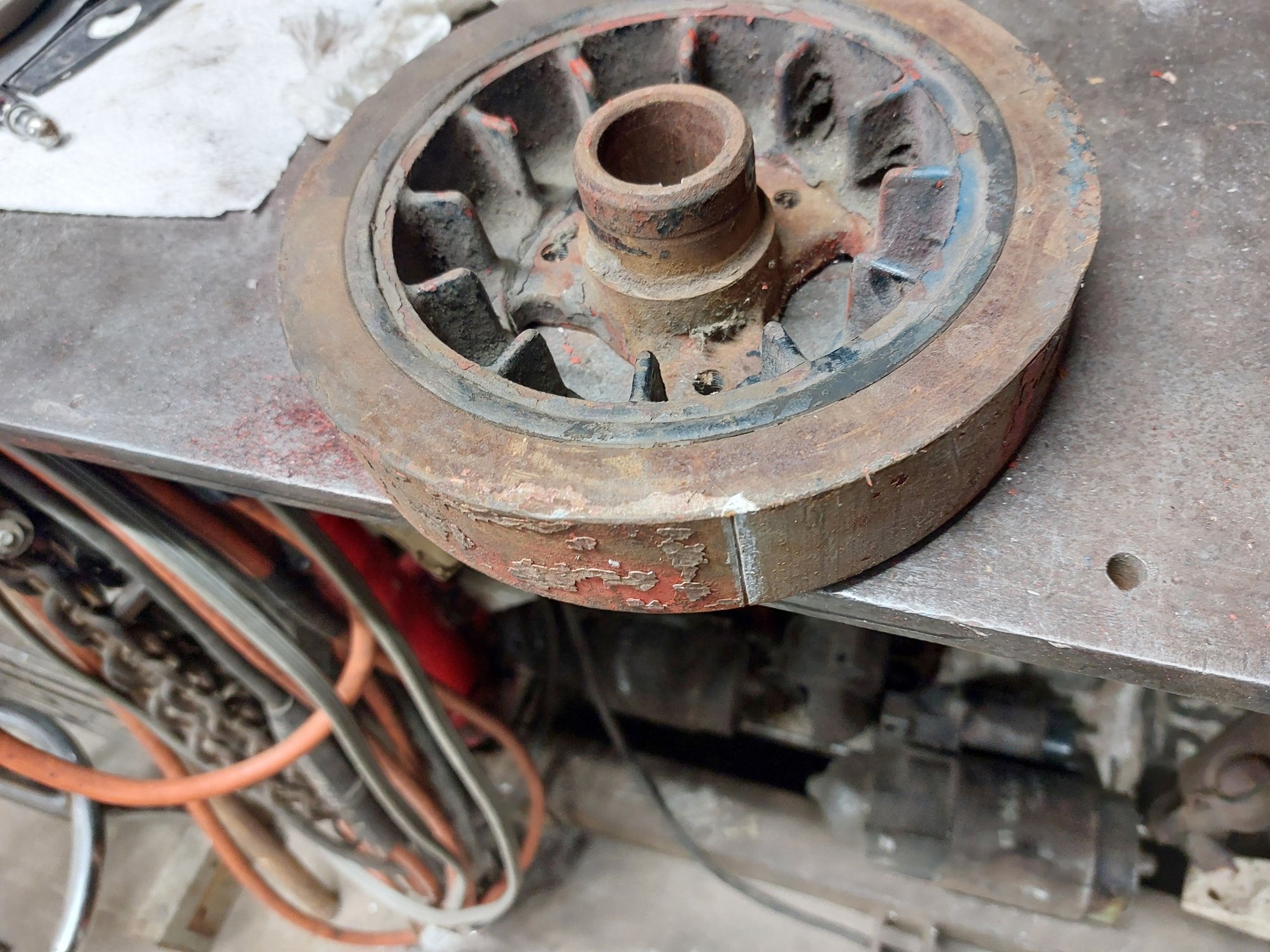

It appears you, CTVandy23, have the later harmonic balancers with the 0 degree timing mark offset 9 degrees from the keyway which is TDC +/- 2 degrees. These #3817173 balancers were used with the HP engines which utilized the long water pumps. I believe they were still cast as #3817173, but may be wrong. They did not have the cooling fins and have holes around the perimeter of the hub. This balancer must be used with the correct timing chain cover or aftermarket timing tab to get correct timing.
From the Google search I have done, the 62 to 65-66 # 3717173 balancers had the cooling fins and the timing 0 degree mark was about 2 degrees offset from the keyway. The GM parts catalogs show the #3717173 balancers were used from 62 to 68. They were used on the HP 350 HP and 365 HP 327 engines and the 302 engine. Most engine builders recommend this balancer for all HP engines over 300 HP. I ran this on a 302 engine and have the later model on a 350. I don't know of any reason not to run it on any SB.
It seems sometime in 66 or 67, they eliminated the fins and it may also be when they drilled the holes around the perimeter of the hub ring but I could find no definite information on this change.
Here is the #3817173 balancer I have:
Finned 62-66
Almost non-legible due to casting variations. 3717173
137500 2 I don't know what the square in the number means and the marks / numbers in it.
Also, the CS stamp is a mystery.
Ron

Ctvandy23, Your balancer may indeed be an aftermarket or maybe later balancer from GM as indicated on the box. They were very popular and used on all HP engines and used thru the 70s. I am surprised GM seems to have kept using the #3817173 number with the elimination of the fins and change in timing mark location.
The Damper Dudes web site shows a new 8" balancer available that they seem to manufacture or at least retail. JEGS and other retailers also sell a new 8" balancer identical to yours and may even have the degree stampings.
