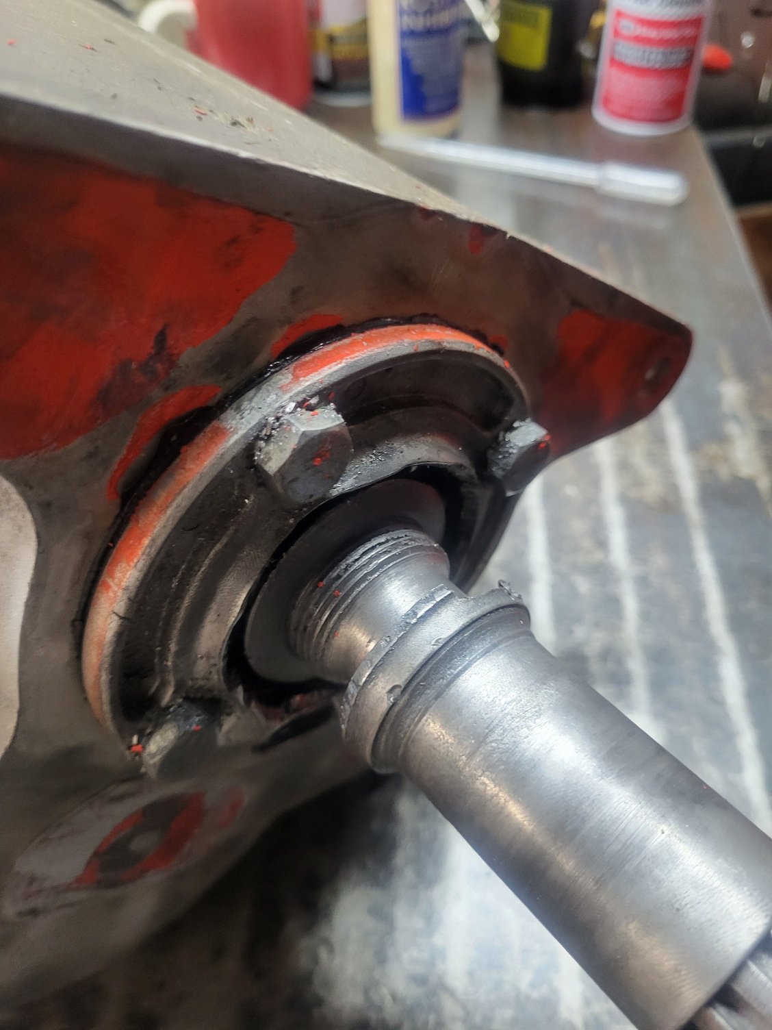

Hour and half later this is what I found.

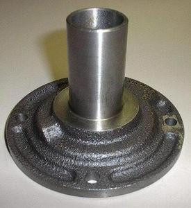

should look like this...

I am actively searching for the cast iorn retainer if anyone has one those, this one is aluminum. The car is A 63 split window so it is the first design.
That's what I suspected it had to be, based on your description. For sure, that would cause a major leak.
If it is a numbers matching Muncie for your car, I would invest in a proper rebuild. Otherwise, replace it with something of your choice.
BUUUUUUUUUUUUUUUUUT, BEWARE OF THIS------------IF IT IS A 63 MUNCIE AND A 63 BELL HOUSING (421), ONLY, ONLY, ONLY A 63 MUNCIE AND 421 HOUSING ARE GOING TO MATE!!!!!
If you replace that Muncie with ANYTHING else, you will need to round up a 64-later 403 (or 383) bell housing.
By the way, if it is OK with you, I am going to save that picture to my file.

Thanke to all. I tore down the transmission today and sent the case to Riverside Gear in Michigan to rebush the lower countershaft. Bob there, which was very helpful, said the front retainer was probably cracked by whoever installed the transmission recently. Also the thin nut on the input was loose. I just got the car in June and just now went after the oil leak. The retainer is made from very thin aluminum. Thankfully the gears and bearings all looked very good. I found A cast iorn retainer made for this small bearing retainer In AZ. also today,

Ok, so now I have sent the case sent off after I disassembled it to be bored and sleeve the countershaft hole. Found A cast iorn front retainer be here tomorrow. The front bearing that is right there with the destroyed retainer has checked out, no noise after I cleaned it, also the rest of the transmission looked very good, gears and syncyonisers show no abuse from grinding. The bearing, 207SLB Timken, seems ok. Since it is the small bearing that Muncie chose to get away from and it has been close to some rather heavy destruction, aluminum retainer, I am leaning on getting A new bearing. Seeing 60-80 dollars for A new one.

Definitely replace the front bearing. There will be fine metal particles in the bearing from the bearing retainer tube doing some spinning around. From the picture it does not like a clean break. There is some metal worn off of the tube. It had to go somewhere.
