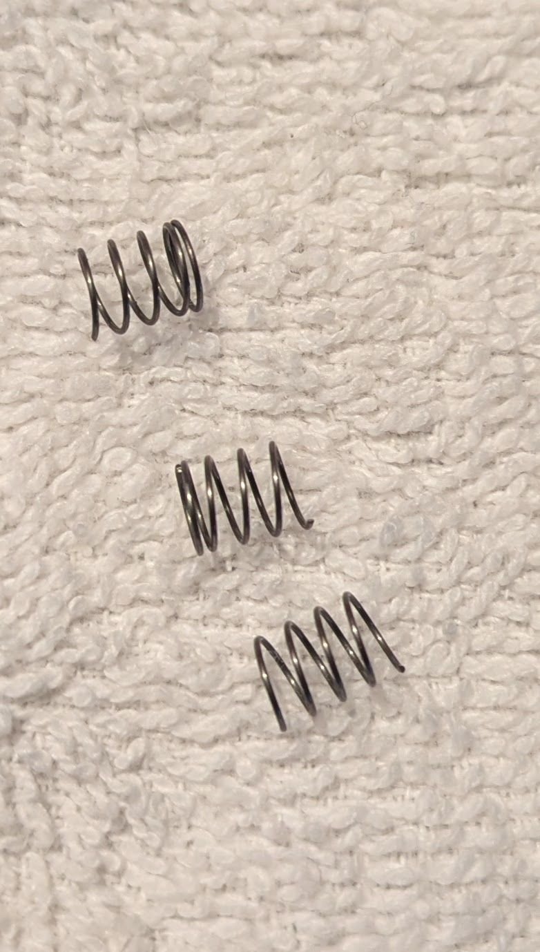

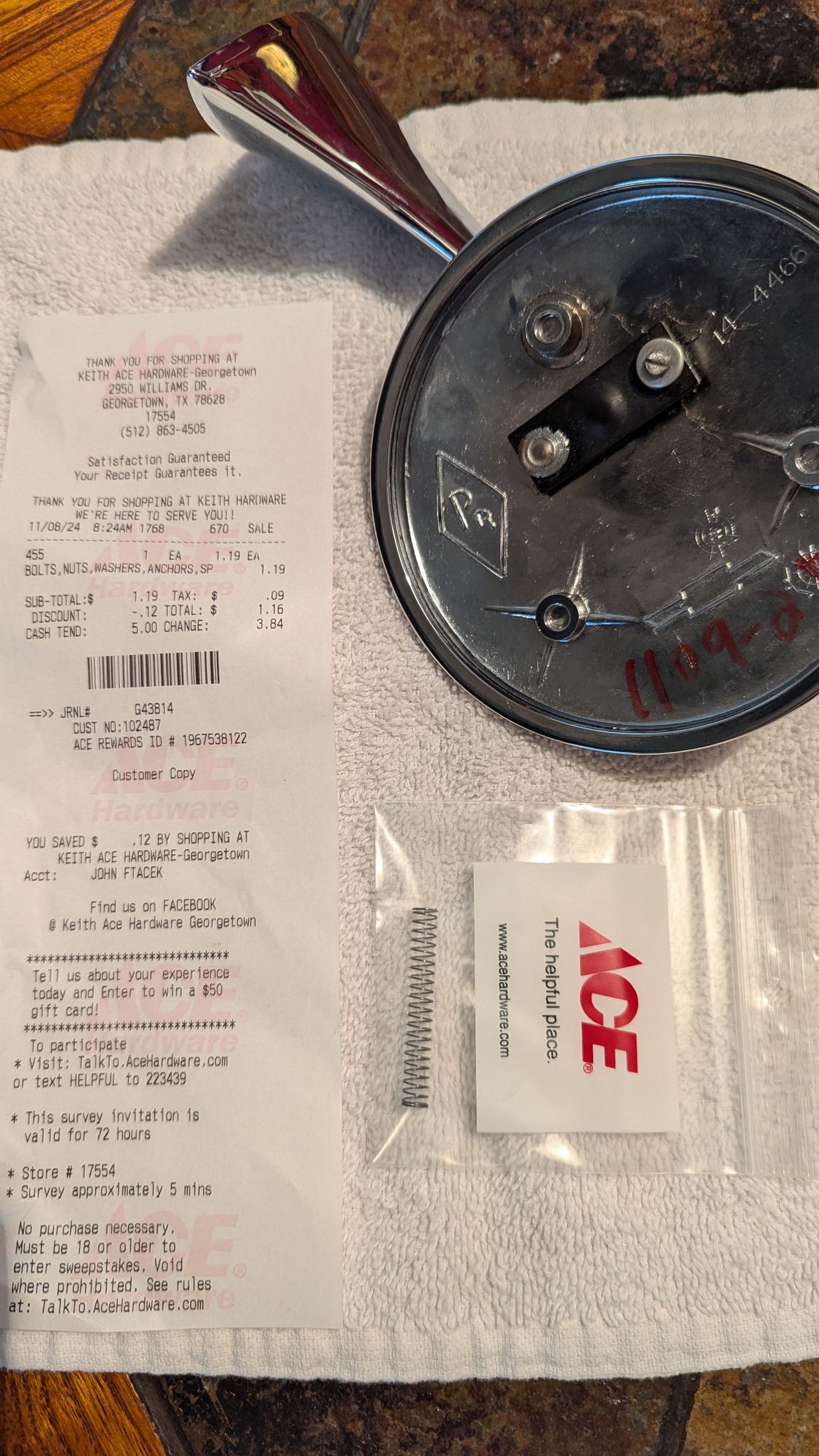

My mirror was cracked. So I ordered the replacement dated glass from Corvette Central. I took the old one apart and found that someone had been in there before. The three springs inside were missing. I went to Home Depot, and one auto parts store looking for a spring. Ace Hardware had a low tension spring that I cut into threes pieces. I put it back together working the snap ring around slowly. Repair all completed with the new mirror glass and $1 spring. Pics attached.
