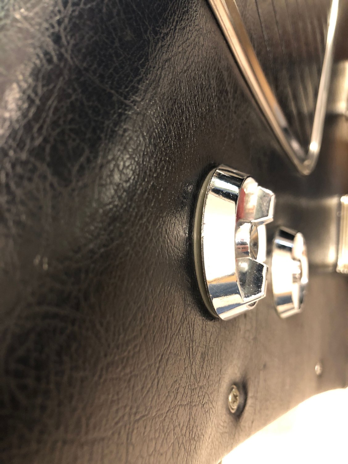

Original panel. Lots of room, with the friction spacer.
Old Nov 22, 2024 | 12:05 PM
Ctvandy23's Avatar
Ctvandy23
Joined: Jul 2024
Posts: 194
Likes: 57
From: North Jersey
Thanks for the picture. There is absolutely no space with the new components.

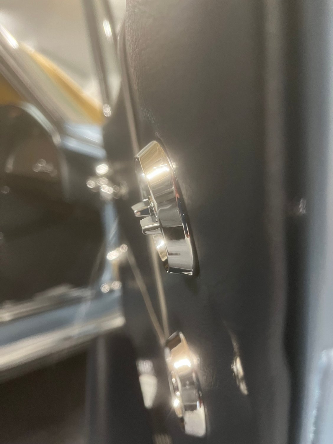

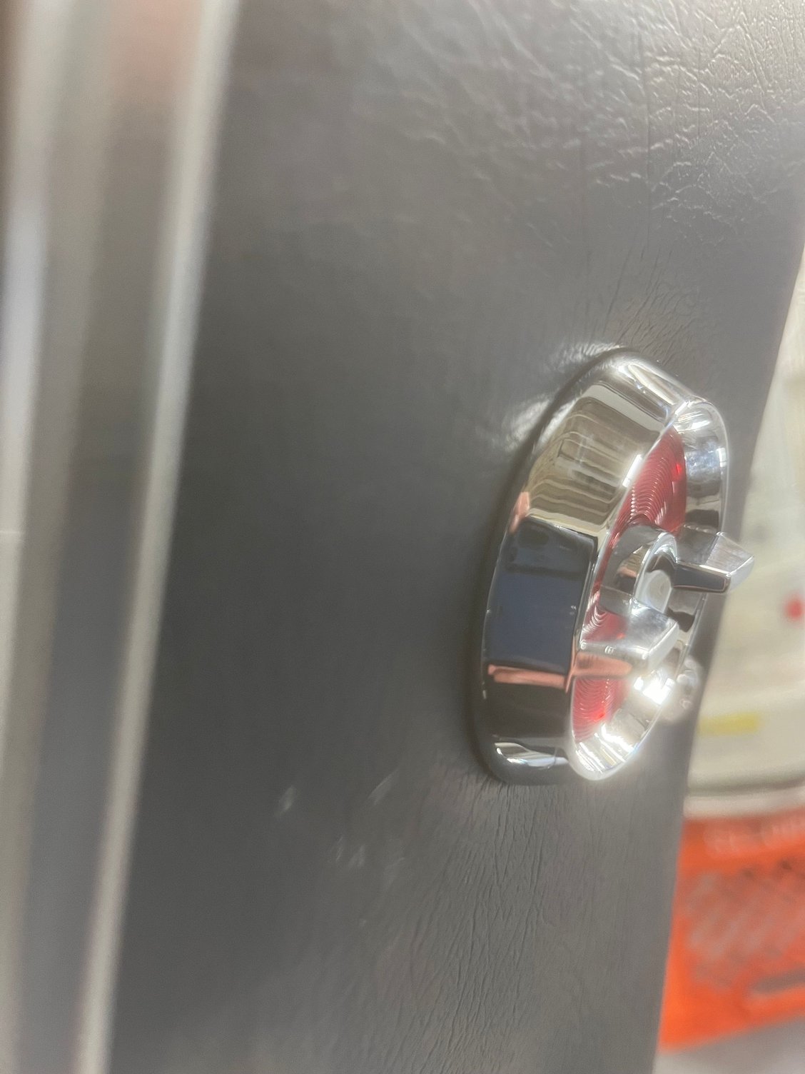

While on this subject, are the window cranks and vent window cranks supposed to have the plastic backplates?
Old Nov 22, 2024 | 12:39 PM
Ctvandy23's Avatar
Ctvandy23
Joined: Jul 2024
Posts: 194
Likes: 57
From: North Jersey
Here are pics of mine. Quite a bit of difference for sure!

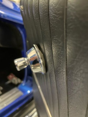

For your original issue, I’ve just installed the door lock today on the passenger side of my ’63. I had the same issue that you are having. Like you, I’ve removed the foam and some of the cardboard, but I’ve also pushed the metal plate on the back of the panel a little (see picture). I used a one-inch socket on an extension and just tapped it a few times. I’m not sure if you have this metal plate or not. I was then able to attach the **** and plastic backplate. The **** is very tight to the panel, but I can use the key to unlock it.
Now, just to be clear, your door project was to lube all the door parts that were already assembled on the door for, maybe, a long time? Years? My door project was part of a complete car rebuilt. Meaning that I’ve completely disassembled the doors, cleaned, rebuilt and lubed all the appropriate parts. So, my point is that the **** on both of our panels may have the same tightness, but my key on my door can unlock the **** because all the parts are cleaned, rebuilt and lubed. Just a thought.

Thanks Gary! After I took the panel off and lubed up the lock assembly the key turned the interior **** easily, so I believe it’s definitely the panel. I will take mine off again and see what is backing the lock ****! While on the topic of *****, Can you please post a picture of your vent window crank gap between the spacer and panel?
thanks, Craig
Old Nov 23, 2024 | 05:30 PM
GaryC's Avatar
GaryC
Joined: Oct 1999
Posts: 816
Likes: 37
From: Wilmington NC
Craig,
Here is the vent window crank. It is not as tight as the lock ****. Note about the plastic part: The crank plastic part has a larger diameter than the lock ****.
