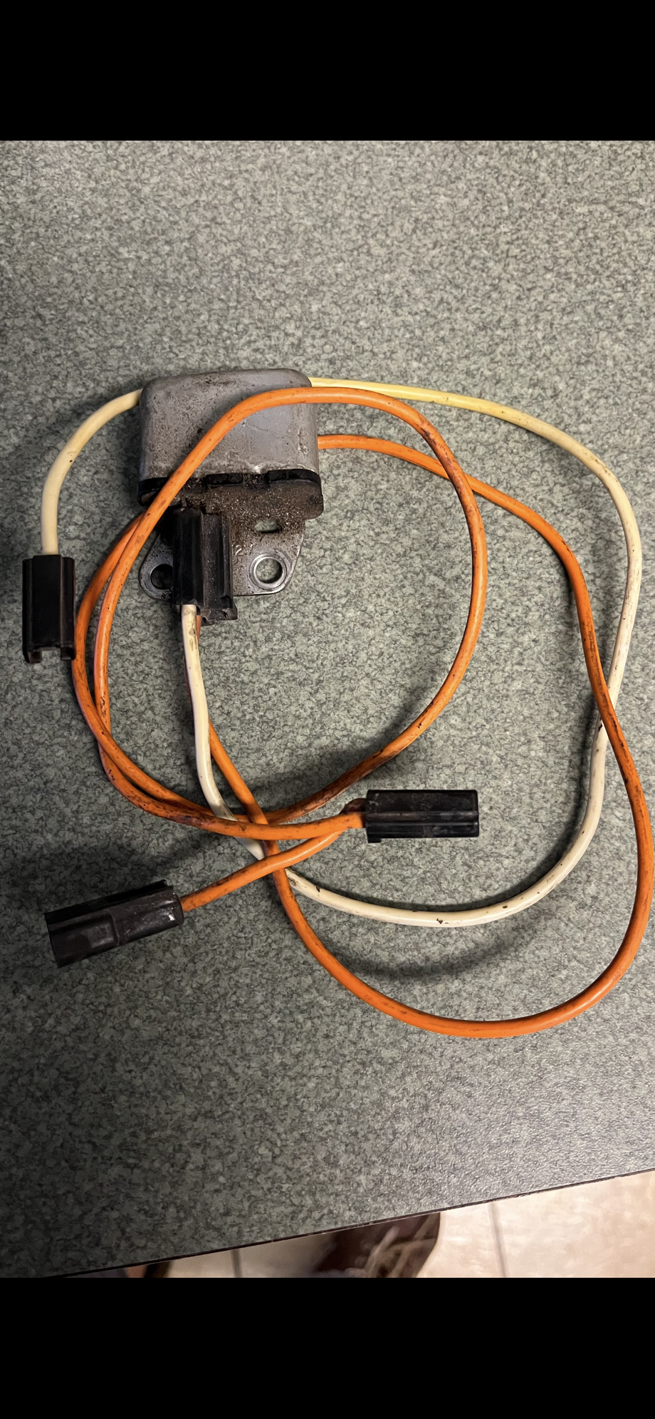

The buzzer was attached to the bird cage cross bar behind the radio

This is an original 67 wiring, harness and buzzer.
