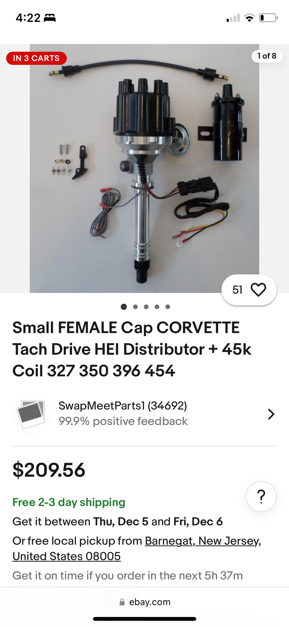

I'm curious when distributor you've chosen. Do you mind telling?
Old Dec 3, 2024 | 04:25 AM
Chagjr's Avatar
Chagjr
Joined: Dec 2022
Posts: 157
Likes: 97
He probably got one of these. Works great on my 327 L79.
e
Old Dec 3, 2024 | 08:41 PM
vracer99's Avatar
vracer99
Joined: Apr 2015
Posts: 52
Likes: 5
Thanks Nowhere Man. I checked LECTRIC LTD and they do have an updated much improved self contained HEI Module that replaces the OEM board inside the Amp Box. You remove the original board and replace it with new controller. It simply attaches inside the box with the same 3 screws and has much improved performance and reliability. I was not aware of this item before I purchased my HEI small cap dizzy or I may have gone that route. And Thanks Avispa for answering my question and suggesting best not to use the original braided wires, but instead use aftermarket magnetic suppression core wires and wrap them with the original braids to retain factory appearance. And I learned another thing, I always thought the original wires were stainless. Didn't know they were tin plated copper. That hurt almost as bad as when I learned there was no Santa Clause! And to Diabolical Dave, yes I'm taking a big chance and using the same item Chagjr showed in his post. I hope this is a good quality item and causes no issues. I'll let you know how it turns out.
