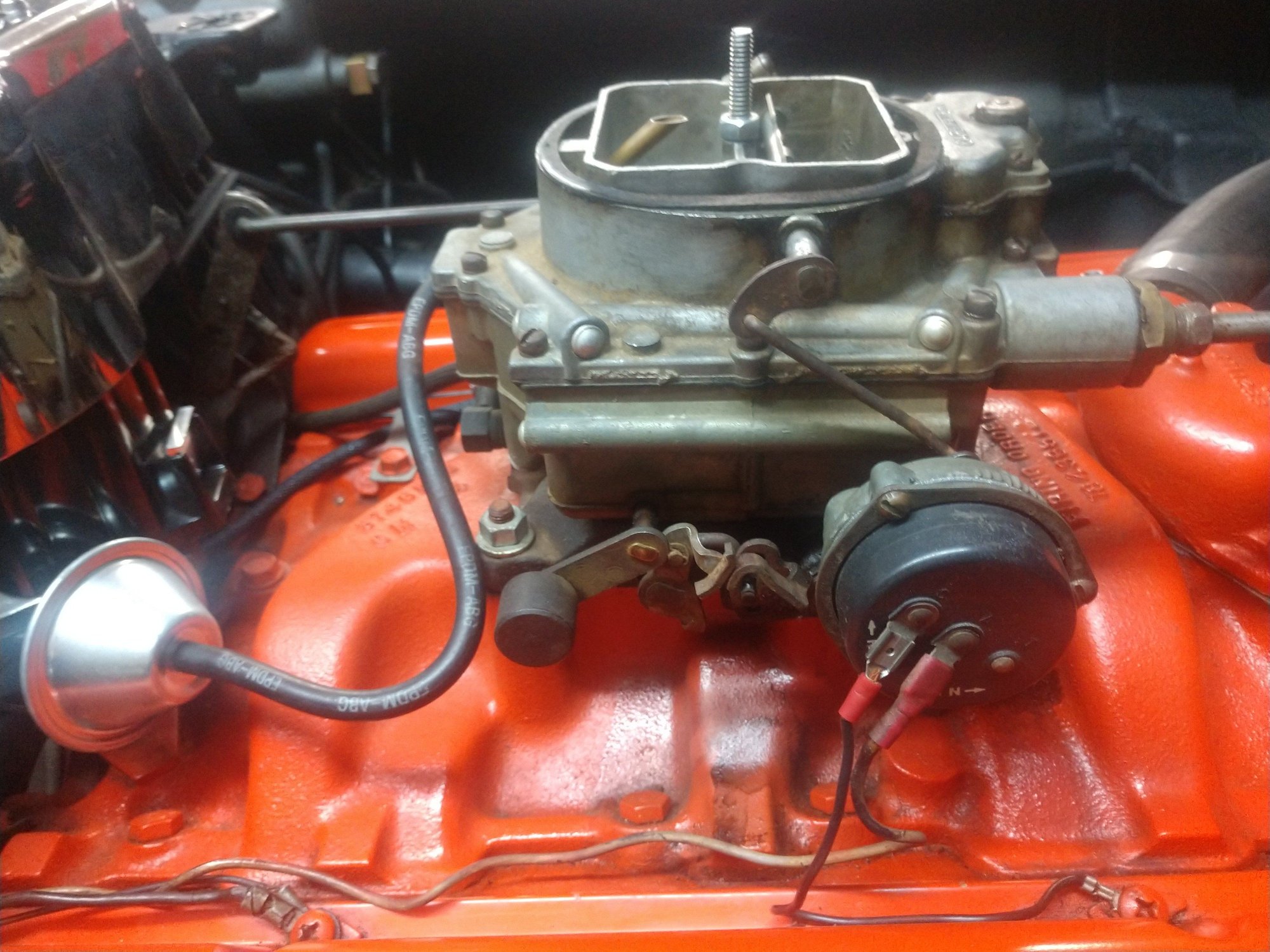

I don't like 12 V wires, running around the engine and always having power on them, even when the engine is not running. I also don't like that if the switch is turned on for some reason, the choke heats up and starts off before the temperature of the carburetor does. I want the choke to go off when the engine warms up, not when the choke element warms up. The original look is also a factor for me.

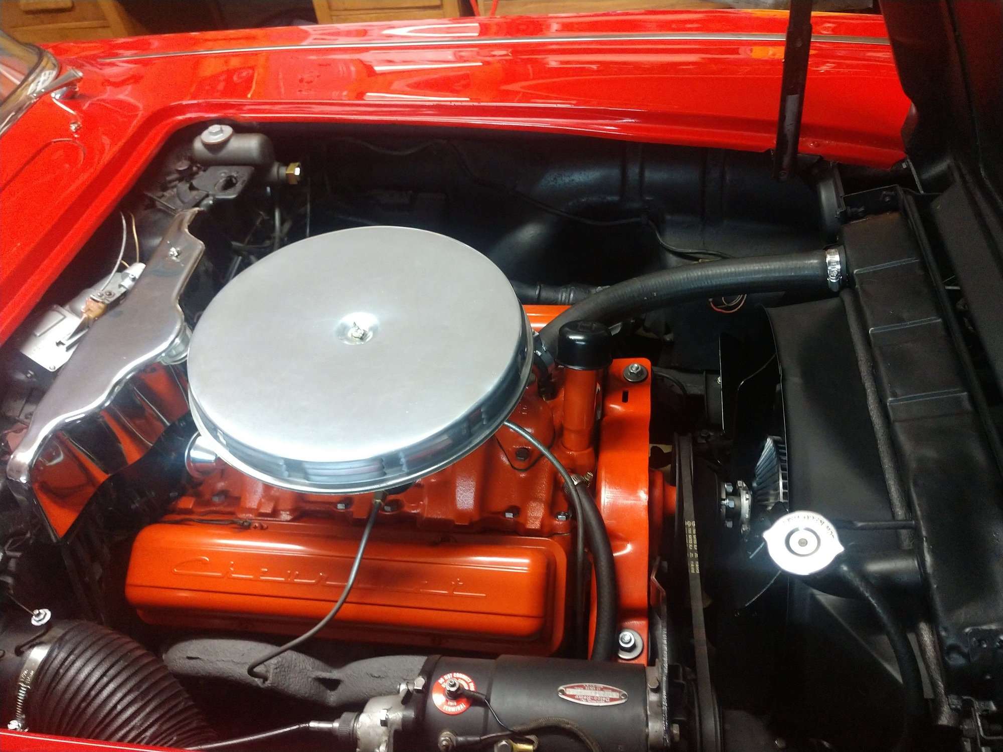

Soon after I bought it:
After changing the choke:
Final after engine clean up:
