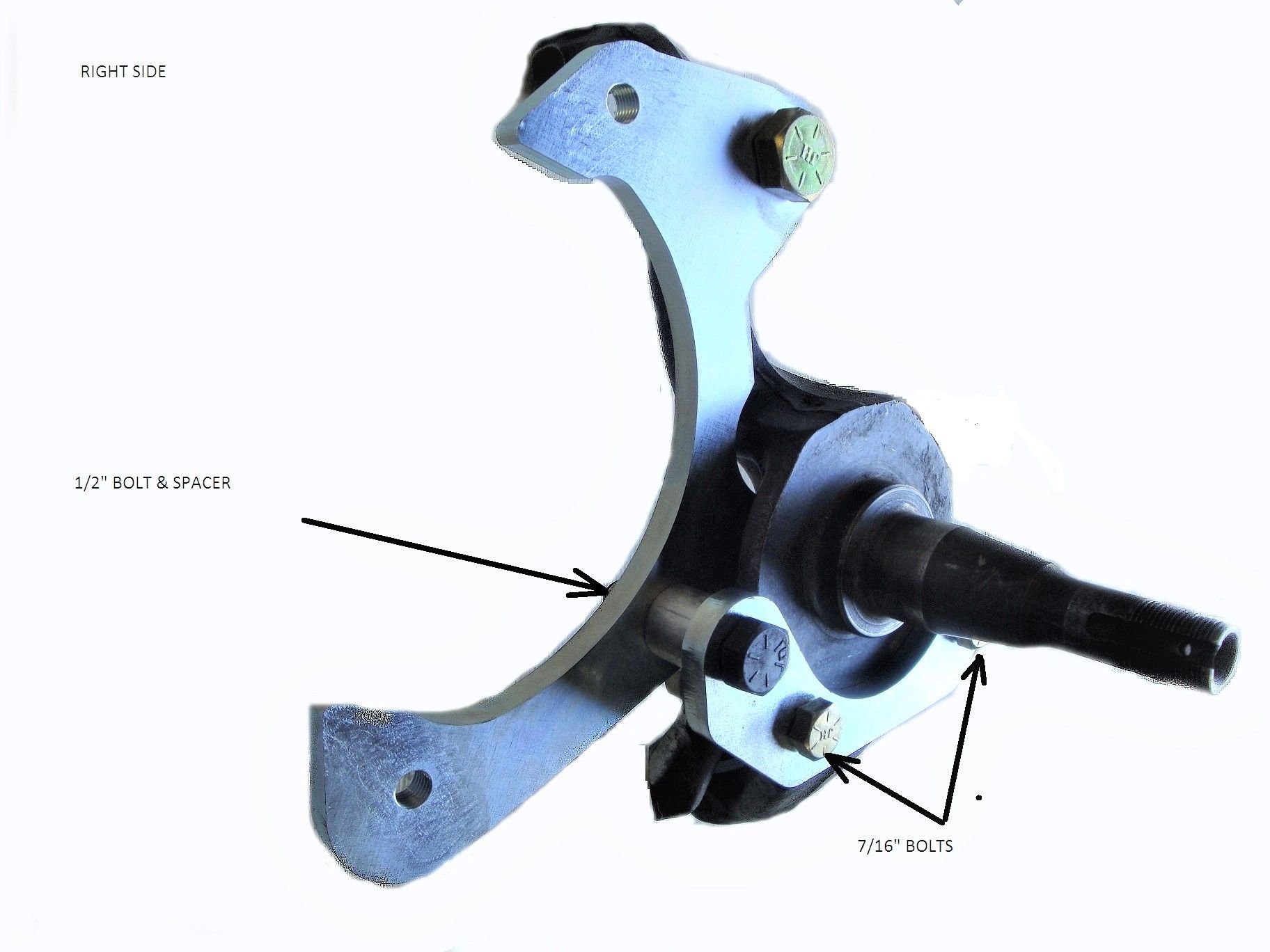

I thought swapping 65 and up on 63/64 drum cars moved the tire out some? There is a 'zero offset " kit that uses a new hub, an 11" 79-81 trans Am 11" rear rotors and a GM D 52 single piston caliper.ZERO OFFSET
INSTALL SEAL AFTER PACKING INNER BEARING. INSTALL SEAL WITH CLOSED(METAL) SIDE FACING YOU. I’VE FOUND USING A SHORT 2X4 (6 TO 9 INCHES LONG)SET ON TOP OF SEAL AND POUND IN WITH HEAVY HAMMER—BE CAREFUL TO INSERT EVENLY AND DO NOT DISTORT SEAL. INSERT FULLY-SEAL WILL PROTRUDE OUT SLIGHTLY (APPROX .050”) FROM HUB WHEN FULLY INSTALLED.
WHEN HUB IS INSTALLED ON SPINDLE THE SEAL WILL BE VERY CLOSE TO SPINDLE BUT DOES NOT TOUCH IT, THERE IS ABOUT 30-40 THOUSANDS CLEARANCE BETWEEN SEAL AND SPINDLE.
ROTORS #5560 1979-81 PONTIAC TRANS AM REAR
CALIPERS 1969-72 CHEVELLE
BEARINGS LM67048 INNER LM11949 OUTER
DUST CAP DORMAN 618-102
SEAL 473454
BRAKE HOSE 1969 CAMARO or 1973 BEL AIR
BRACKETS MGCHEVY
HUBS MGCHEVY
