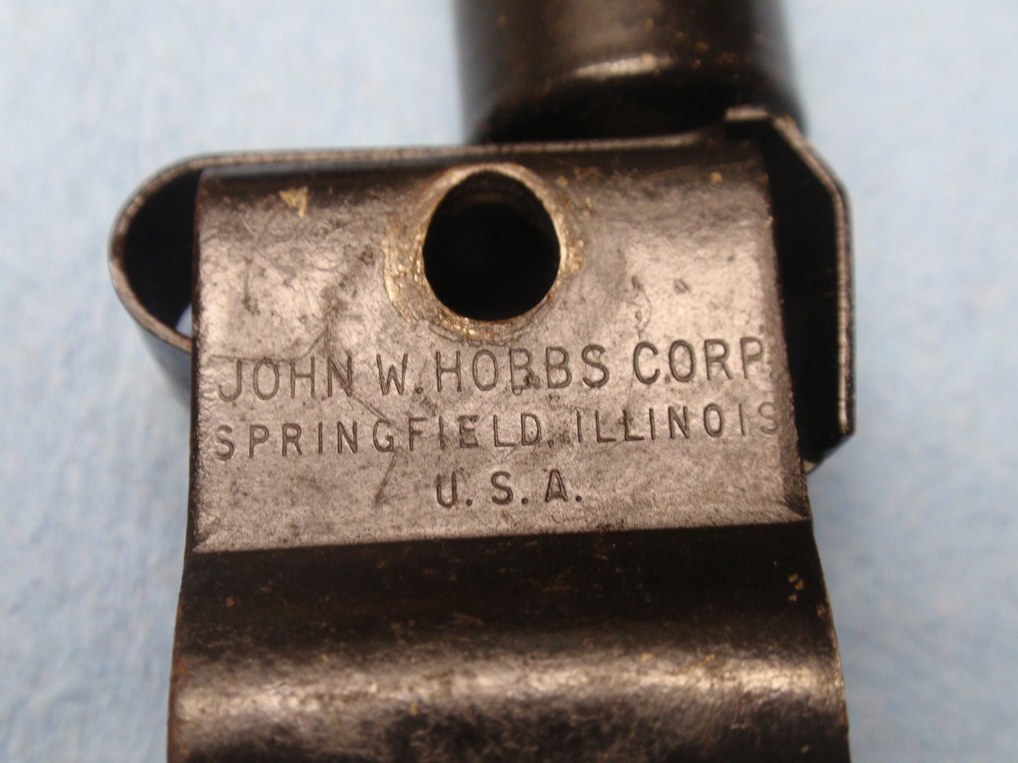

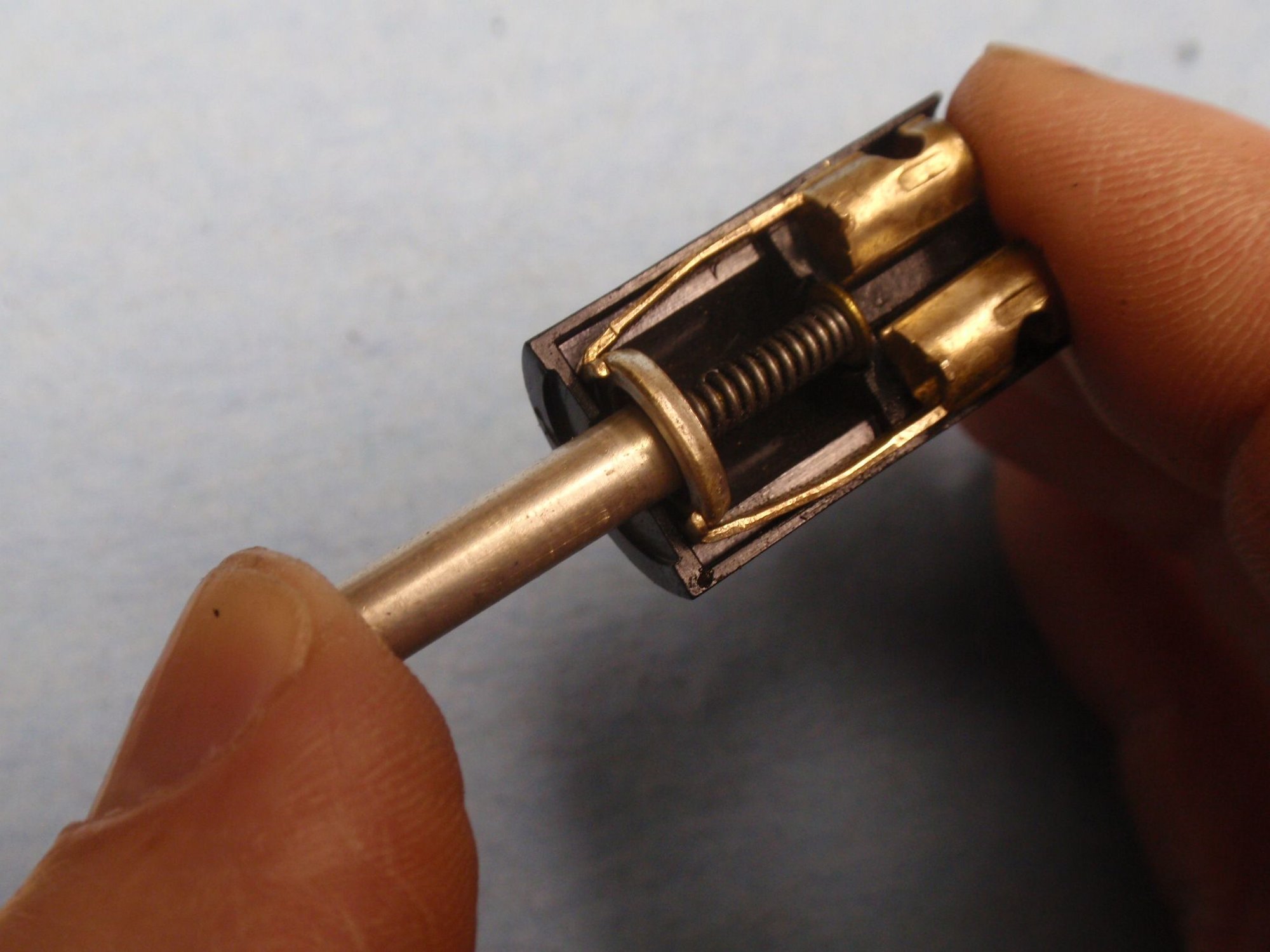

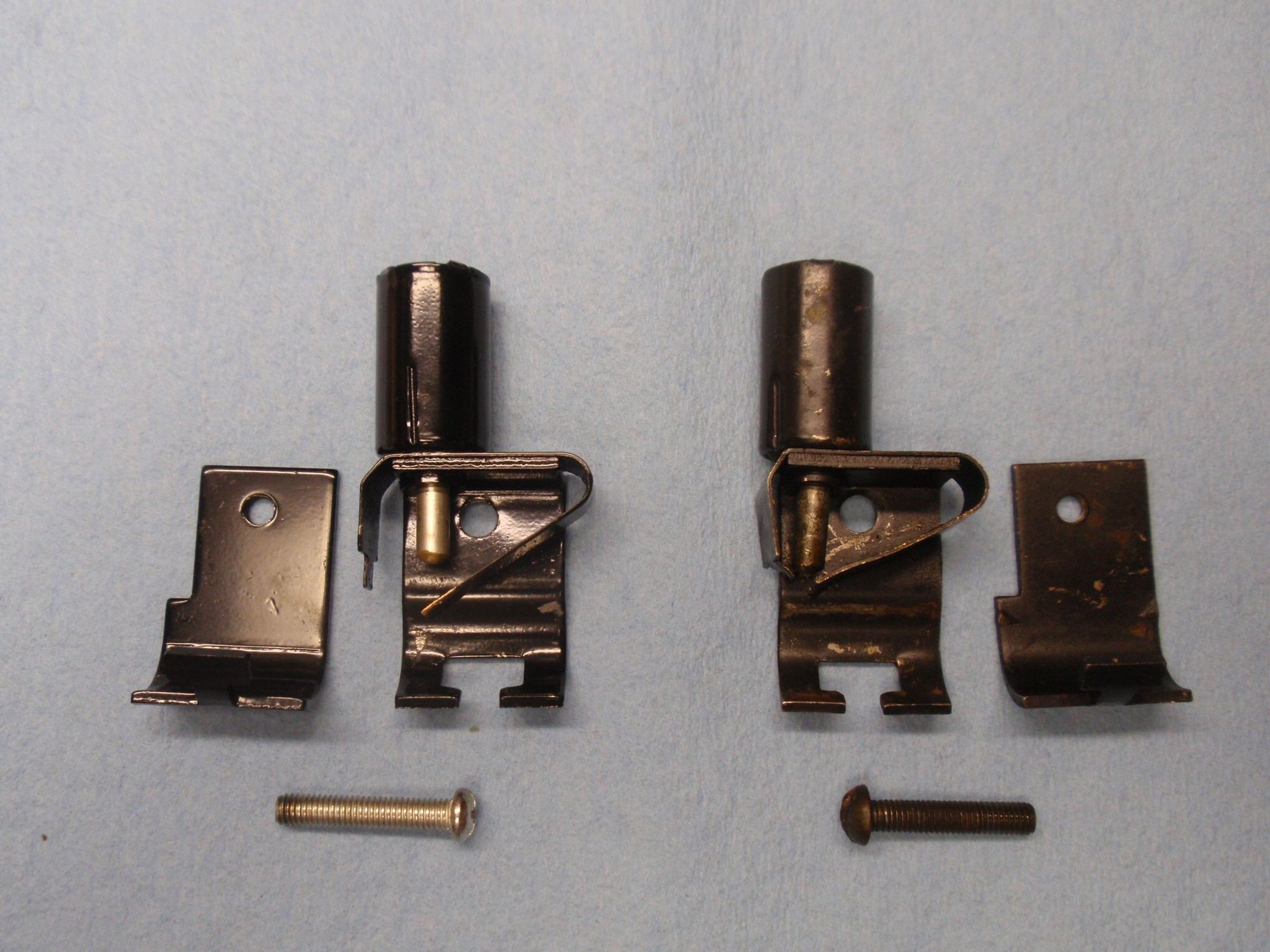

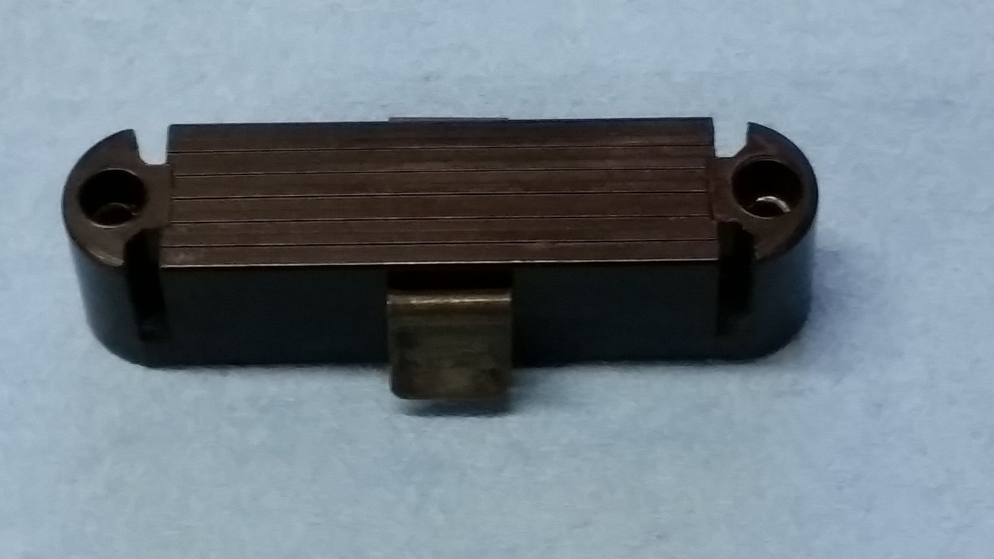

I rebuilt the original in my 58. It wasn't too bad. Got it opened, cleaned out the gunk, closed it back up and it worked fine.
I did an article for our chapter newsletter years ago comparing an original to a reproduction I can't find the article but here are some of the pictures.
I
