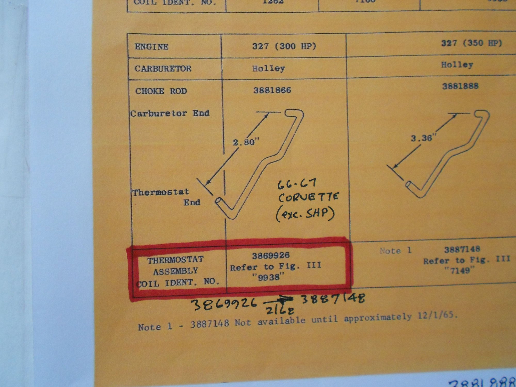

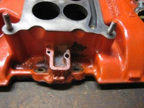

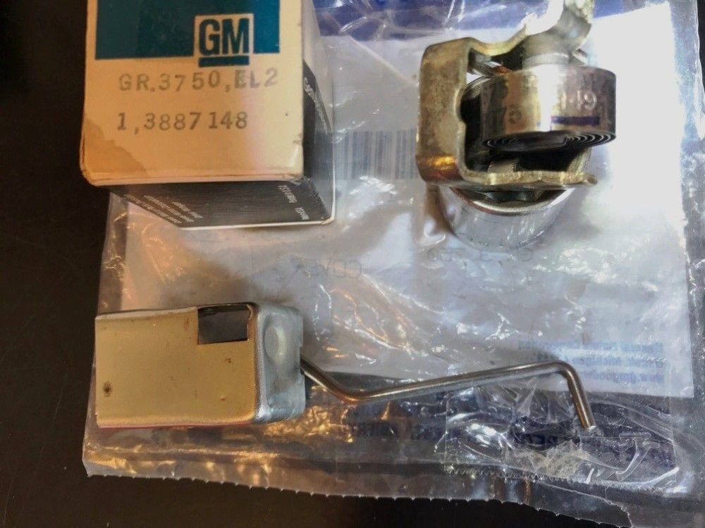

Blackvette
'66 300HP should have intake manifold 3872783; cast iron with a pocket cast on passenger side to house the divorced choke components. Is this how your car is equipped?
The divorced choke consists of bimetal spring #3887148 - it is lightly/faintly stamped '7149' on the outermost coil. The correct choke rod is 3881866, unmarked but ~2.80" c/center (not developed) length. There's a choke cover, Zn or cad plated, attached by small machine screw into manifold.
With a cold engine, the bimetal spring pushes UPWARD, CLOSING the choke plate. With warm engine, the spring, the spring pulls DOWNWARD, opening the choke plate.
* There is NO choke adjustment procedure found in an AIM.
* The choke adjustment procedures found in 1966 ST72 Chassis Service manual are INCORRECT. Here's correct steps, pictured below. You must insure that you have proper bimetal spring coil as Quadrajet & Rochester appear similar, but work in opposite direction. Pay attention to the part numbers & try to find real GM spring. Hope this helps.

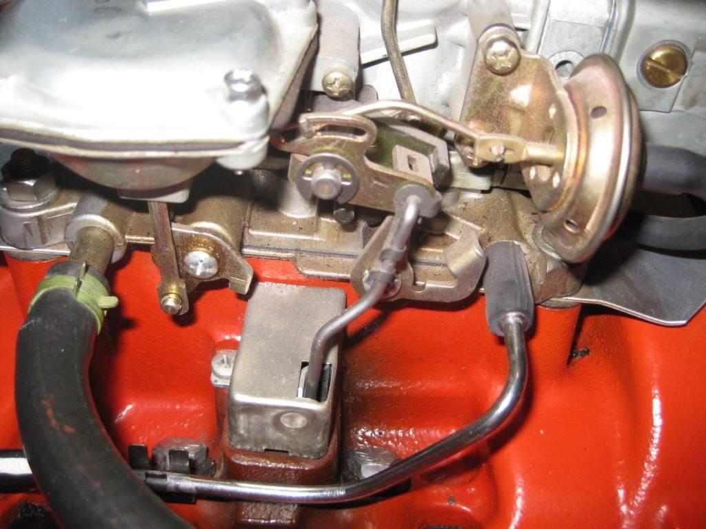

You got some good information from the above posts. Of all the systems on our cars this seems to be one with a large learning car. Once you got it, you got it though. Your right Holley tech department "ain't what it use to be."
I don't worry so much about the exactness of the choke butterfly distance around the primary air horn. If its close its good enough for me. Check the choke pull off works when you get manifold vacuum. (Thats the circular diaphragm in the picture of post 3) If that works the next mystery is how you set the fast idle. From the same picture in post 3 that shows the choke diaphragm, to the left of that is a lever arm with a slot in it. That slot is for a screwdriver that you twist depending on if you want the fast idle faster or slower. when you twist the slot it slightly changes the location on the plastic fast idle cam. This is set when the engine is cold and you push the accelerator to the floor. Once you play around with it, you will get the idea. Problem is you only get to play with it when the engine is cold as once the engine is hot the bi-metal spring springs goes into action and starts working against you. I hope I did not confuse you, but this is my understanding of the system. The service manual instructions are clear as mud until you understand the system, then they make sense. I believe the overhaul manual may go into a little more detail on the choke. Good luck. Mark
PS: Be careful of the fast idle speeds in the service manual. In my opinion they are to high. If I remember correctly the book called for 2200 RPM for my application. I did that once. I set my fast idle at around a comfortable 1500 RPM. Also I think there is a paper on this system that John Z published. Cheers.
