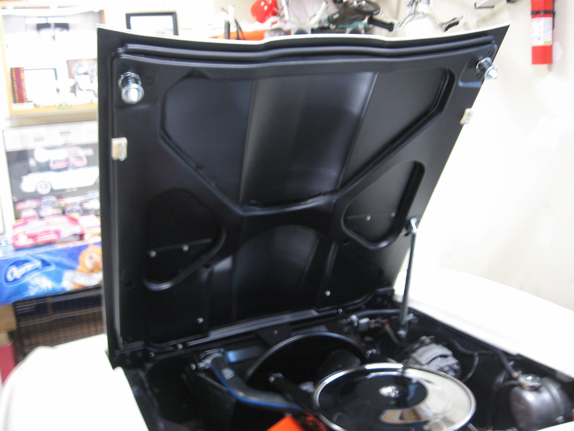

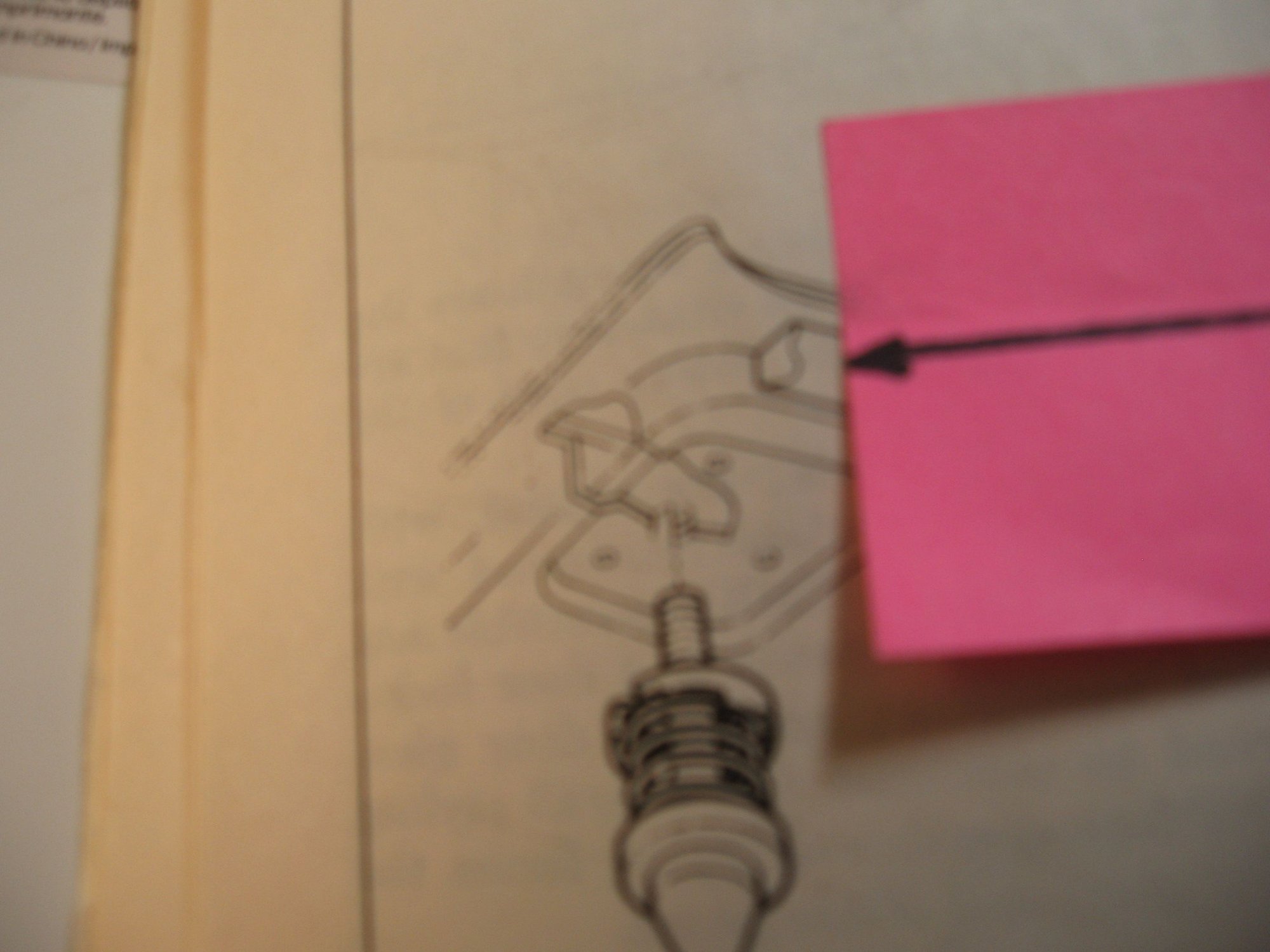

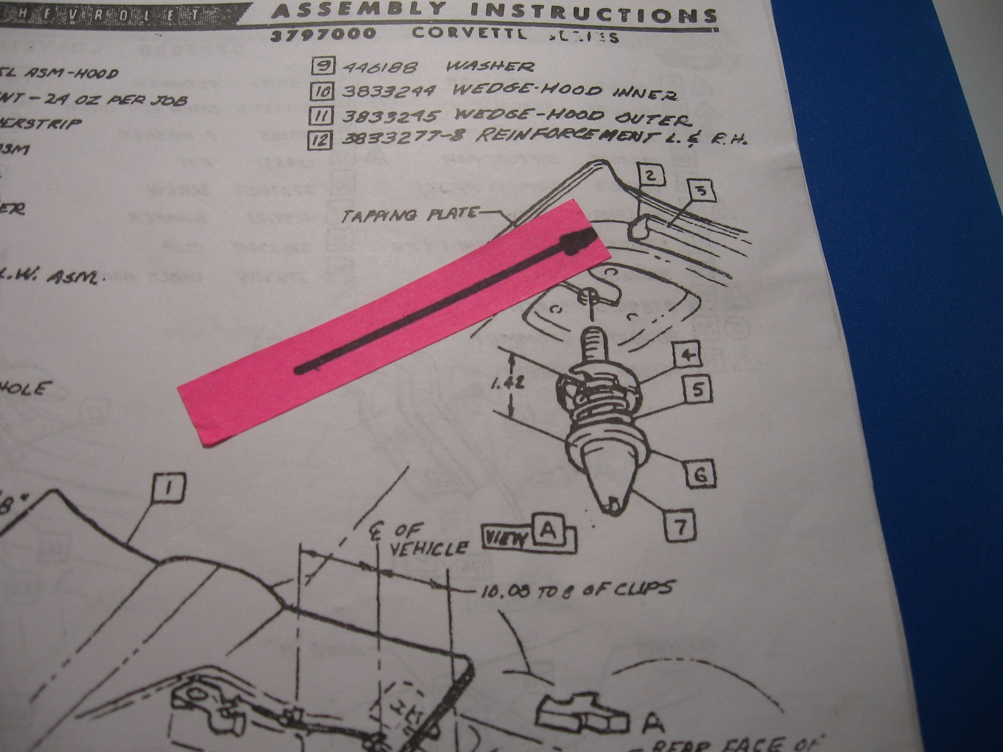

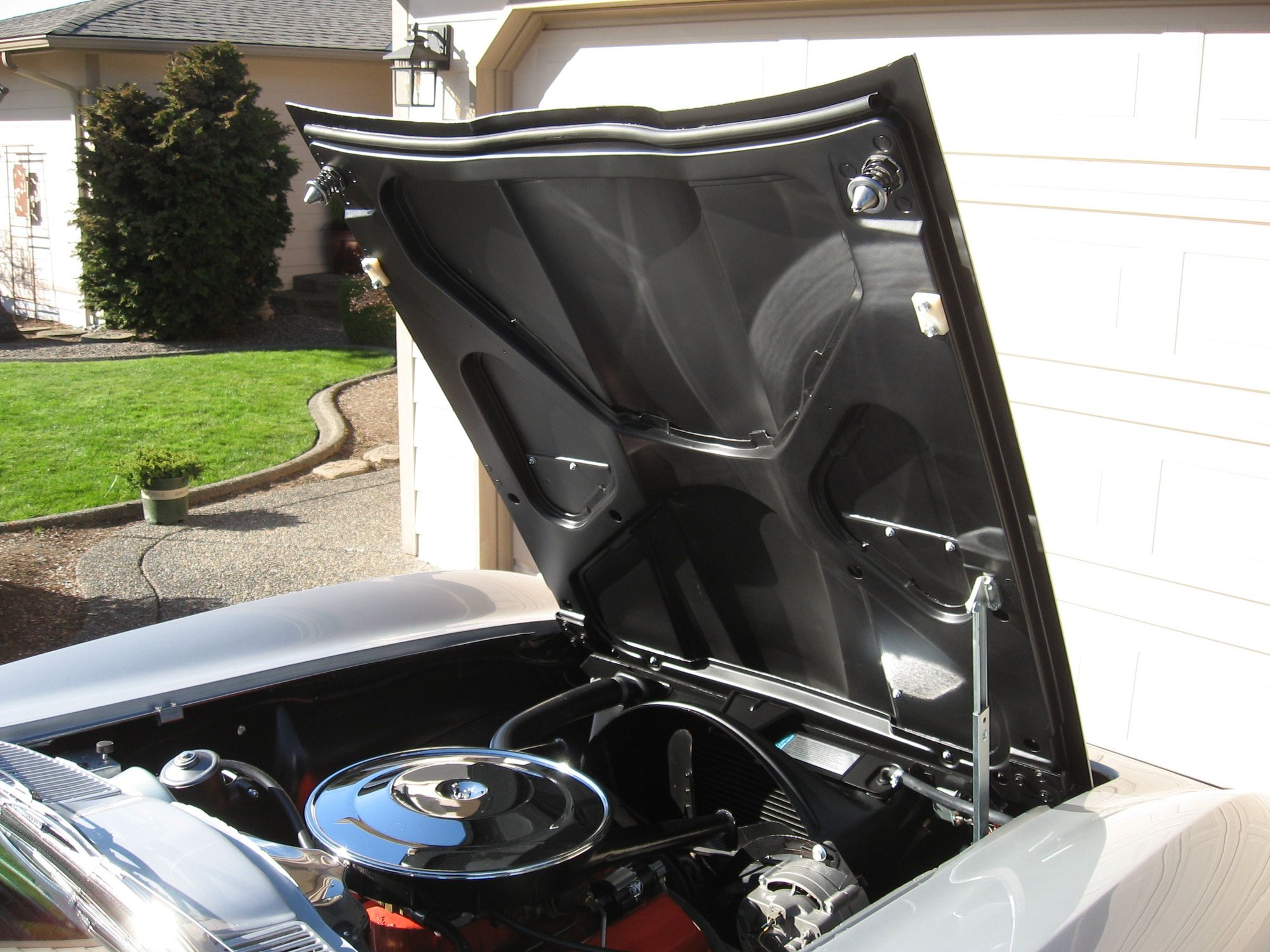

Your research is dead WRONG. All '63 hood rubber (and maybe '64) extend along backside and stop at each corner NOT curving around hood.
1st pic - '63 shop manual
2nd pic - '63 AIM
3rd pic - Nolan Adams Vol 2
4th pic - My '63 NCRS Topflight
Make as factory and problem solved unless a different issue. begee22
